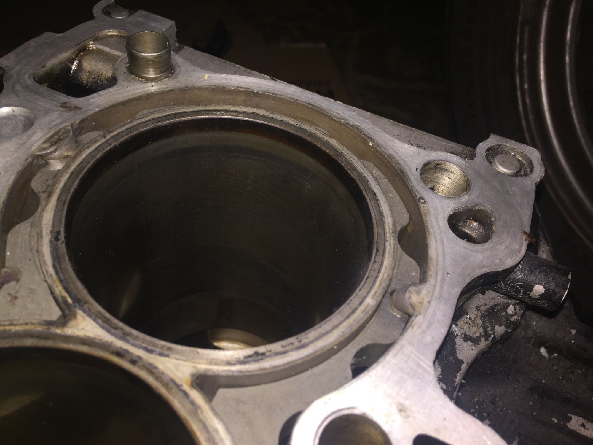

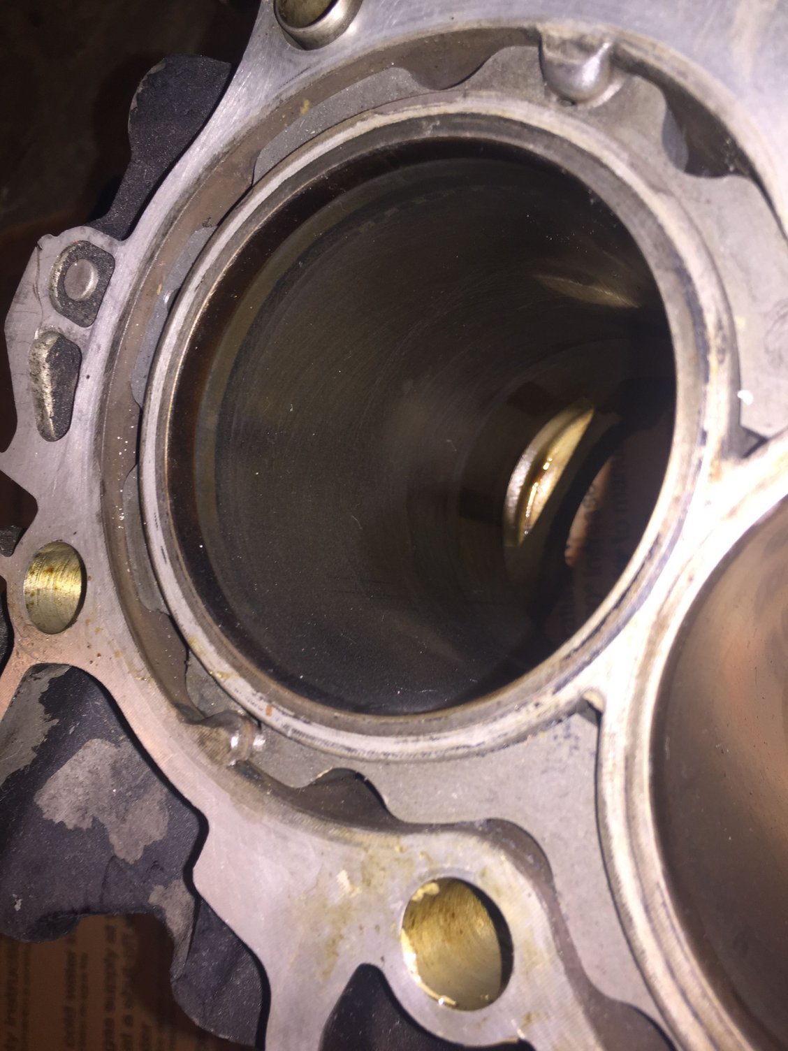

hi guys so i did a lot of googling and its better to not have one.
but ive never heard of this
story:
i bought a bare gsr block w/ caps and girtle and crank
came with a WELDED ON block guard(idk brand)
build:
b16 head
b18c1 block
b18c1 crank
p73 81.5mm pistons
basic all motor build with a 80-100(if 100 is applicable) shot of nitrous
its already welded on, is it safe to just run it? (i will be overboring its stock 81.00-81.25 the guy b4 me honed it before but didnt bore it)

After spending some time looking at it, that actually IS an older block guard in your pics. My bad.
I don't know how comfortable I'd be running that personally.
This is what it should look like.
The older style like that actually is the kind that allegedly caused overheating issues. I've never personally seen it, but we're talking late 90s, or very early 2000s, so that's even before my time.

all i could find was "add"
i googled, found "add w1 block guard" on ebay
also one side looks slightly lower than other side
safe to assume i shouldnt run it?
i want the motor im building to last 30k-50k+ (hopefully 50k+)
as oem b series motor can last up to 200k
KiNGDEE206 is offline

I'll let someone else chime in, but that looks sketchy to me too.
Are you going to do an align hone and bore the cylinders? If so, then I guess there's not too much to worry about, the cutouts on it seem larger than I first thought. I don't think it'll have any coolant issues if that's your concern.

it definitely looks old, but it looks fine to me.
only thing I'd say is before running it, make sure to get the block shaved bare minimum for straightness, which should hopefully only be 0.001"-0.002". that'll ensure straightness and a fresh sealing surface everywhere, as it looks a bit beat up in some areas currently.
