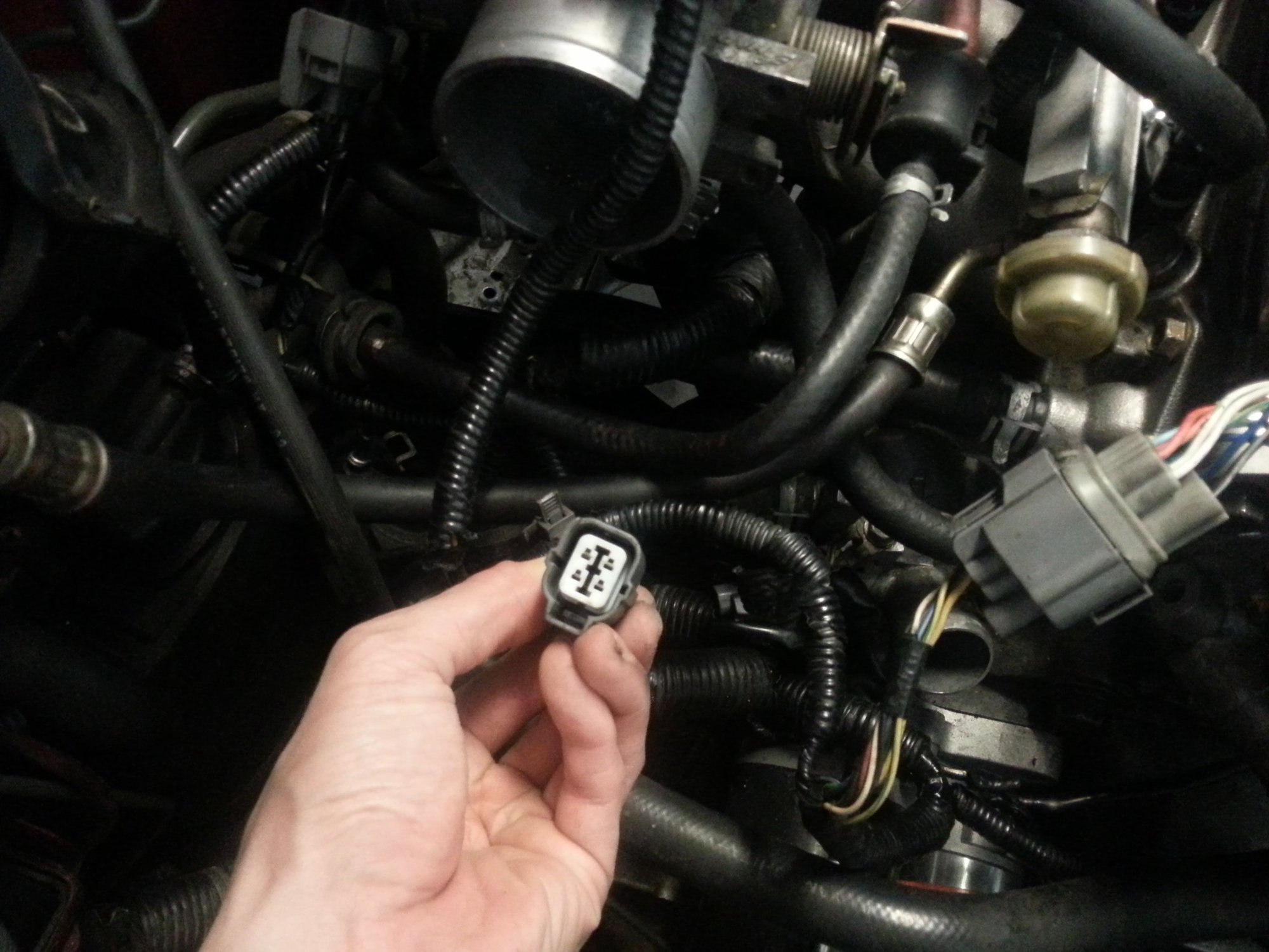

*****Nevermind this picture. I know where this plug supposed to be plugging into.

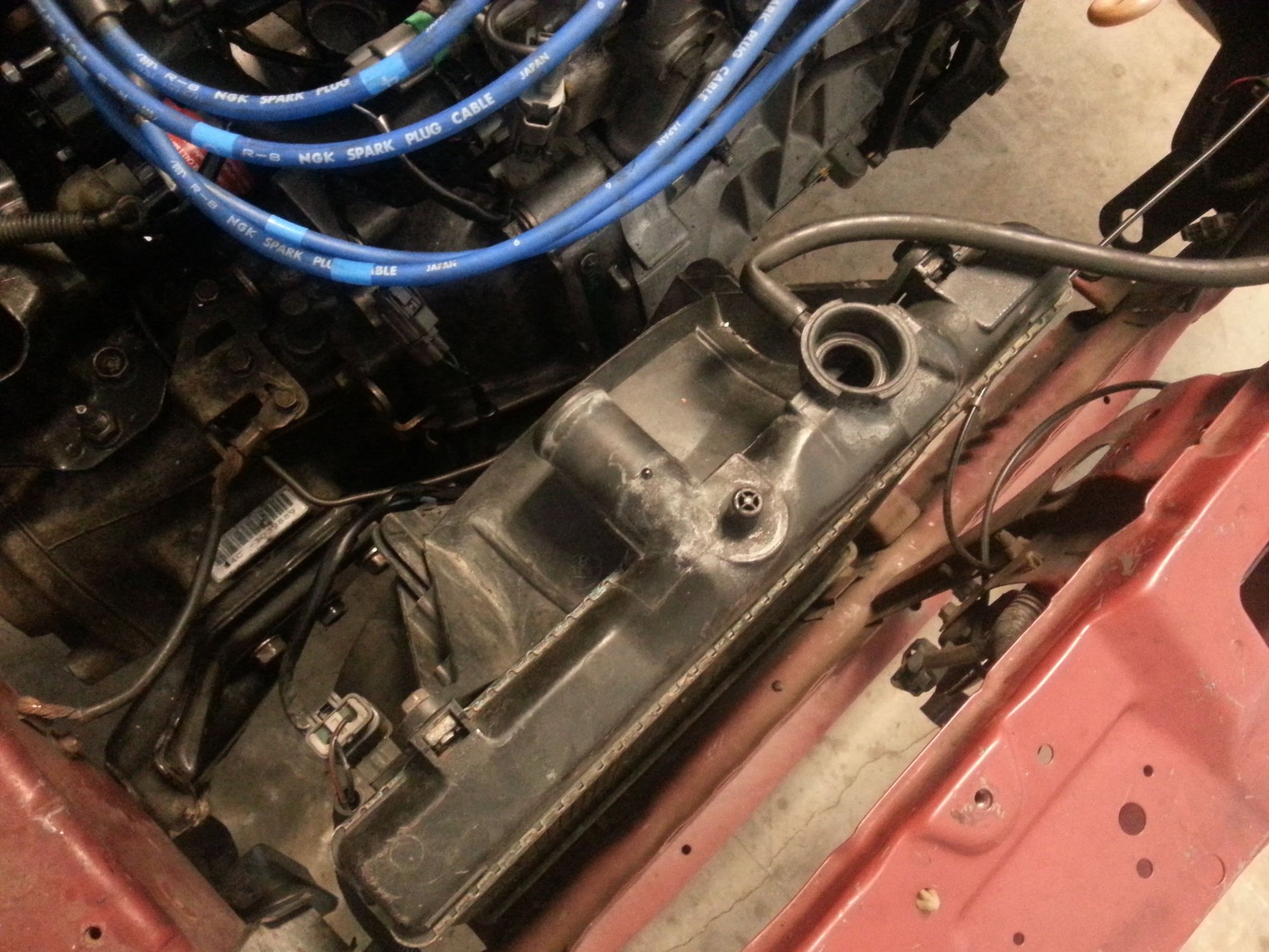

I had just about everything hooked up except for the radiator hoses and the radiator itself. Could this be the problem why it won't fire over?

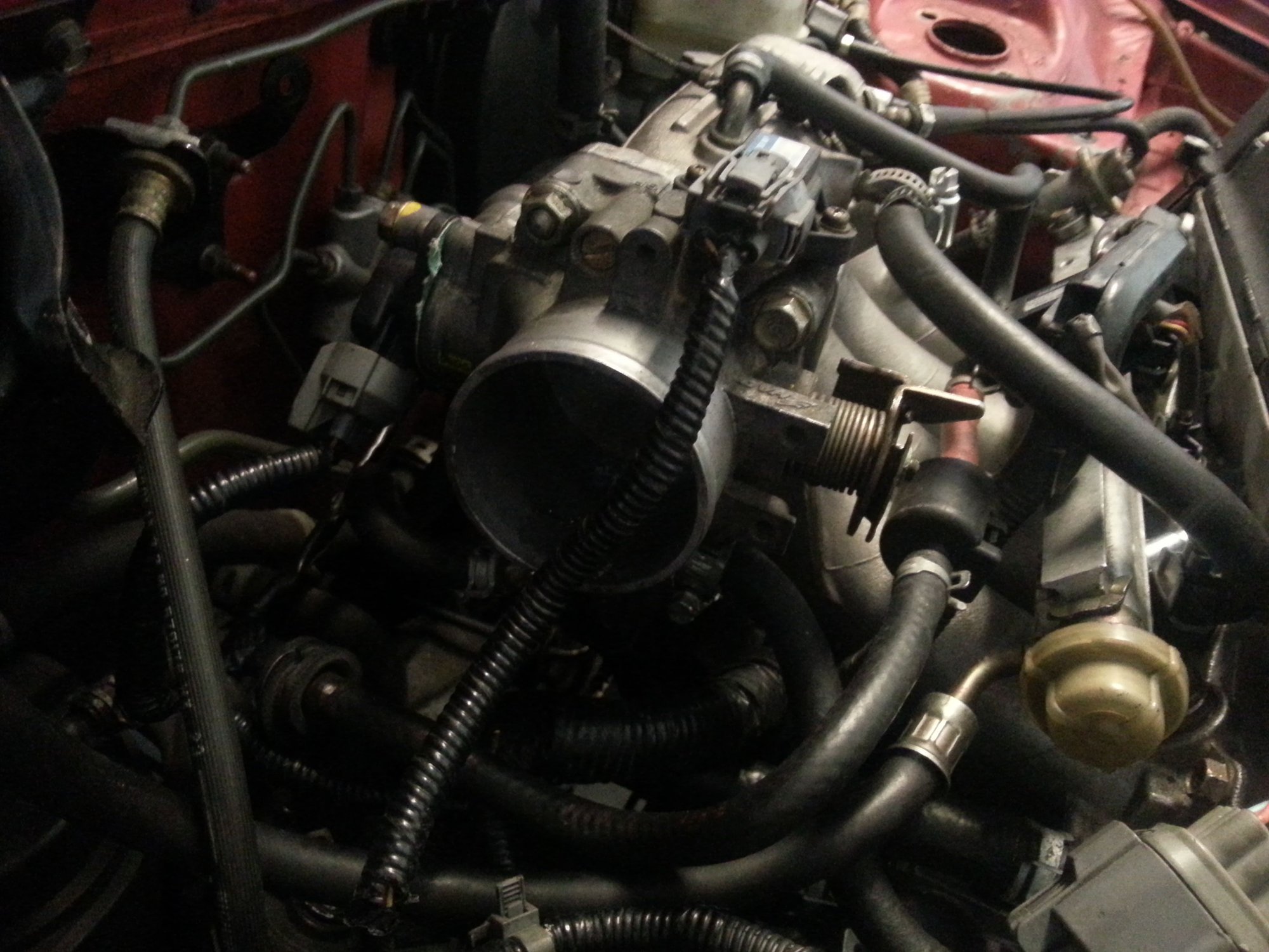

Here's a shot of the dizzy, wires and the location where they went to. Seems about right, right??

Looks like your fuel injector plugs are installed backwards. The order would be (beginning at the cam gear end) brown, red, blue and then yellow. This refers to the signal ground wire color at each fuel injector clip... the other wire at all four positions is a yellow/black 12v+ source to energize the injector when the ECU sends the ground to do so.

Of course it matters... fuel must be injected at just the right time or it doesn't go into the combustion chamber. Also, you may not be getting fuel to the injectors at all. You have a fuel dampener on the inlet side of the fuel rail... you need to make sure that the fuel feed line and the sealing washer match this design.

I also would not recommend starting it without coolant.
I honestly do not know how long the cylinders can keep cool without coolant in the water jacket when it fires up. I don't know if you have 10 seconds or 2 minutes before warping happens from hot spots due to dry jacket running.
