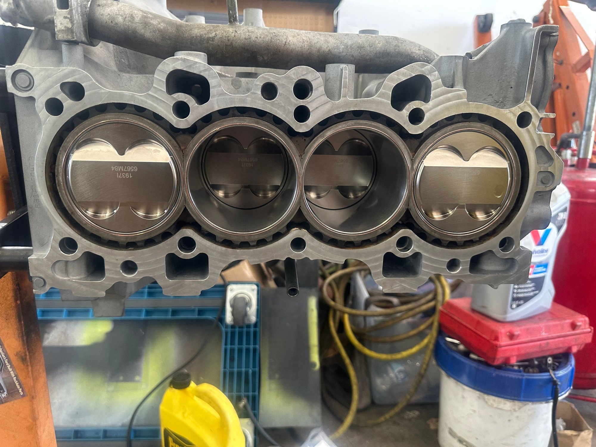

-darton sleeved and O-ringed gsr block

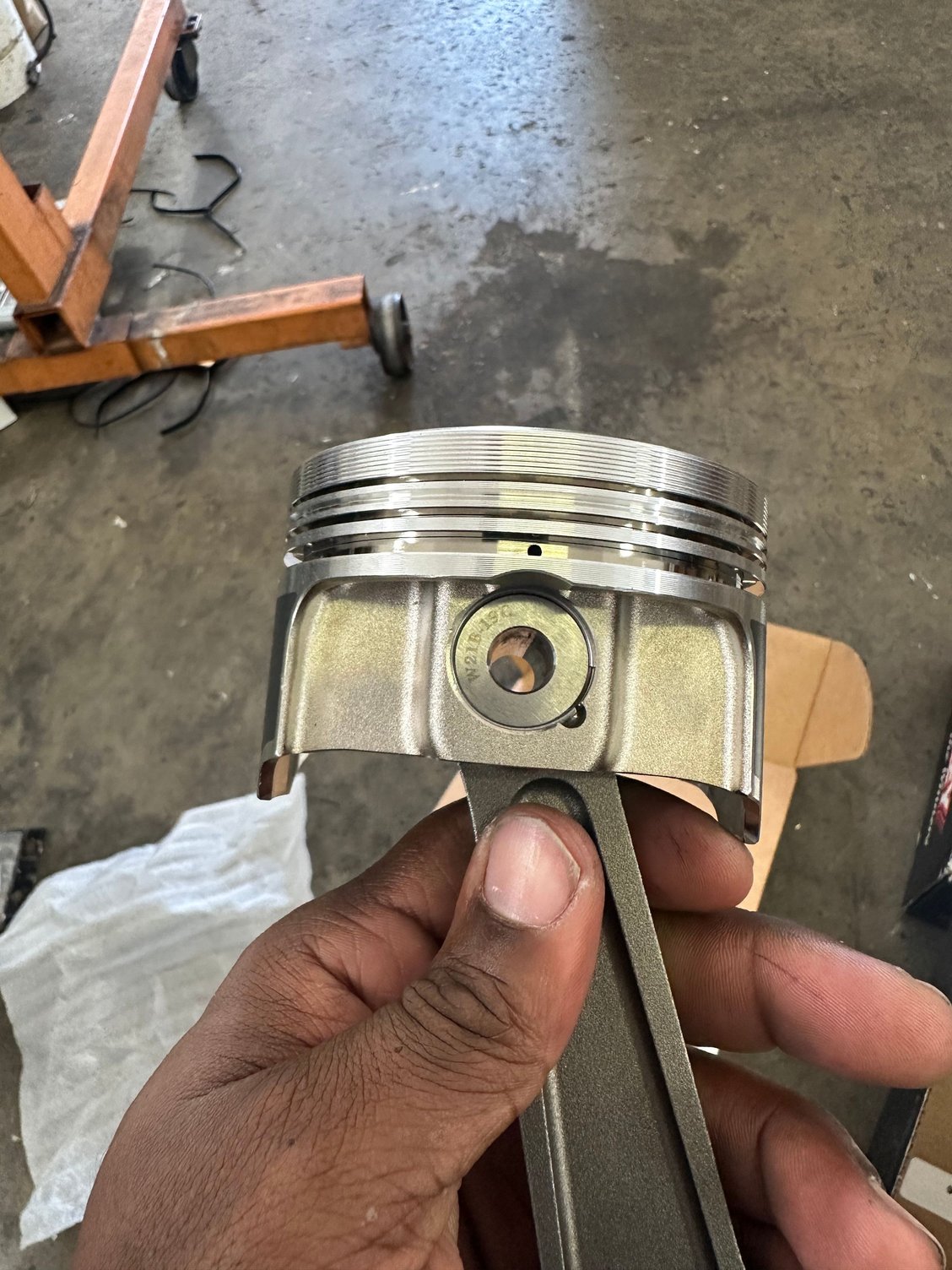

-weisco 84mm pistons with upgraded wrist pins

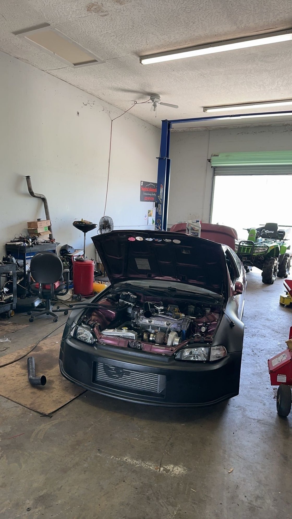

There is still a lot of work i need to do to the chassis, i plan on getting a cage and a parachute as soon as its running. there is already a running swap in the car that i am taking out to put this swap in. ill try to remember to add pictures as i go. i plan to track the car and drive on the street every now and then
Current update 5/25/25
The bottom end is assembled and ready, next step is to pull the current motor out of the car and put the new one in.
