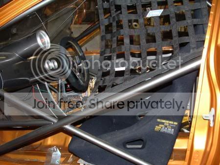

i had some pics to share

On my cage the bottom mount is on top of the bar using 2 tabs and the top mount on the inside with a seatbelt buckle as a means of attachment.

mine is basically a tube through the net and welded under the bar if that makes sense.

<TABLE WIDTH="90%" CELLSPACING=0 CELLPADDING=0 ALIGN=CENTER><TR><TD>Quote, originally posted by redboost10 &raquo;</TD></TR><TR><TD CLASS="quote">i had some pics to share
</TD></TR></TABLE>is that really a piece butt welded on your main hoop right above the door bar or is that just some slim padding?????????
Old Jul 16, 2008 | 04:31 PM
redboost10's Avatar
Posts: 7,056
Default Re: (AllmotorEH2)
haha, thats padding. i see where your coming from though

mine is like Mikeys but on the top of the tube.
a small version of this tab would work fine. the size bolt in there i belive is a 10-32. (holding the lower window net tube to the tab/cage)
