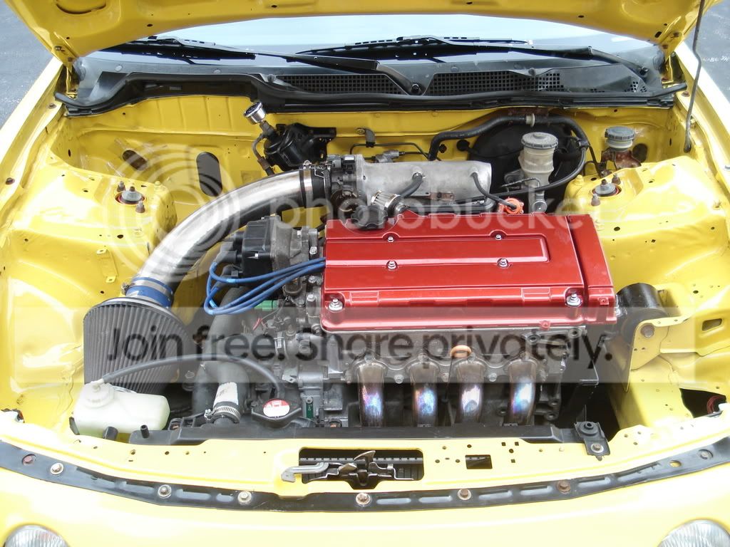

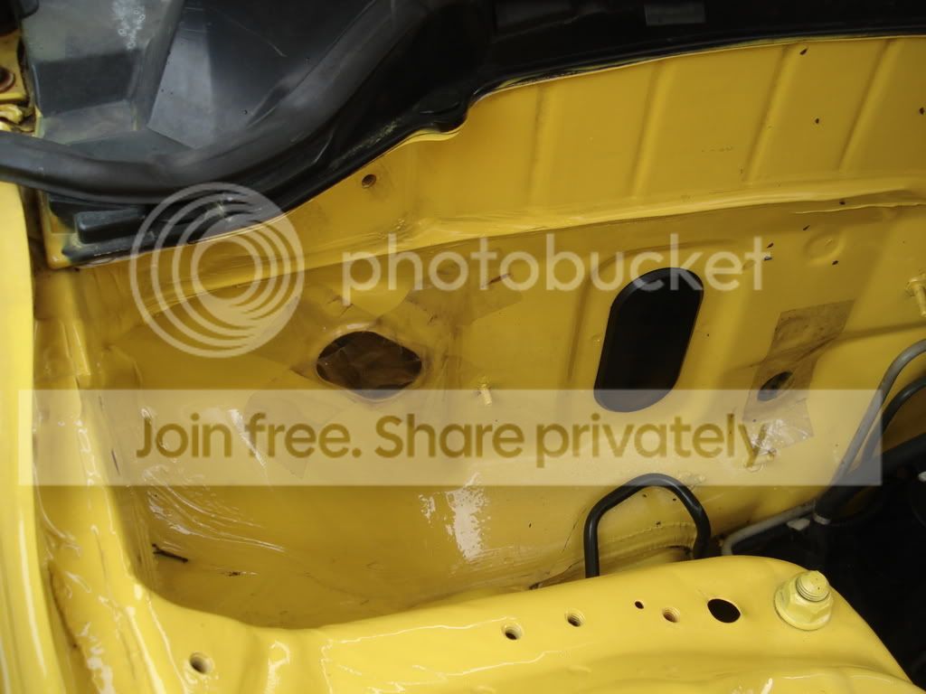

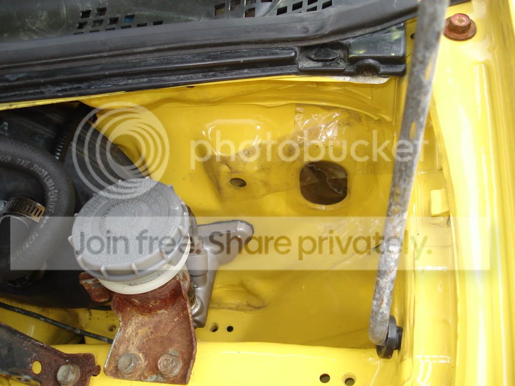

i looked at the 2008 rules and most of them are just revisions/stuff that wouldn't matter to me i.e. roll cages and fuel. i'll be super happy if my integra gets into the 13's. but i don't have any covers to where all my wireing use to be.
the tape is temporary just to help keep water out when it rains.
so what do you think? will i pass tech inspections?

Depending on the track and tech you may or may not. All holes in the firwall must be sealed though, I believe in case of a fire. I know at Atco they made one of the VW guys cover his holes before they would pass him. He was there cutting out sheet metal and screwing it in to pass tech. I would just cover them to be safe and save yourself the time and headache of not passing tech.

Honda sells OEM rubber plugs for both those holes. If you do a search in the appearance, cosmetic forum under tucked, shaved, molded engine bays it has the part #s for the wirewall plugs. They are pretty cheap. Hope this helps.

I wouldn't want to run the car, without the holes covered. Fire likes air, and you car is full of it. The fire will take the shortest path to get to the air inside your cabin ie: the holes. Find someone local that can weld or at least seam seal some patches over those holes before they become flame throwers in the case of a fire under the hood (Yes I do realize that it's unlikely)
