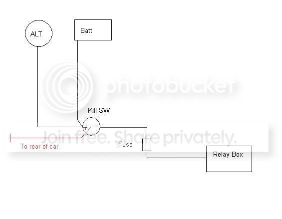

Plain and simple because you refuse to search....
No matter what you do, you need to kill the alt and battery in one switch.
About as basic as it gets....
<TABLE WIDTH="90%" CELLSPACING=0 CELLPADDING=0 ALIGN=CENTER><TR><TD>Quote, originally posted by tepid1 »</TD></TR><TR><TD CLASS="quote">Plain and simple because you refuse to search....
im not normally such a ******* noob... i was "searching" and only finding a couple threads.. but when i just started LOOKING i saw there were a ton of threads.. so my appologies.. since you appear to know what the expletive you are talking about i hope you will answer this as well... is the "relay box" the under hood fuse box? and i see you have the terminals on the switch marked + and - theres not really a ground on a 2 terminal switch? or at least on mine i dont think there is...
so to understand better.. you are saying battery and alt on one side and the oem fuse box on the other with an inline fuse... lastly what type of fuse am i putting in there? and minimum size wire? i really dont want any bigger than 4... but i will use whatever i have to.. battery is still in stock position and killswitch is in dash.. thanks again for the help it is appreciated
</TD></TR></TABLE>im not normally such a ******* noob... i was "searching" and only finding a couple threads.. but when i just started LOOKING i saw there were a ton of threads.. so my appologies.. since you appear to know what the expletive you are talking about i hope you will answer this as well... is the "relay box" the under hood fuse box? and i see you have the terminals on the switch marked + and - theres not really a ground on a 2 terminal switch? or at least on mine i dont think there is...

First off, the fuse is not necessary if you are using the stock relay box under the hood. There is already a 100amp fuse in there.
Second, if you use a distribution block under the hood you can tap your starter from that instead of the relay box.... if you do this then you need to fuse the lines from the distribution block.
Understand?
Understand?
<TABLE WIDTH="90%" CELLSPACING=0 CELLPADDING=0 ALIGN=CENTER><TR><TD>Quote, originally posted by tepid1 »</TD></TR><TR><TD CLASS="quote">First off, the fuse is not necessary if you are using the stock relay box under the hood. There is already a 100amp fuse in there.
ok there are 2 wires that go to the positive terminal.. one is to the underhood fuse box and the other is to something else im assuming its to the starter? my concern was putting a fuse in between the positive terminal and the first terminal on the switch in case anything happened the fuse would go..
Understand?</TD></TR></TABLE>
kind of.. but i gues the ONLY part im confused on is i think i HAVE to use a distibution block.. and as far as i can tell im literally going wire from switch back to the two wires that used to be attached to the positive terminal.. sorry im not normally this dense...
maybe if i knew for sure what the two wires on that terminal were id understand better.. i know one goes to the fuse box because i can see that.. but i am not sure where the other goes.. im assuming the starter?
