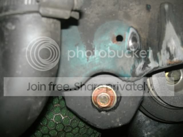

Default Re: (raceACCORDingly)
<TABLE WIDTH="90%" CELLSPACING=0 CELLPADDING=0 ALIGN=CENTER><TR><TD>Quote, originally posted by raceACCORDingly &raquo;</TD></TR><TR><TD CLASS="quote">homemade...
Very nice job, What did you use to fill it?

i used liquid urethane from mcmaster.com you can chose from 60a, 80a, or 94a shore (stiffness).
the p/n is 8644K18
