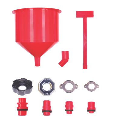

Buy one of these spill free funnels from Matco best thing ever for coolant services

I'm using one of those. The water is actually spilling out the top of it.
