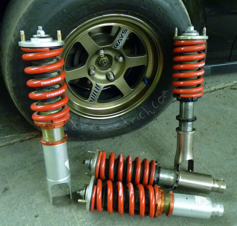

I have two sets of omni drags and they are very different, any incite on this? I'm concerned with the smaller rear shock body on the black set.
Springs are both 18k/12k, one set has skunk2 18k rears instead of omni springs, they actually look thicker [black set]

do you have 2 whole sets, or 2 different batch half set's that make a whole? if you have to complete sets ie" 8 total sruts, then keep each batch together. I am sure over the years omni power may have used different manufacturers for his products.... the only issue I could see is the valving be a slight bit different since the actualy shock body is physically different, unless the internal size and valving is identical. Probaly only omni man knows that on here....

I have 8 shocks total, 2 different complete sets, I just used these for pictures.
I just wonder which I should use.

From what I understand.... the larger bodied assembly is the preferred setup. Valving is better for the aggressive spring rates and rebound has been tuned better from the earlier versions.
The diameter of the shaft is bigger on the newer ones meaning it's stronger. It's best to use the big shaft with heavy springs.

Thanks for the excellent info Tepid!
I think they will both work out fine but Ill use the bigger ones on my black car. One of these sets were pulled off a 1.54 sixty foot car and other set pulled off a 9 sec car so I think we are good.
I tuned a local car on the blox's, makes 18psi on the line and hooks 21 psi in first on a piston rod 35r gsr. Sold me on the drag suspension as I have never been able to put down anything more than wastegate boost in 1st at the track.

def go with the newer style, the old ones tend to blow out easily

btw, you shouldn't use stock honda ball seat lugnuts with aftermaket wheels

Interesting, we've done this for years, our open ended lug nuts for extended studs seem to have the same tapered pitch/bevel as the lugs pictured, what should we use?

Mine were the newer larger design.
