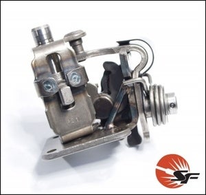

a bent interlock? Its hard to tell by looking at it.
See p21? thats the interlock Speed factory beefed it up..
