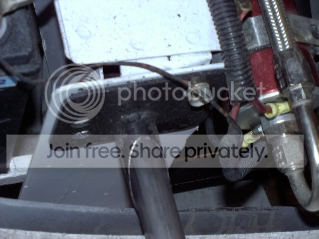

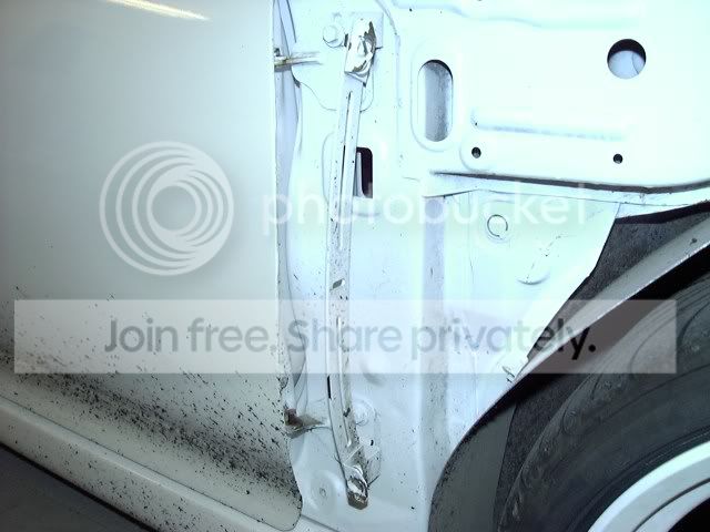

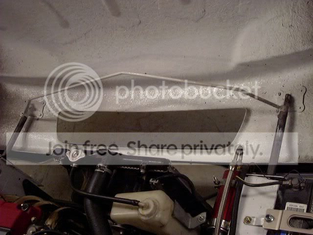

i just bought the mounting kit, its a basic bolt on affair just takes time.

sweet thanks for the pics!

i have the same mb setup as 1 2 NV...........keep the rods that slide the front in and out well lubricated and it works real well. my car was sitting for a while, and the rods got a little rusty; it was a little bit of a pita.

mine have never been rusty but thats prolly because i oiled them right from the beginning. id just dip my fingertip in oil lube up the rods. mine do get dirty so i wipe em off and apply new oil maybe once a season.
