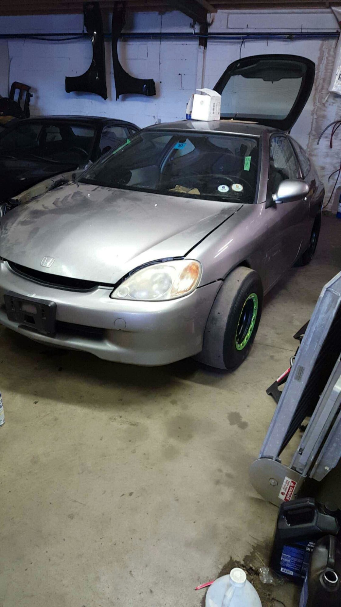

Hood will close without being cut
Like she belongs
Now time for fabricating everything else to fit perfect.
4.5 inches ground clearance
Shes in there finally

Heck ya. Getting the j in this chassis without having to cut the hood and having axles level and plenty of ground clearance was the biggest challenge to date.

Great job getting it under the hood. I about puke every time I see this swap hanging out the hood and some drunken sawzall operator made room for it to close.

It was time consuming Ill tell you that. But definetly worth the outcome and the cleanliness. Thank you

What knuckle is pictured there with the hub pressed out? Looks like it is wider at the strut mount than the civic stuff. Looks like it fits the wider insight strut very well. Is that an 07ish Odyssey hub? Parts fiche looks like it could be and the ball joint goes the correct way.
And safety **** question, does the oil pan hang below the bottom of the wheel? If you cut a slick will the oil pan hit the ground before the wheel? Are there rules in your class for things like that?
Anyway looks good! I am putting a K24 in my Insight and thought that was going to be a tight fit.
