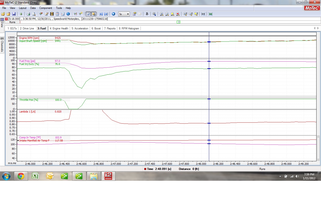

Default Re: Fuel pressure logging
I didnt need the Motec log to tell me that I'm a shitty driver, but it definately reinforces the belief..
