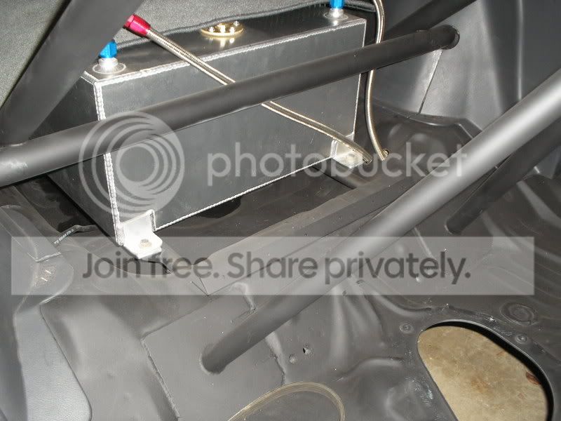

so I went to the track yesterday with the ITR that I just bought a couple months ago see how fast this baby go... but when I got to the pit check the tech guy said I not allow to run that at the track without some sort of firewall between the cell and me...
anybody have any idea what should I do? here is a pic:

you need a barrier seperating the driver compartment and fuel system area.

ill post pics of mine

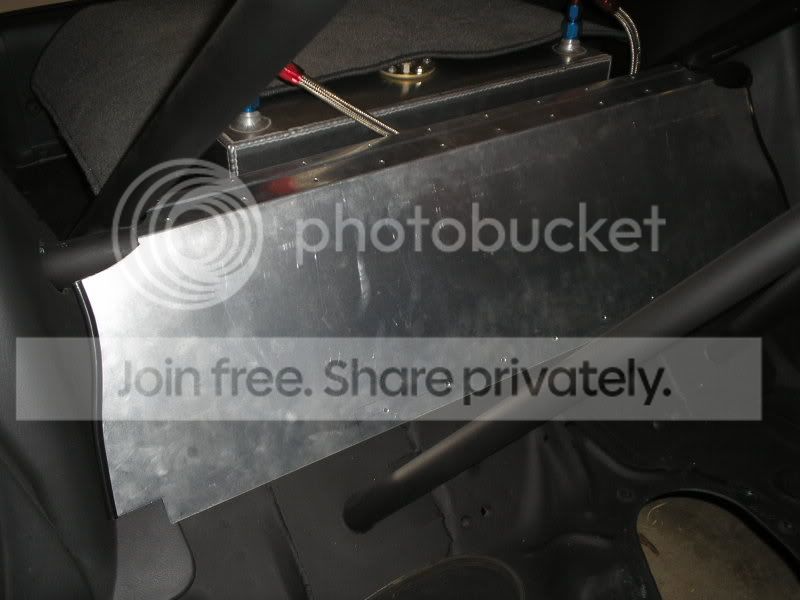

i made a mounting point for the bottom piece
bolt the bottom piece on
top one bolts onto the bottom one(its not in there 100% just for pics)
and then the back flat piece,trick door for race fuel!!!!!!
THE END

amazing work since its flat you can just put a sheet of alluminum over it kinda like the stock trunk carpet and rivet that down. maby have a flam over the filler neck?

yea i bought black pool table carpet and im goin to cover it to make it look stock... once its in, its not coming out for a long time.
