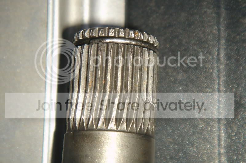

I am sending an axle in for a new cv. the inner spline twisted inside the diff. tranny had a quaife in it. ctr tranny. and of yours look like this? and this is also an old level 5/3.9

No, its acually stripped...
I will get some pics up soon
