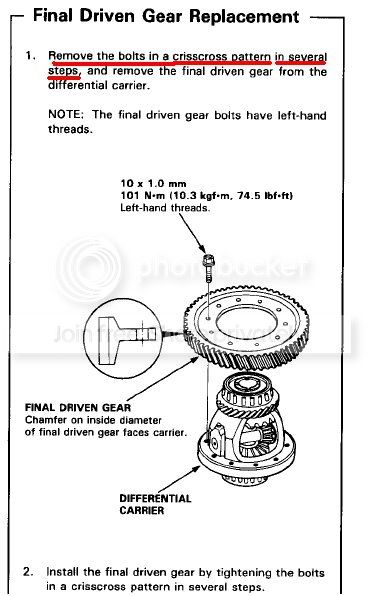

Went to swap ring gears on my quaife and 9/10 of the ring gear bolts came out difficultly and stripped out some threads on the quaife. Called up Quaife and they do not have any gsr diffs or extra parts for the gsr diff available.
I could tap and helicoil it but its reverse thread and I cant find a reverse thread tap/helicoil kit anywhere. Does anyone have extra parts from a blown up quaife perhaps or know of any other solutions?

i have noticed that as well. but if you loosen them in 2 or 3 stages, you will not strip the bolts out
I have seen this problem even with OEM diffs. You need to loosen then in stages and you will have no problems.

ITs a 10x1.0 LH tap.

here is the screen shot of the OEM sevice manual... ever wonder why HONDA would suggest something ? gotta be a reason.
