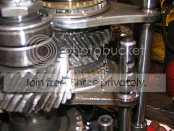

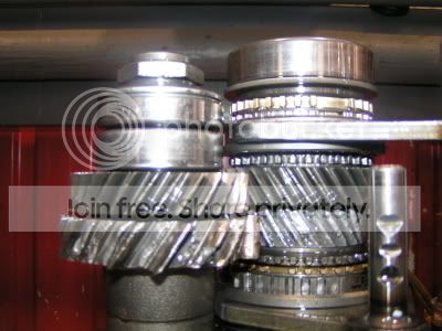

Here's what happened in testing this week end after struggeling with axle problem for most of summer :
Will the tranny cradle be any help in this case or do i need strogner gear than oem like liberty gear or any other brand ?

I broke my 4th gear last month on the street, it looked just like yours does. I just put the trans. cradle in, only made 5 runs on it so far no problems.

same thing happened a friends car on here, but it happened on the dyno, its a very high HP honda as well.
has the car seen alot of 4th gear dyno pulls?

it keeps the gear sets together so they dont split apart
