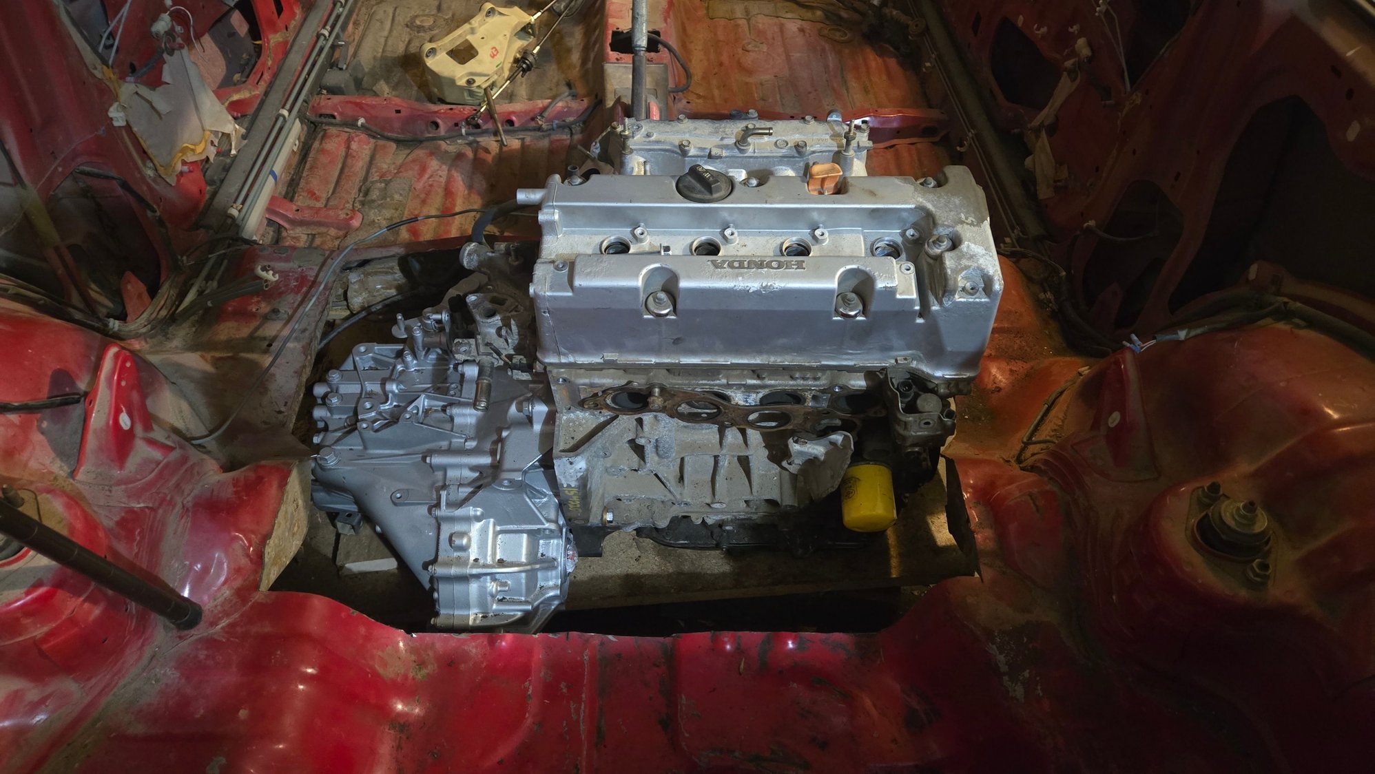

(Also, posting a picture because I know people are going to ask &#129315
Axle location is just ahead of rear crossmember, similar to rear diff axle location for AWD swaps.
Just barely clears each frame rail without needing modification. Serpentine belt will just clear the wall of the frame and floor pan.
