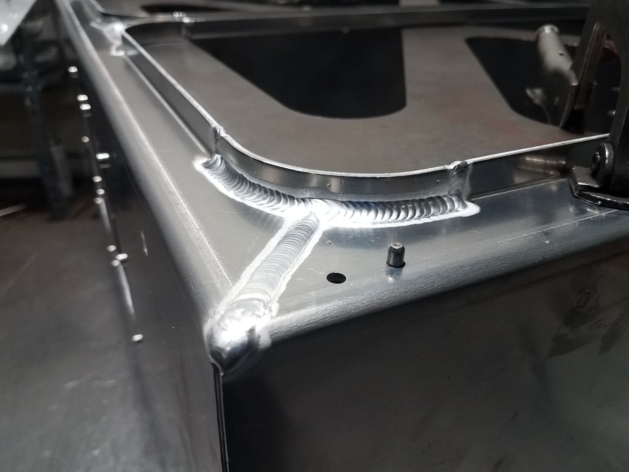

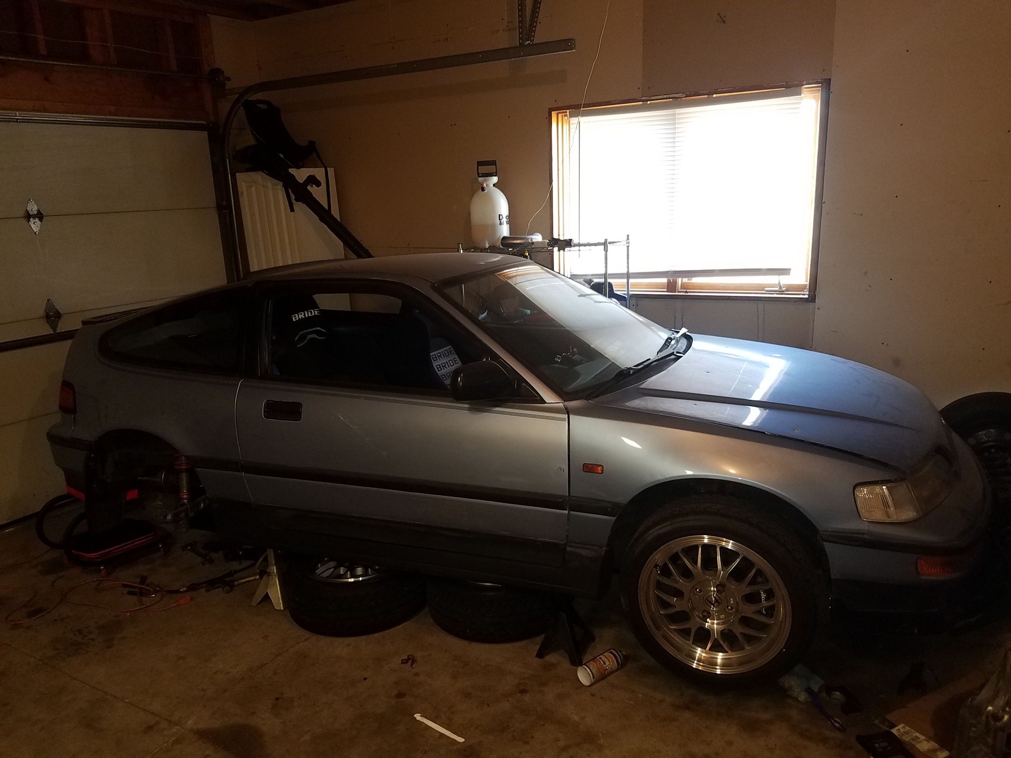

I work at a sheetmetal shop and plan on modifying old part to work with my current set up. I have an ls/vtec crx with about 500hp and $350 left on my budget.
started the project a couple months ago.

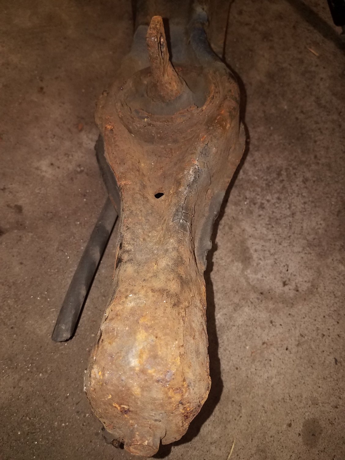

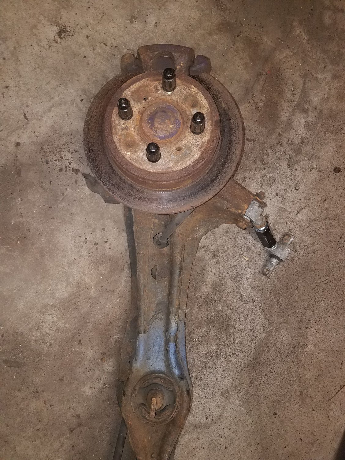

picked up some trailing arms hoping to trade later for something I need.
$50 but are in terrible shape

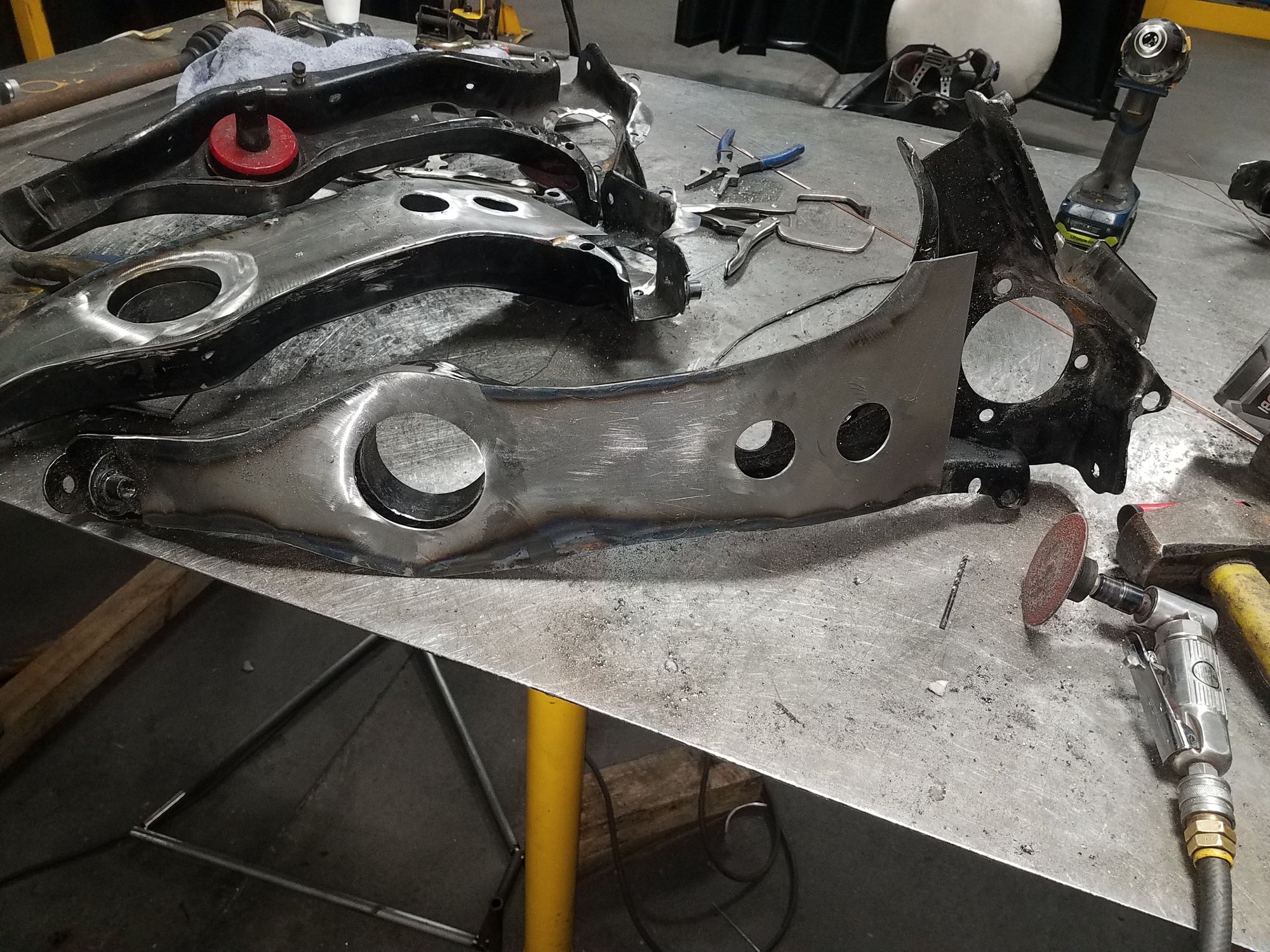

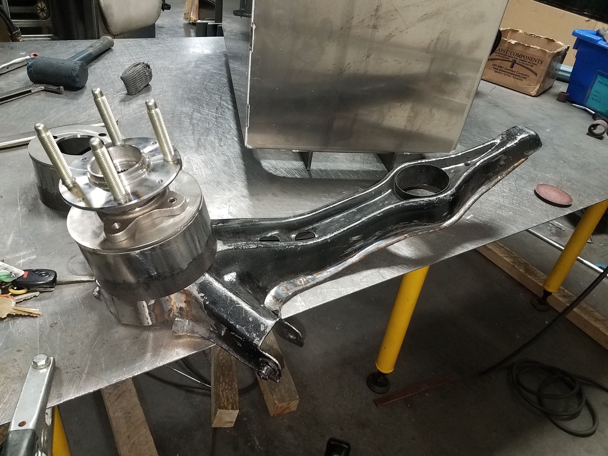

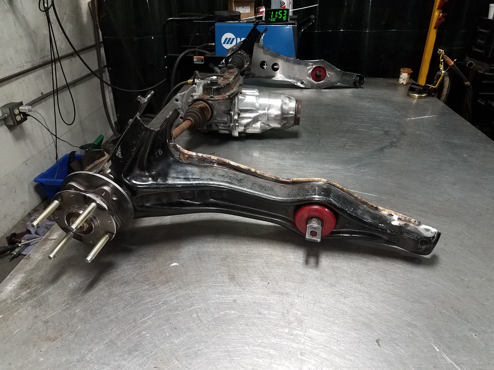

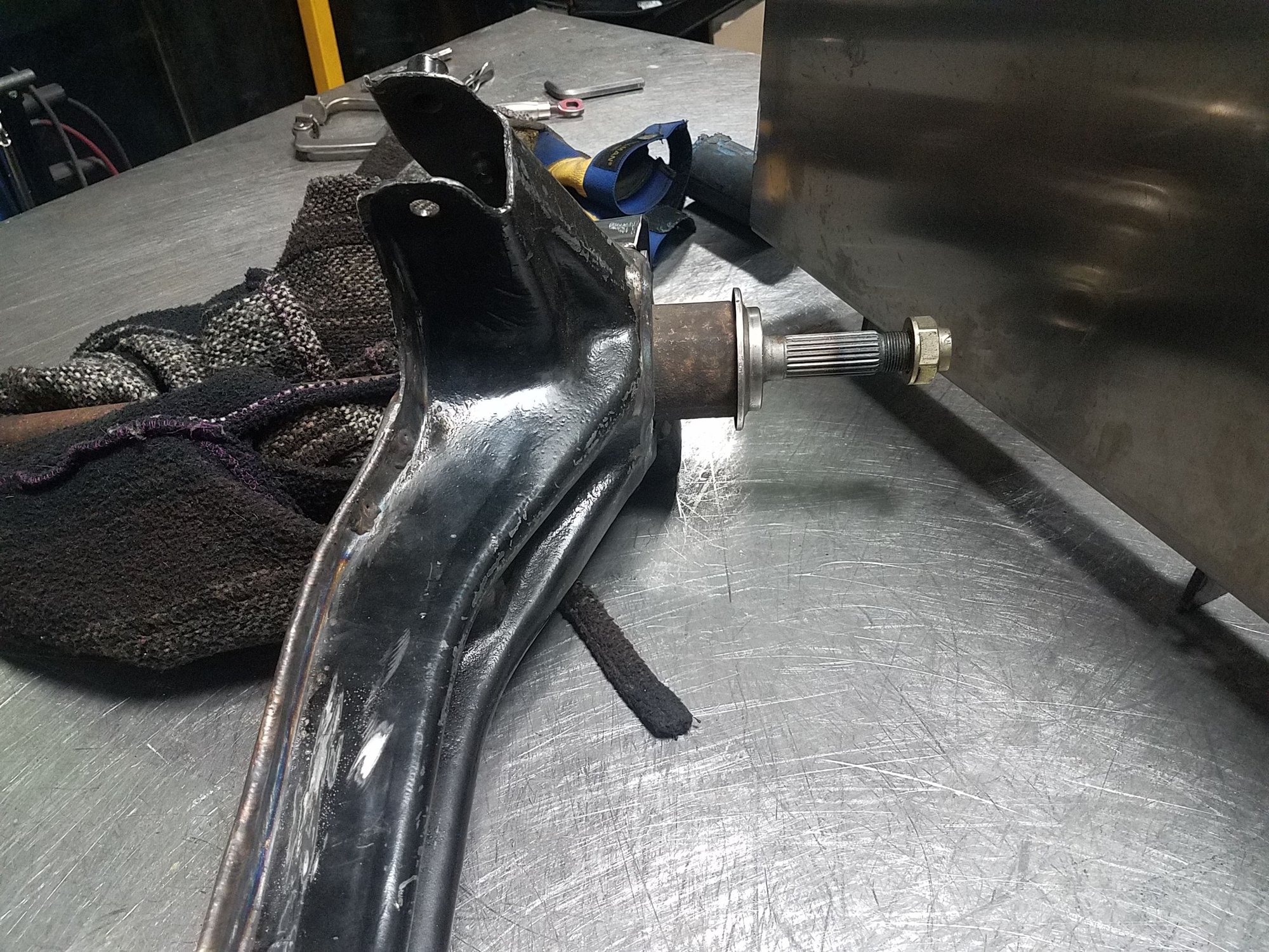

currently have one short and long axle so I'm going to be stretching the rear by 3". I bought a 2nd set of trailing arms and will be shrinking them about 2" to better fit two short axles.

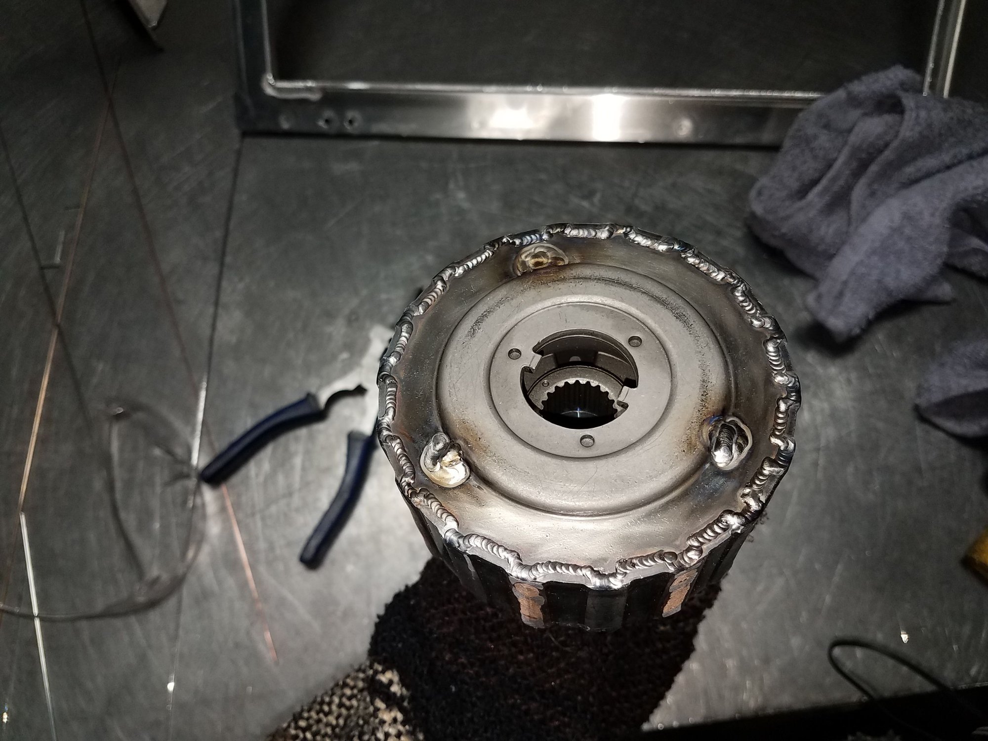

Welded up the dual pump to use a viscous coupler from a range rover?
Yes

going to beef up the metal around the mounts and try and clean it up.

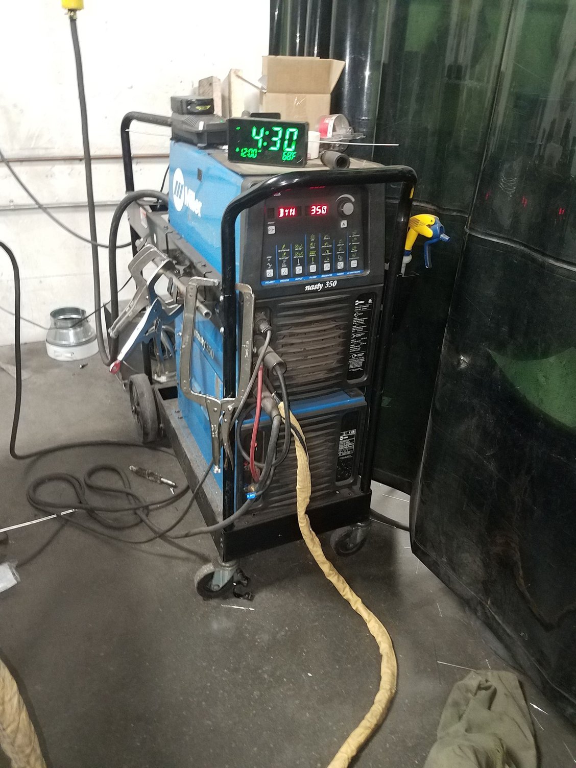

I'm using a miller dynasty 350 from work, wish i owned my own little shop though. Ive had this thing since high school. Happy i never sold it.

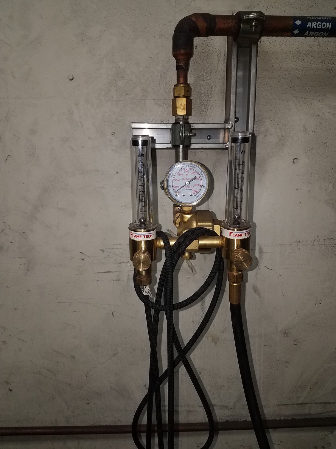

bought a dual regulator to try and start making turbo manifolds.

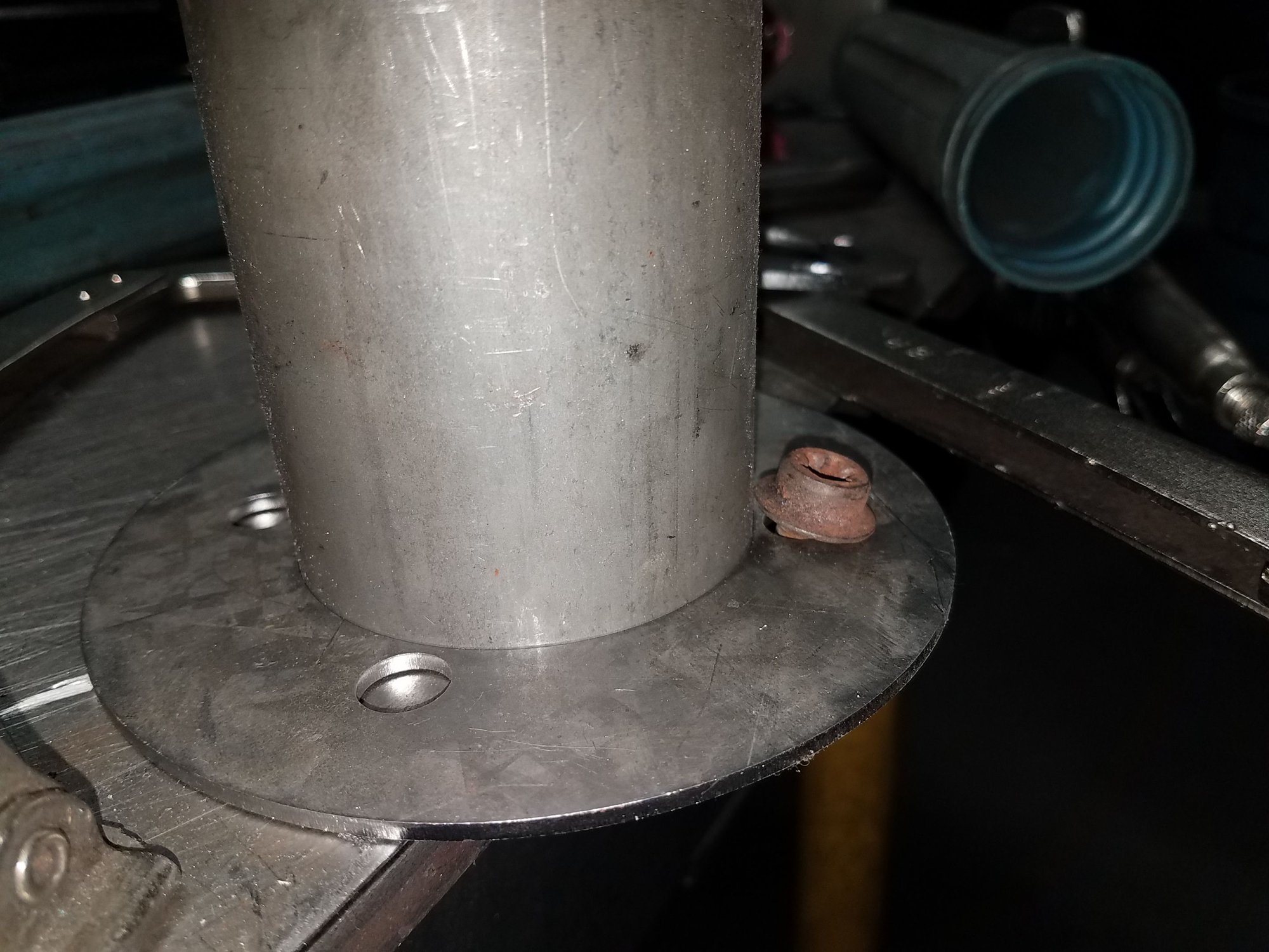

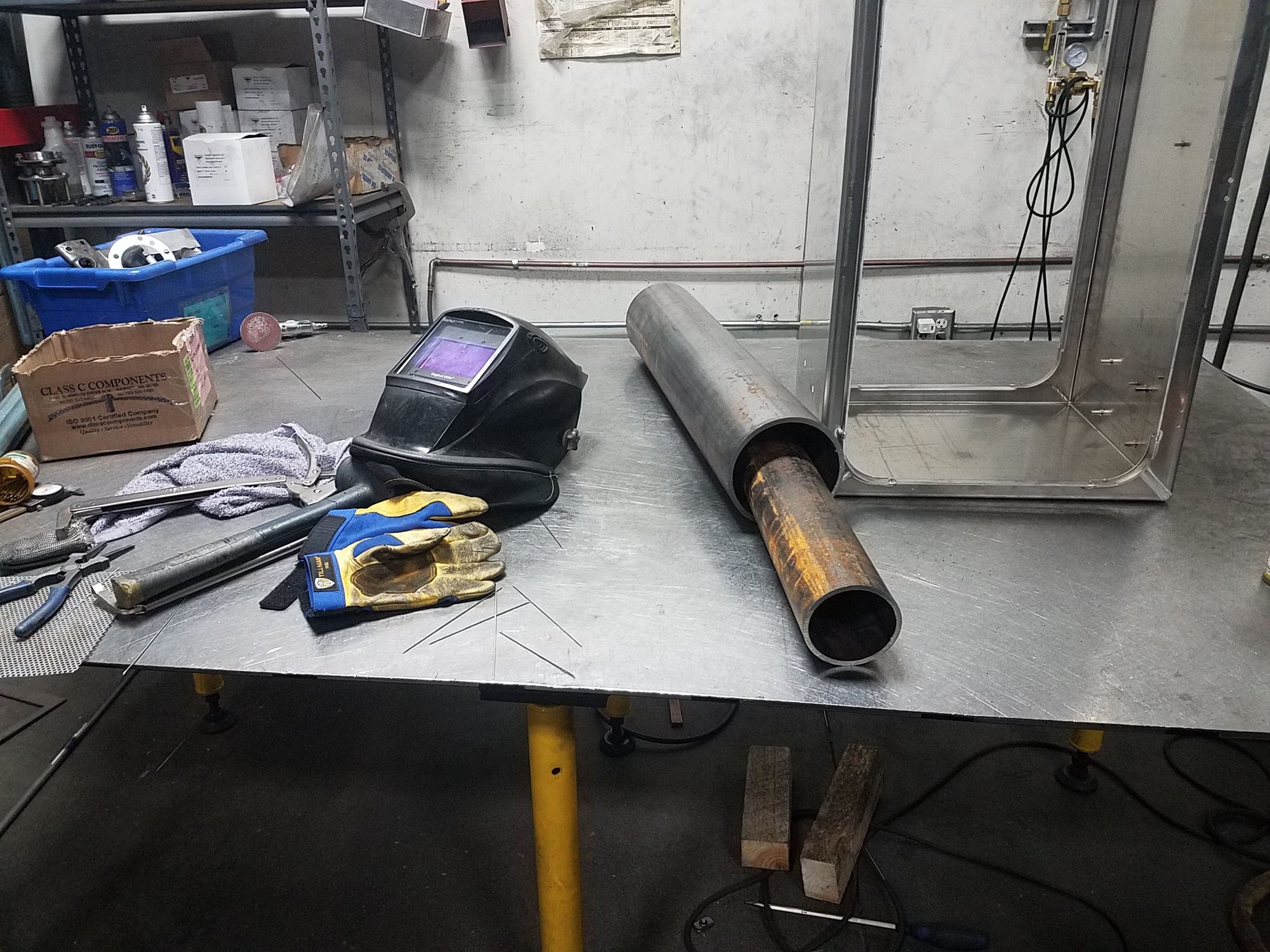

been working too many hours to work on the car but i just ordered some 5" pipe to finish the trailing arms.
Old May 6, 2020 | 01:42 PM
Caoboy's Avatar
-Intl Steve Krew
Community Influencer
Active Streak: 120 Days
Loved
Posts: 7,010
Likes: 197
Default Re: AWD for 1k
Why such a big pipe?

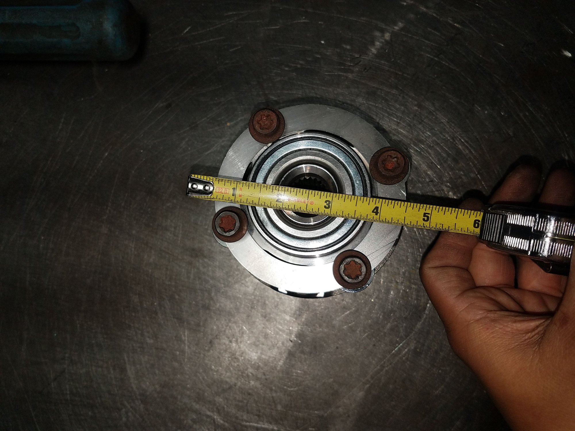

Old May 7, 2020 | 04:02 AM
tigArex's Avatar
Joined: Nov 2019
Posts: 34
Likes: 11

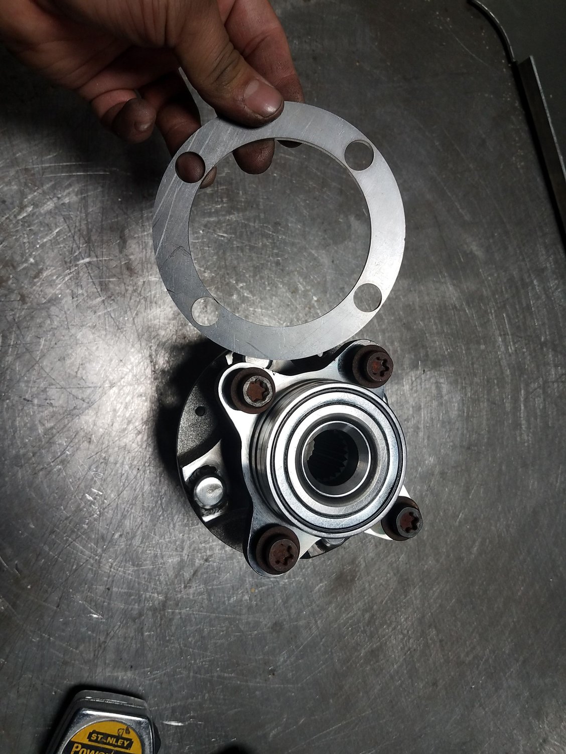

bolts hits on 3"
Old May 7, 2020 | 06:33 AM
Ryanthegreat1's Avatar
Posts: 3,585
Likes: 501
Wheel bearings will thank you for not running spacers. The shocks on the other hand. Going to double the lever arm on the suspension. Probably will need double the spring rate and valving.
Old May 7, 2020 | 02:37 PM
tigArex's Avatar
Joined: Nov 2019
Posts: 34
Likes: 11
long one would have the axle about that far out

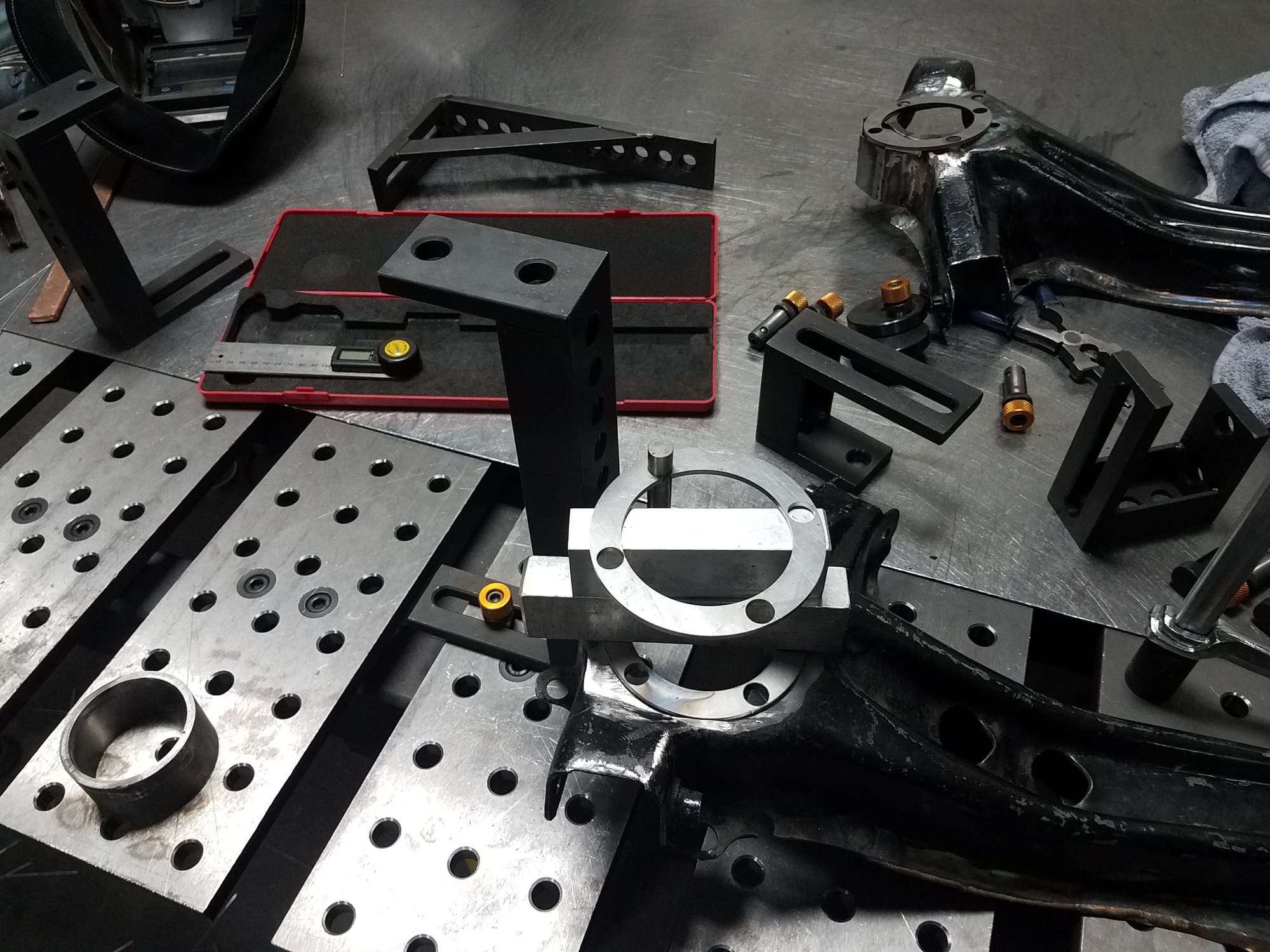

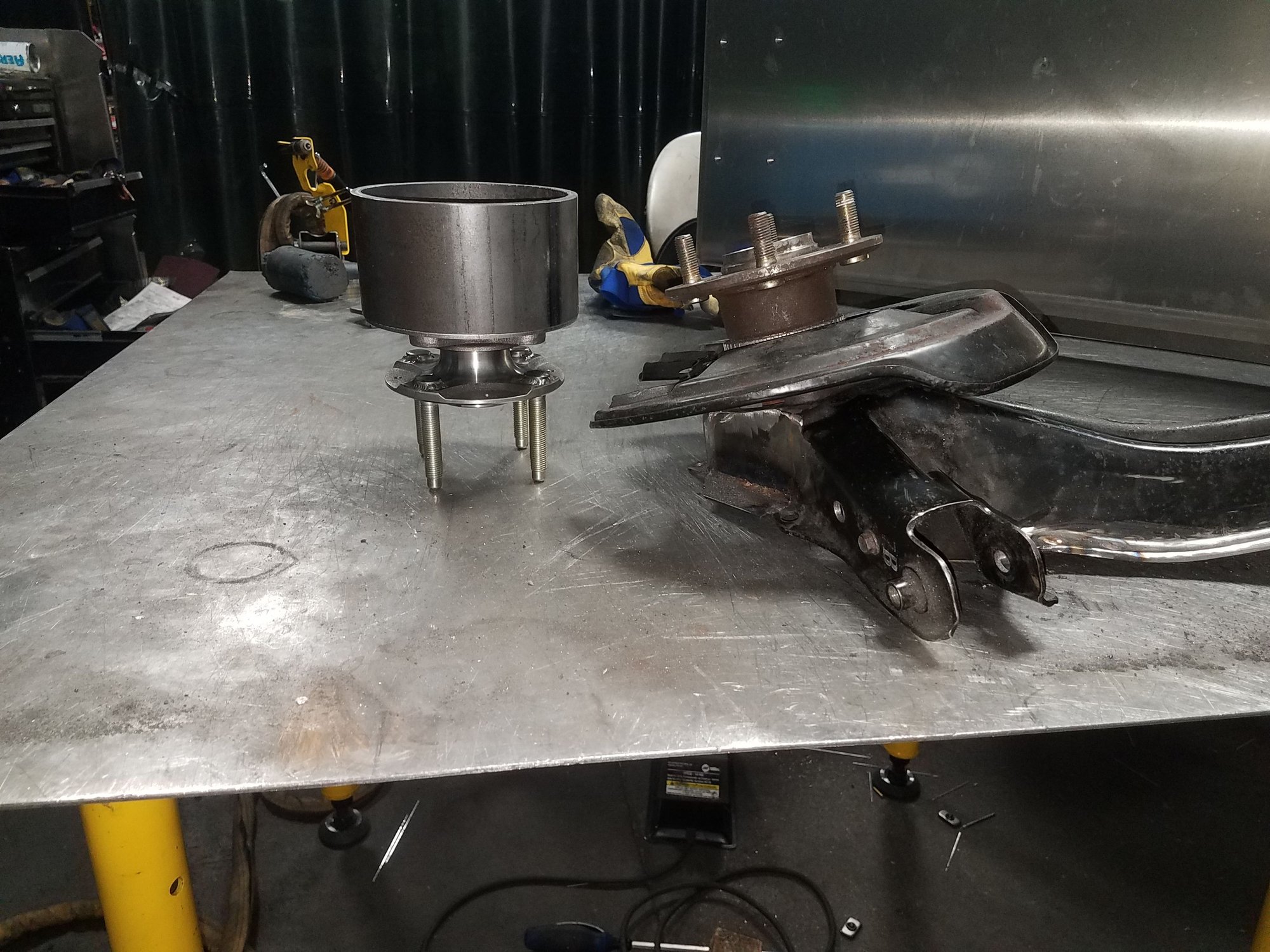

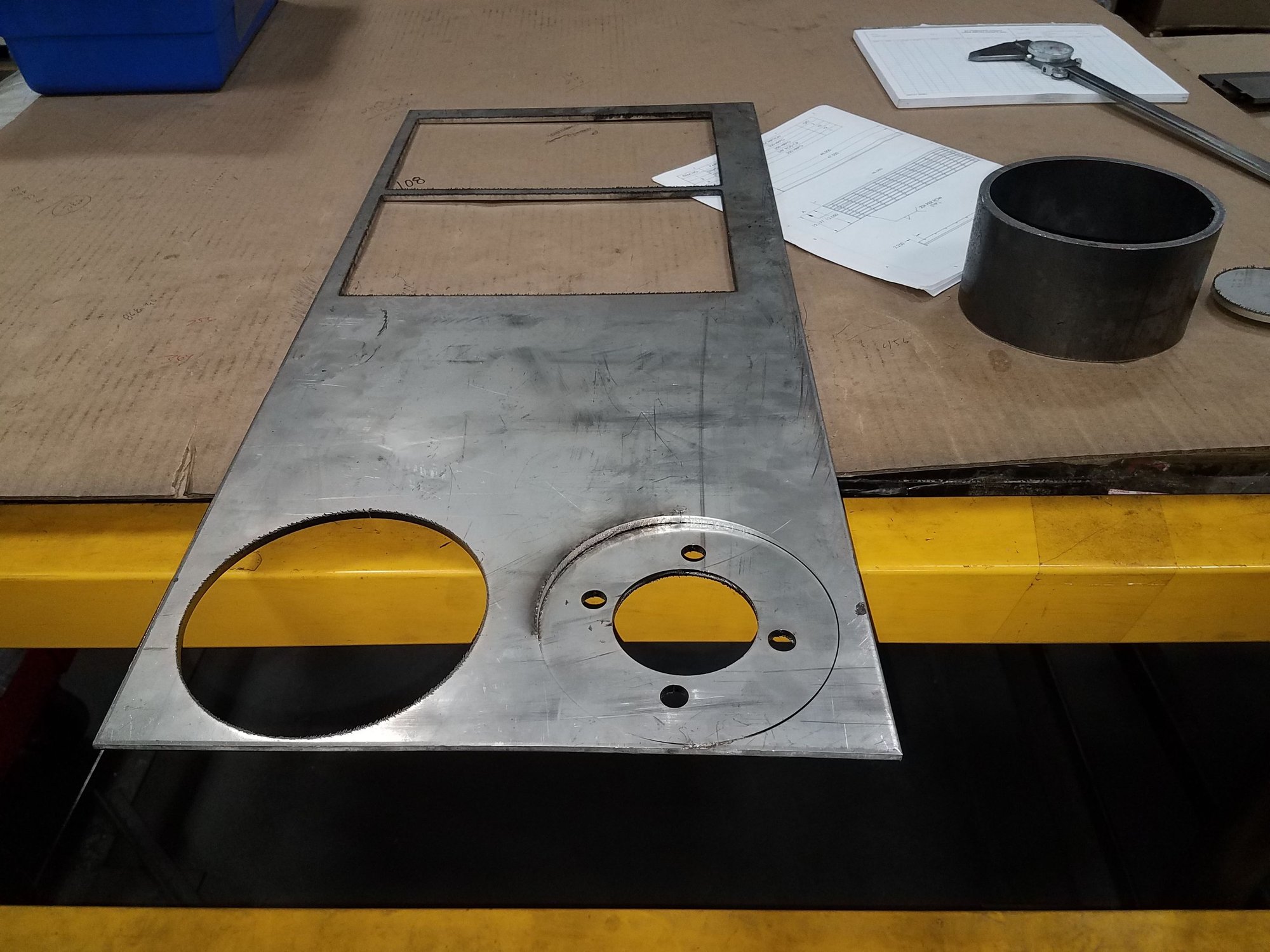

Just picked my material. Bought some extra material just incase.
trying to find the strength to go to work at 3am to finish this up but working 65 hours is getting to me

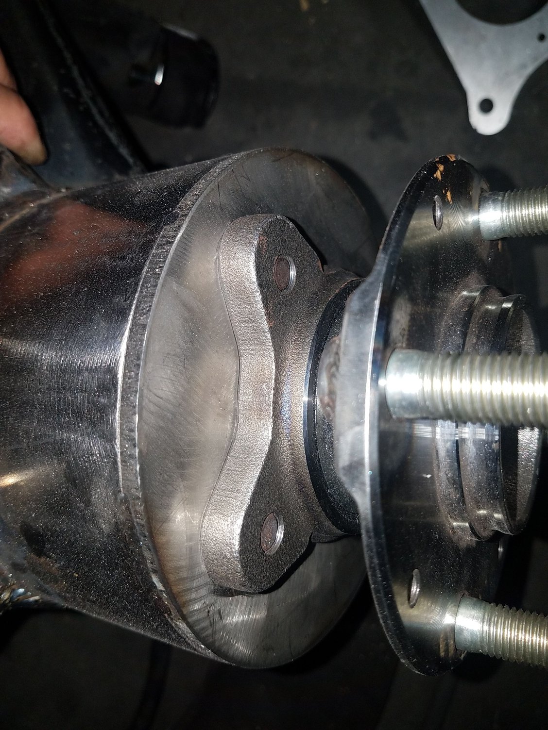

didn't make it in early but I got a little done during lunch.

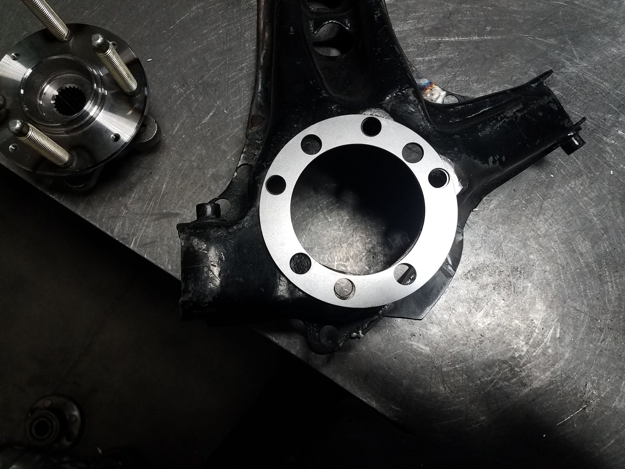

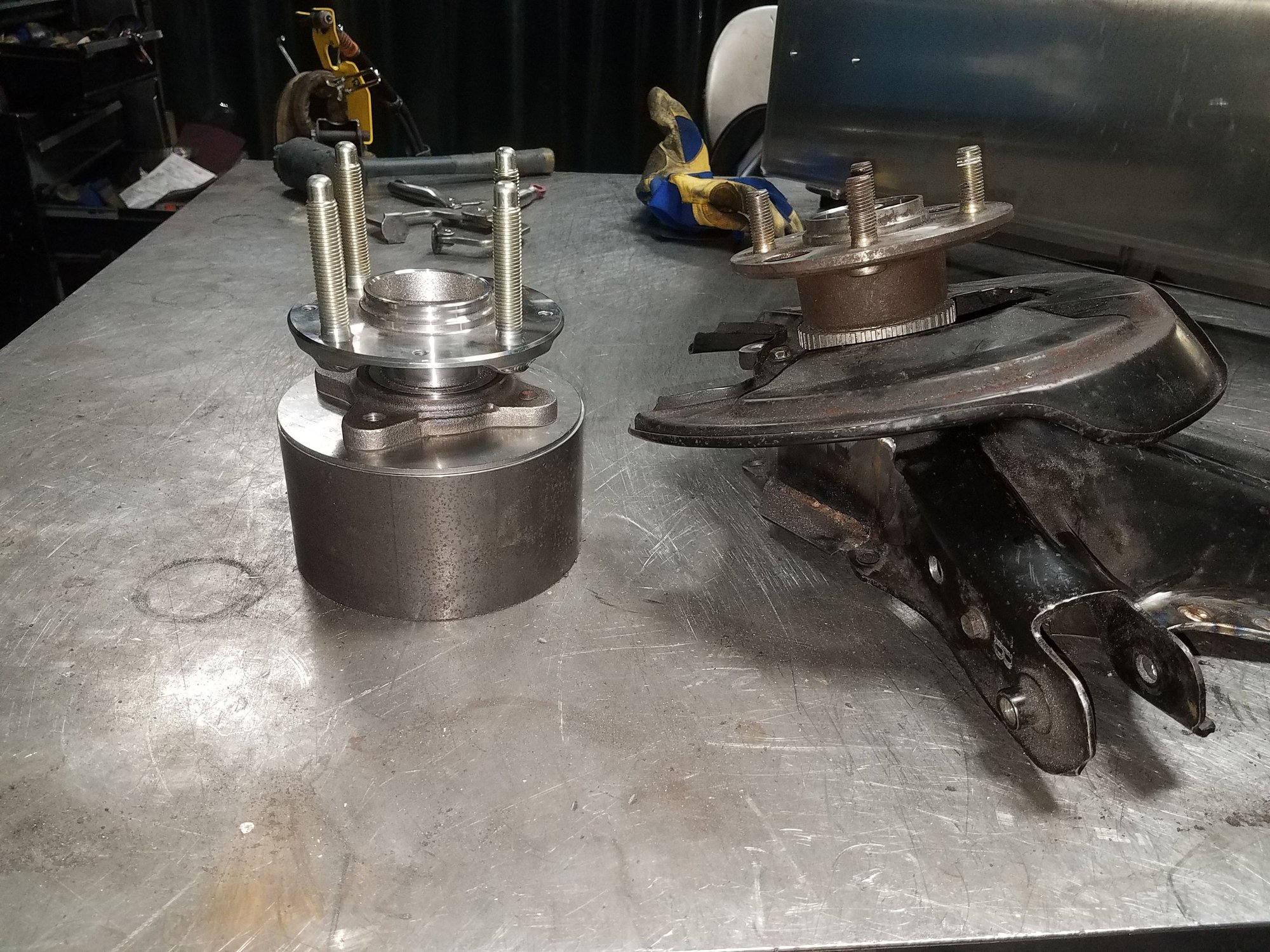

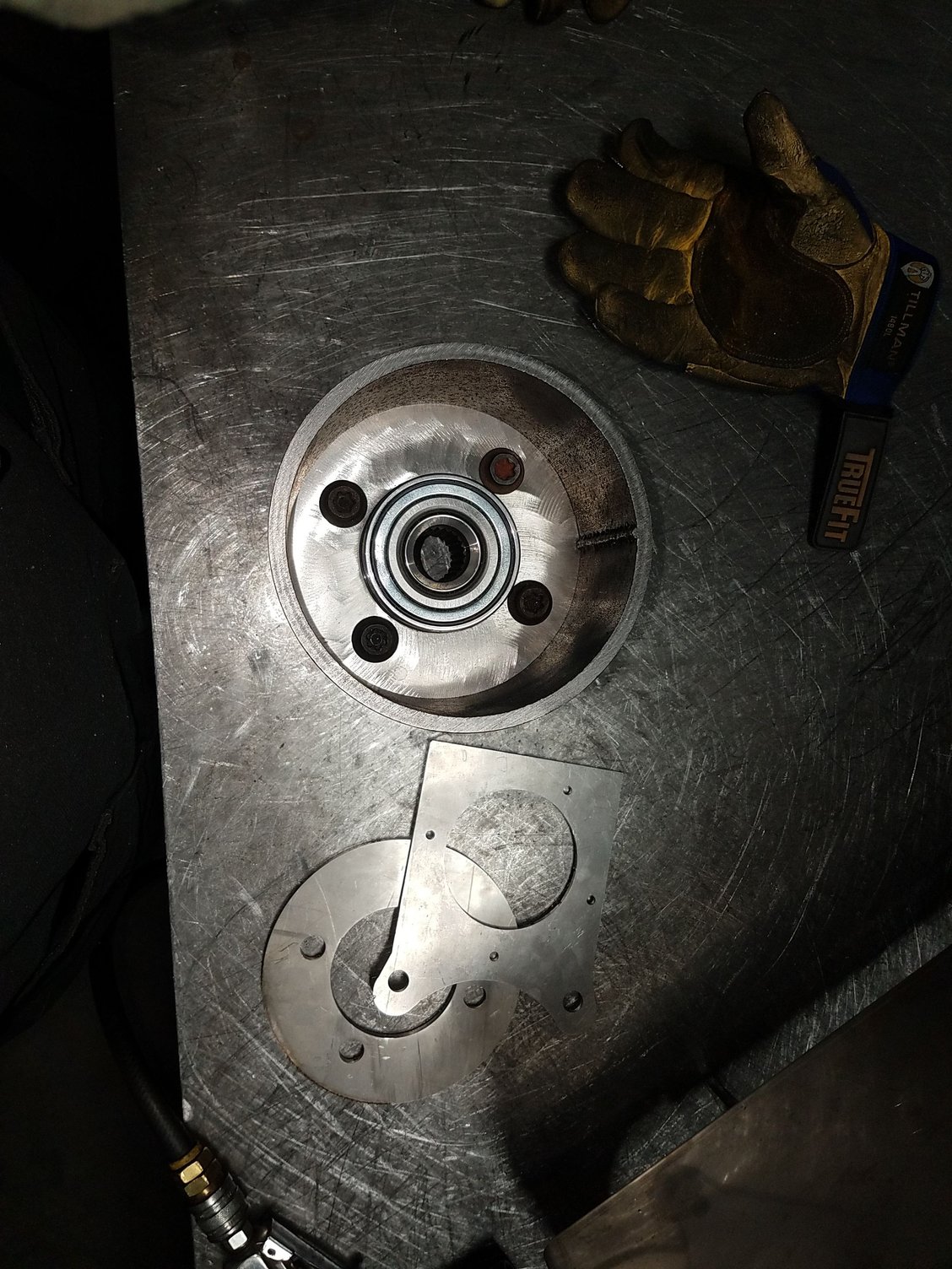

Should have gone with the 4.5" pipe but this will work I guess. Bought enough material to make about 7 sets.
found some 1/4 " stainless in the scrap pile.

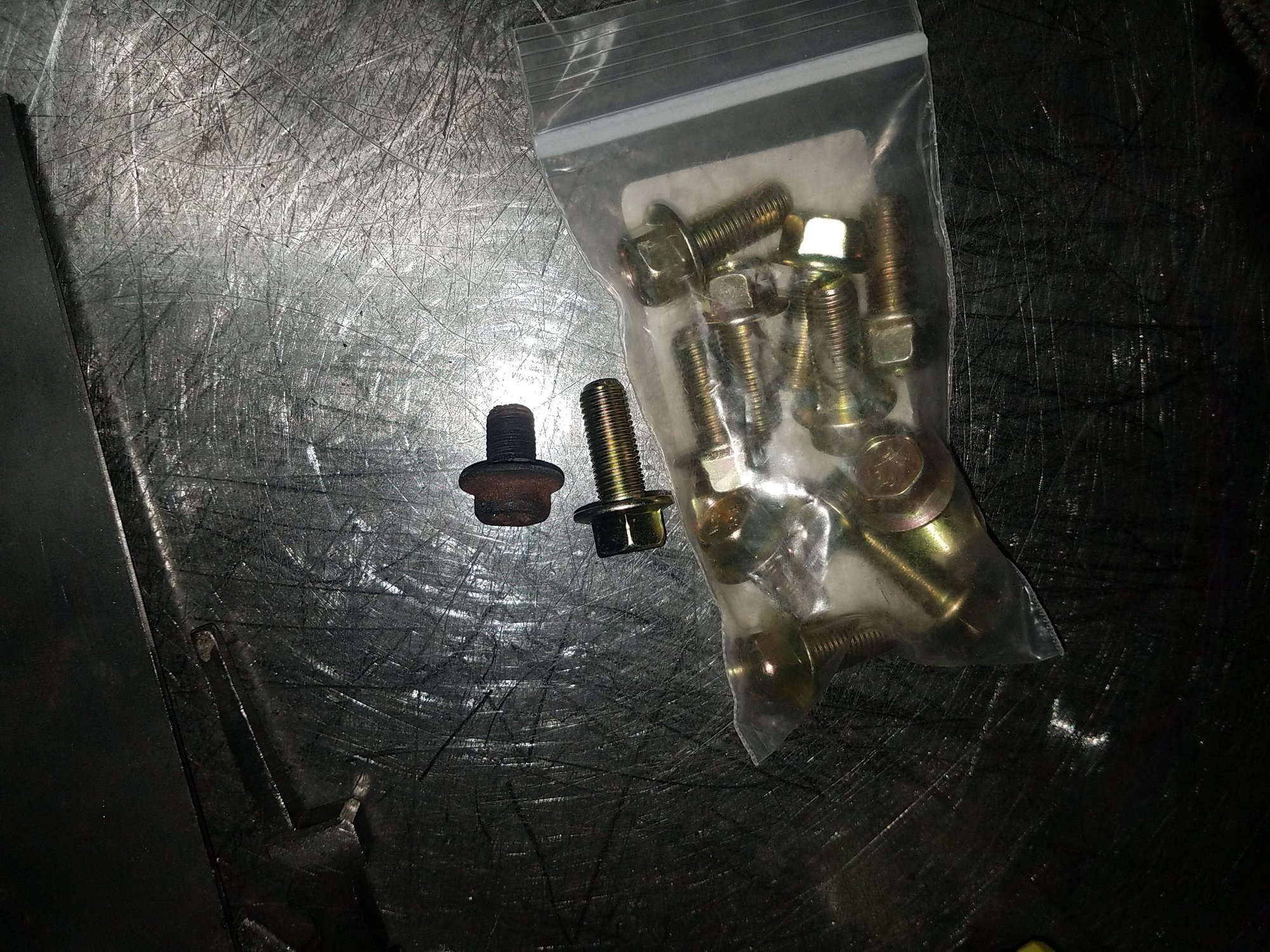

need longer bolts
just placed on top not done

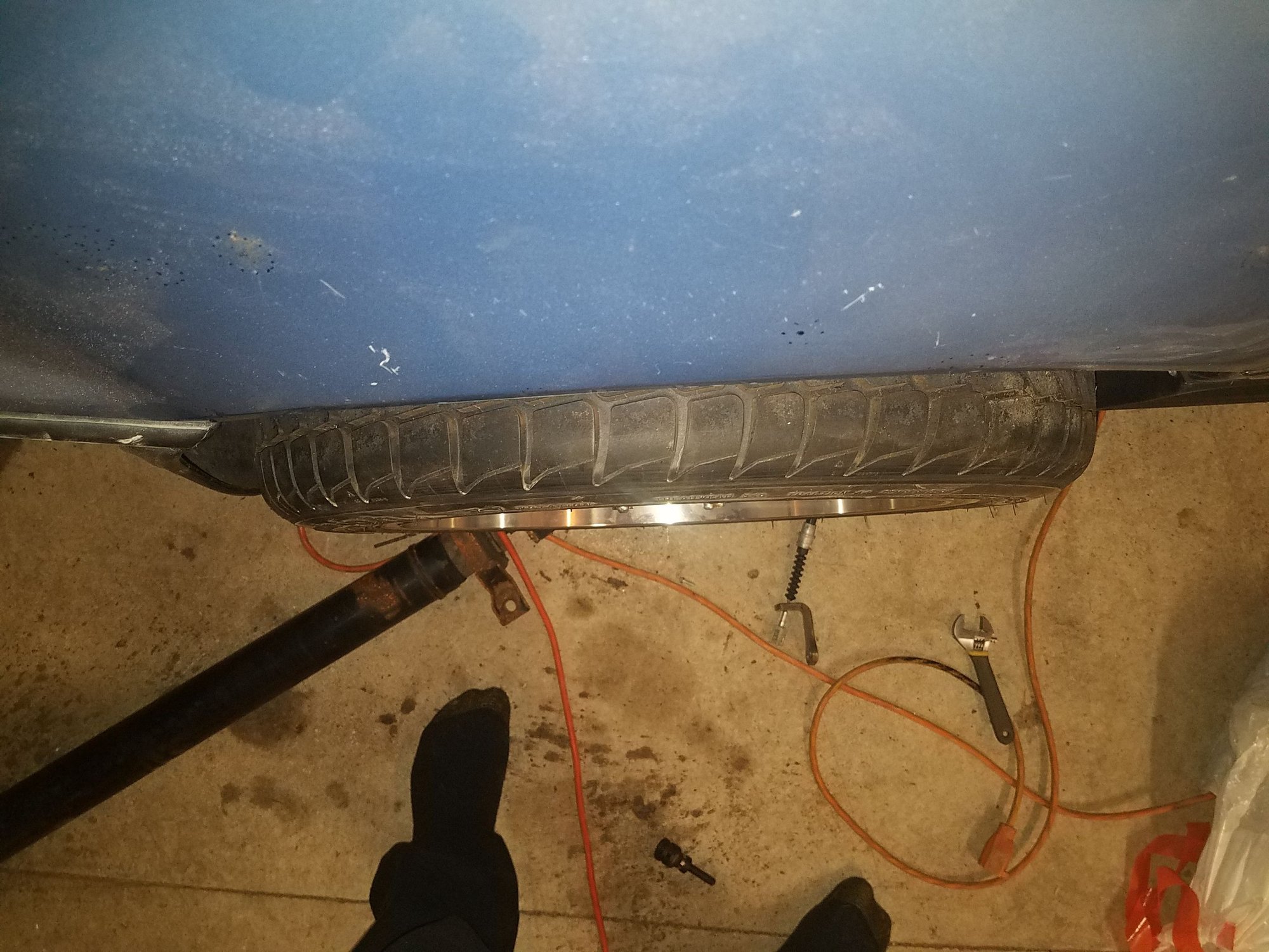

Old May 24, 2020 | 08:50 AM
tigArex's Avatar
Joined: Nov 2019
Posts: 34
Likes: 11
still on jacked up but this is a rough look at it stretched

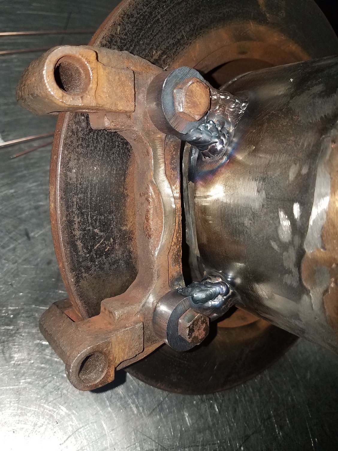

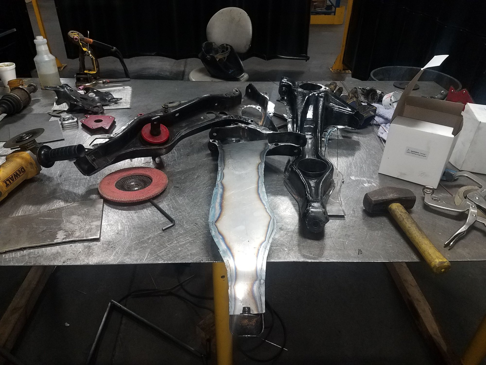

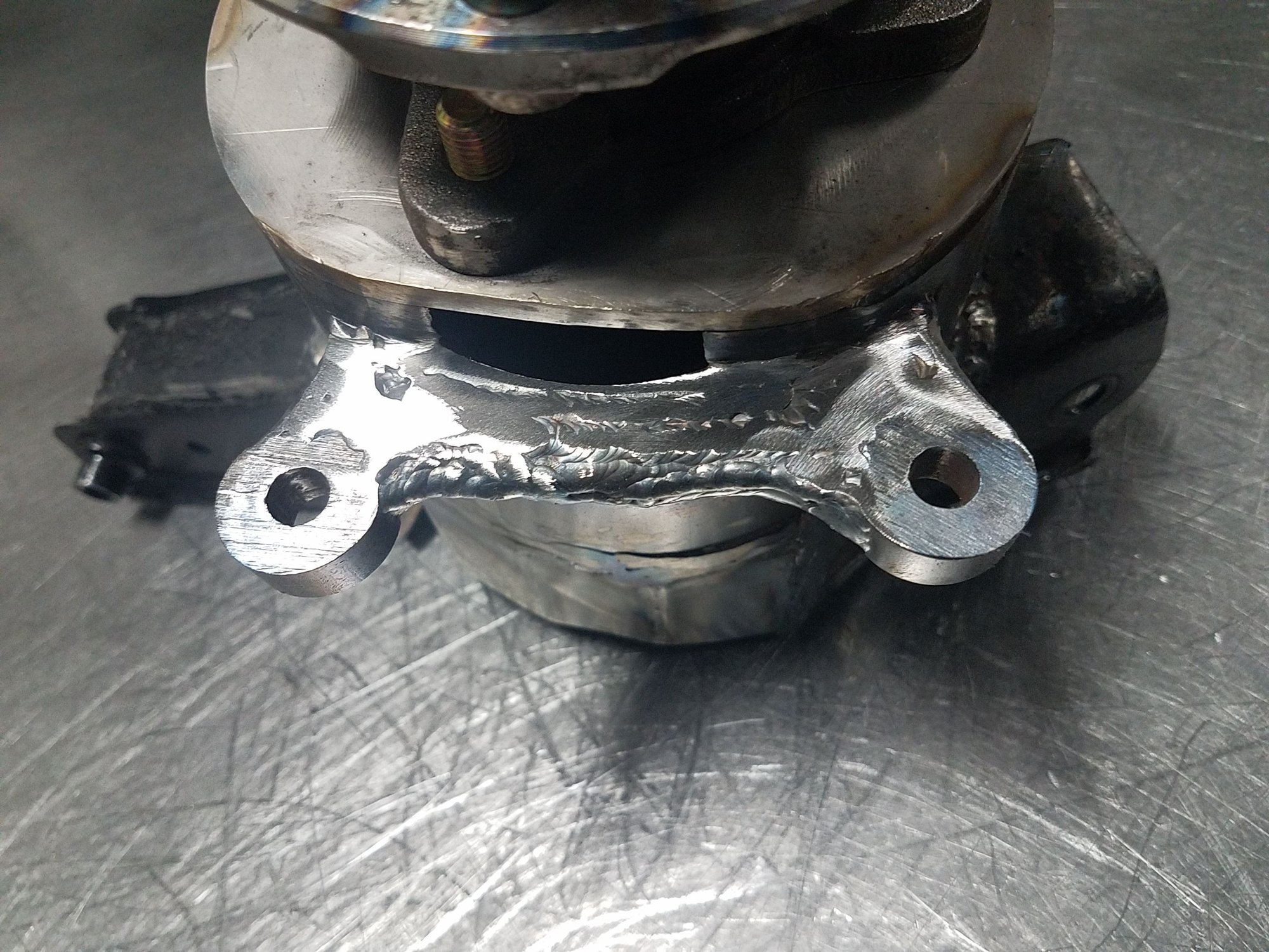

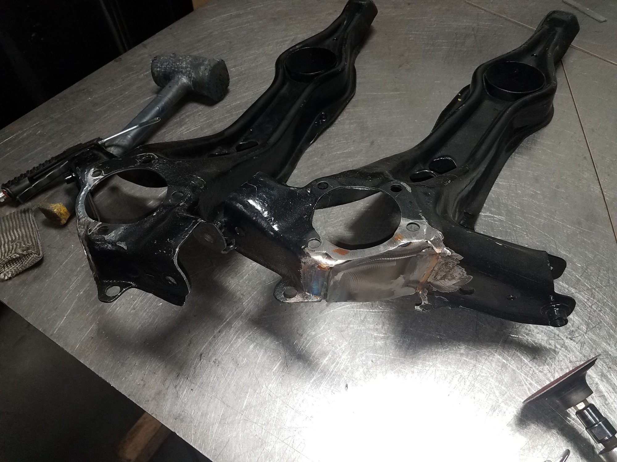

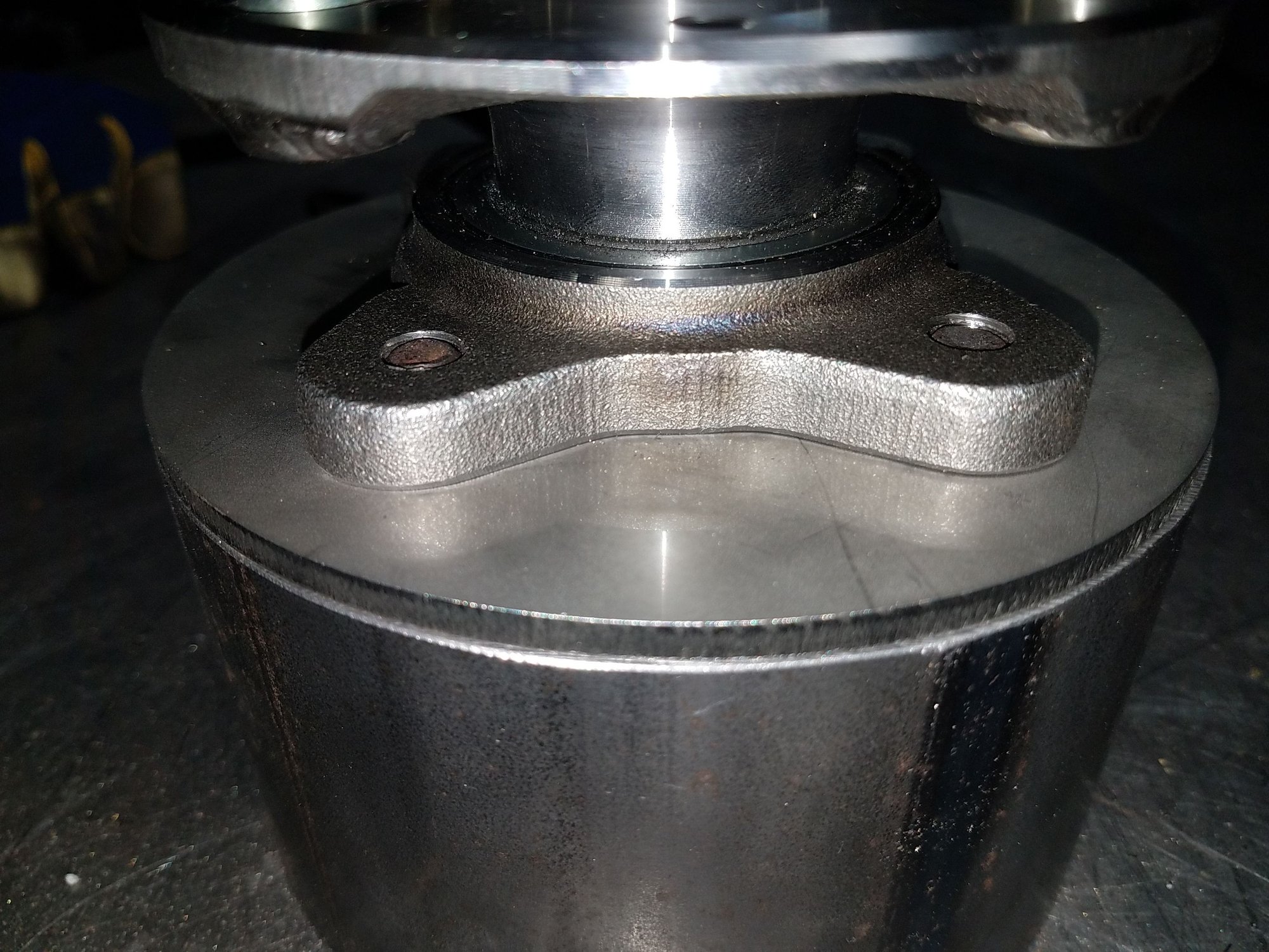

finally got some time off so I came in early to fix some mistakes. Messed up the brake caliper location but everything fits when you have a welder!
will add more material and grind smooth
replacing the torx bolts with something longer
finishing the support
too short!

Old Jun 22, 2020 | 04:21 PM
tigArex's Avatar
Joined: Nov 2019
Posts: 34
Likes: 11
some progress during lunch
should have it cleaned up and evened out by tomorrow.
Old Jun 22, 2020 | 04:59 PM
Posts: 3,585
Likes: 501
Holy weld build up! Why not band saw out some 1/4" plate? Even a zip disc would work. Geebus! That was a lot of gas and a lot of heat!
