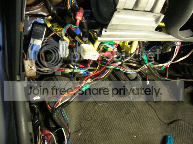

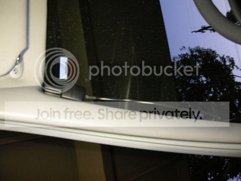

Right way
Stop and don't let any installers do this to your car.
or this
or this
or this
or this
close but still no cigar

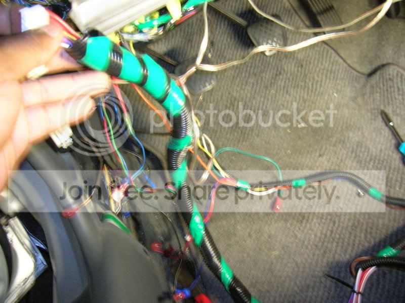

This is the best way, Sorry, I can't show you were the brain is but you get the picture, there is plenty of room
or basic like this
All alarms should have a back up battery and a hood pin. I say all should have some sort of tracking system. But Some can't afford it or its out there budget. Most if not all the thefts on here could been avoided. I feel if you dump 4k plus into a new swap, rims or any other mods why not start with security first? So a theif can watch you build their next target or new toy. Once people wake up and figure this out there will be no more thefts. Its not the theifs fault that he took your car. Its his dumb broke azzzzzz job. Its your job to secure your car. If you read this you need to go look under your dash and compare with the pictures up top. If you match the bad ones you need a new game plan.
