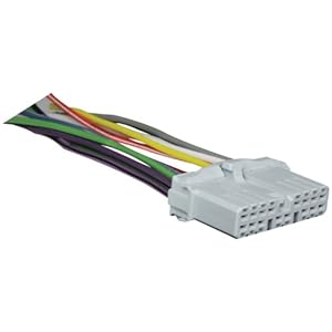

Old Oct 15, 2014 | 10:27 AM
MotoCARR's Avatar
Posts: 497
From: Illinois
Default Re: stereo wiring help!!!
OEM stereo wire colors
