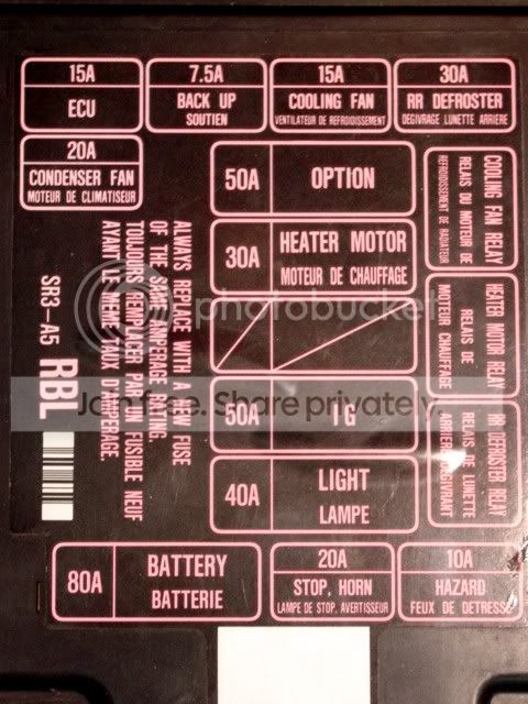

After you test the radio fuse in the fusebox under the dash also test the radio/back up fuse that is in the fusebox in the engine bay.

Looking through the manual, I see the radio fuse under the dash, but I don't see the radio/back up fuse in the under-hood fuse box. Do you know which fuse that would be (#)?

8520's Avatar
Posts: 6,416
From: Seattle
Default Re: Stereo not saving presets/settings. (ShinyNewPenny)
Old Oct 25, 2007 | 10:08 PM
ShinyNewPenny's Avatar
Joined: Aug 2007
Posts: 111
From: Illinois
Default Re: Stereo not saving presets/settings. (8520)
Thanks
That sticker on the top of my fuse box is all wrinkled/faded and hard to read.

Ok, I looked at the back up fuse(under-hood) and the radio fuse(under-dash) and both looked fine. I also checked the fuse in the radio while I was at it, that was fine too.
