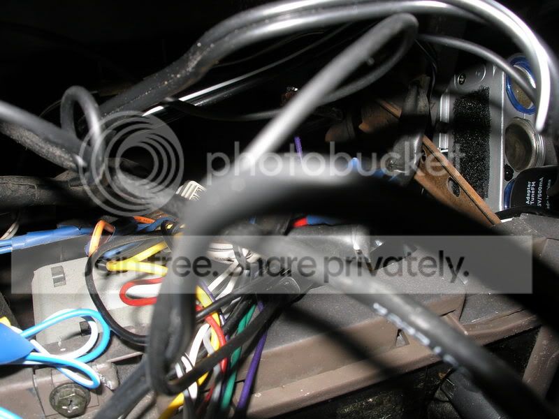

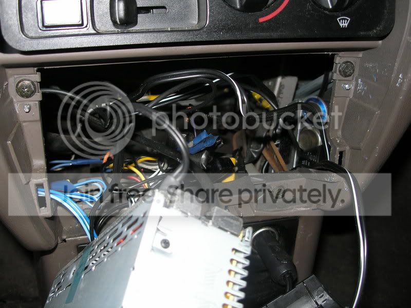

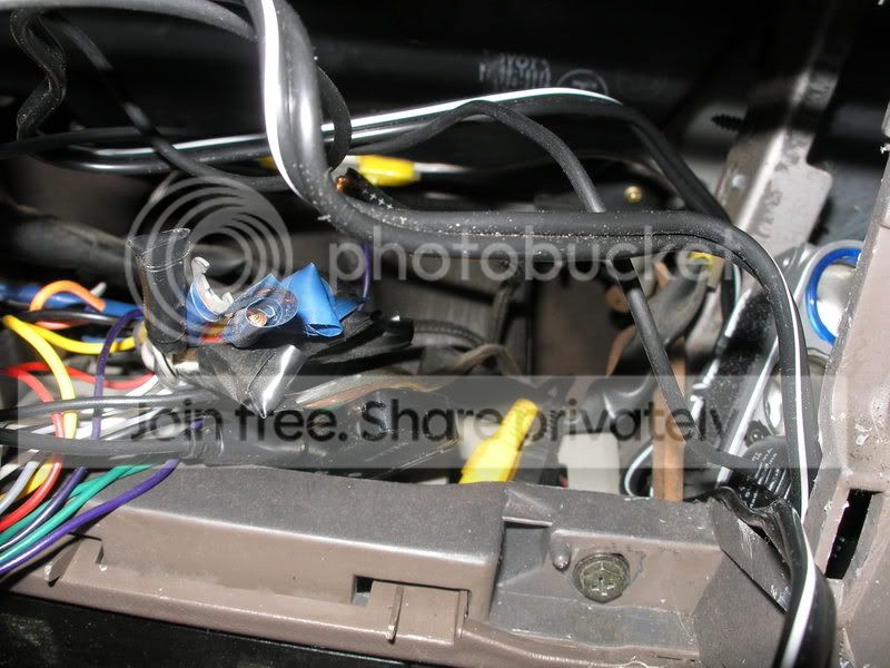

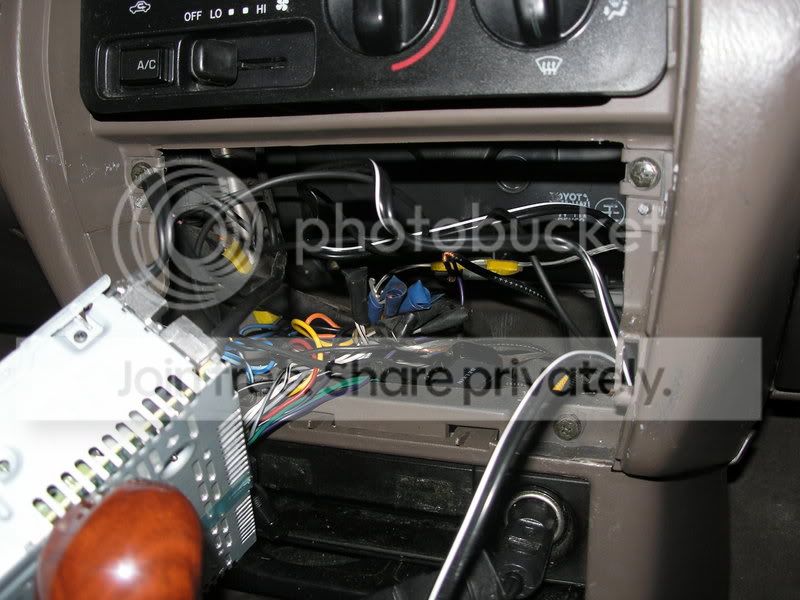

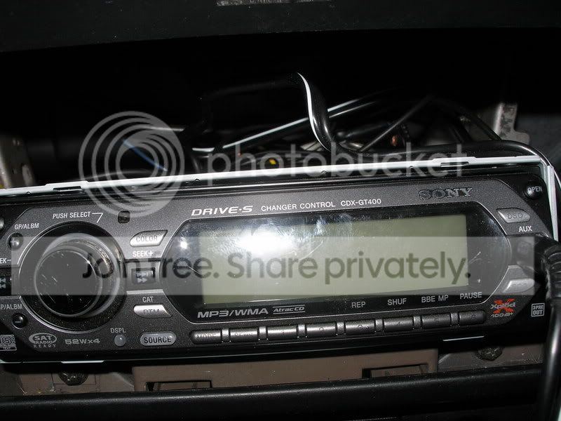

I took some pictures
Here's the temporary CDX-GT400 I plugged in there:
Here's the butchered (but working) wiring job:
Here's what the "old" radio looked like - the CDX-CA700X
Anybody see a way of making it work??

Start by cleaning up the wiring, you do not need to go through the cost and trouble of getting a stock radio plug, reconnecting it and then adding an adapter harness, connect the Sony's harness directly to the cars radio harness, start by cutting all the leads of the cars radio harness to the same length, [disconnect the batt.] then cut the Sony's harness leads all to the same length, keeping both sets of leads as short as convienently possible, [don't forget you will have to make the connections in the dash, so cutting them too short is not a good idea] the crimp or solder and shrink tube the two harnesses together.
Here is a pin-out and color code... http://www.installdr.com/Harnesses/HA-Wiring.pdf the only one missing is the stock illumination lead, [red/black] you may not need it, if not don't forget to cap it off.

Sorry if I was not being clear...
I understand that the cars stock radio plug was cut off and the Sony harness is wired directly to the cars stock radio harness.
I recommend you rewire that mess, connect the Sony harness directly to the cars radio harness, like it is now, only do it properly, with solder and shrink tube or butt connectors ... http://www.scosche.com/scosche...R-100 and excess/unused wiring removed, and the harness "bundled" and zip tied together, [or taped] neatly together.
There is no point in spending the money, [$10 - $20] on something, that even if done properly, will still add 3 more connection points, one of which is only a contact connection, [plugs].
Unless you are planing on putting a stock HU back in, there is no need for a stock radio plug, so no need for the adapter plug either, there are better places to spend that $20 doller bill.
