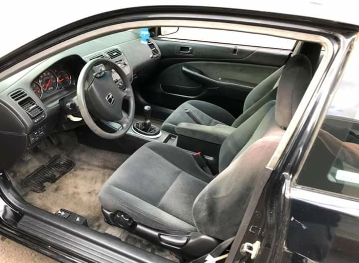

So.. had some work done on my Civic (2003) radio locked out, found the code online got it sent.. still locked out..
BUT
going to replace it anyway!
Will the radio anti theft feature conflict with a new head unit?
Will get better photos soon.TIA!
(assuming the code lock is built into the OEM radio)

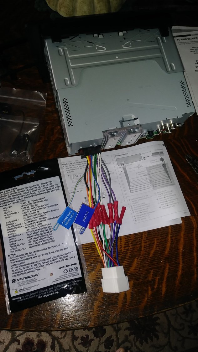

So far it's, wire for wire I think I have only one question, The orange white or orange orange one is missing from the other, assuming I only need the dimmer which is orange white?
Old May 29, 2020 | 10:14 AM
Denise03's Avatar
Joined: May 2020
Posts: 52
Likes: 7
From: Bristol PA
Default Re: New bluetooth unit vs old code lock
Forgot this picture!

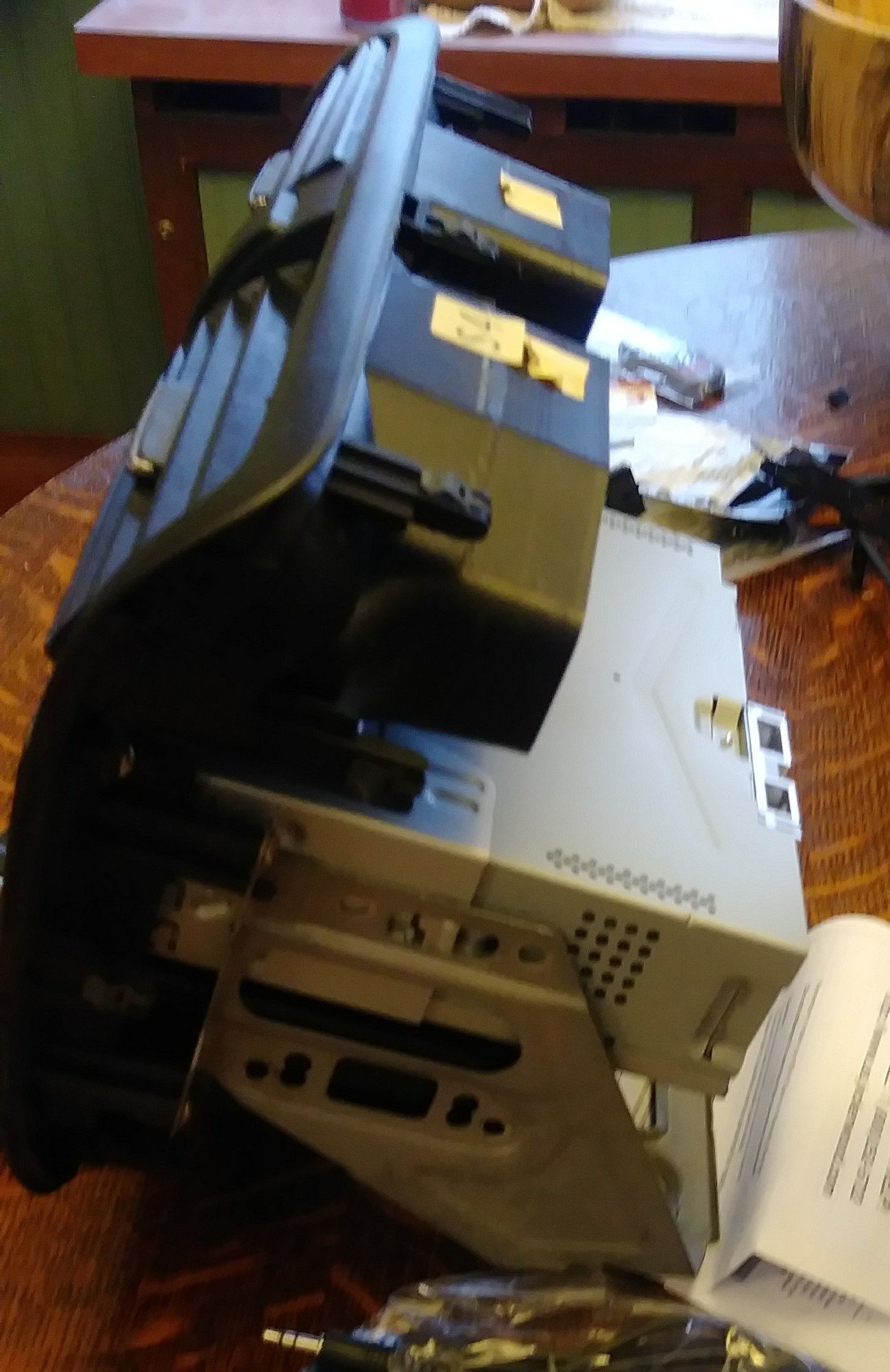

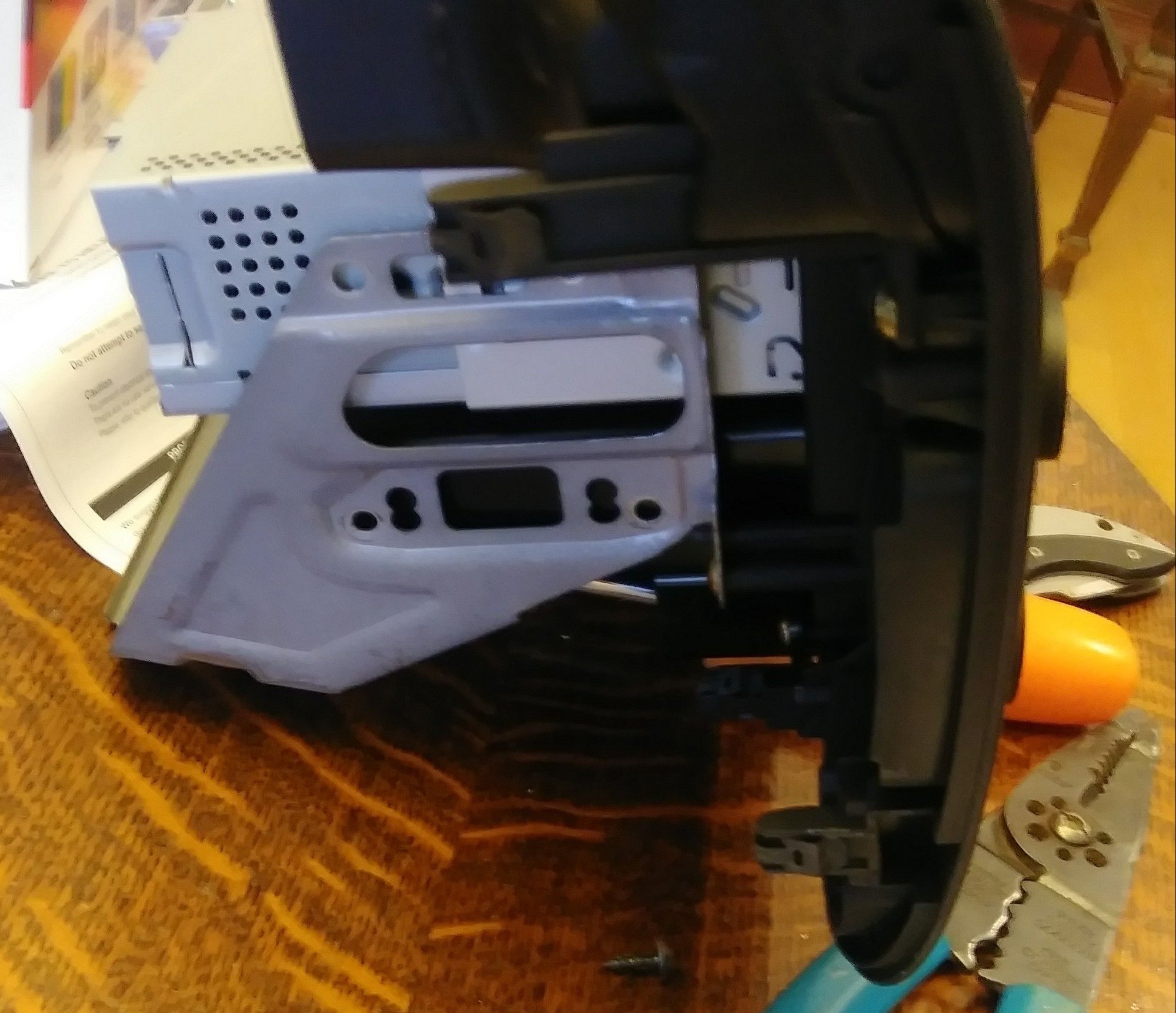

It is sweltering in southeast PA today and tomorrow and yesterday like an August day!
Halfway there everything popped out and apart like it's supposed to but it is a struggle. I heard something break but I couldn't find it I guess it was one of the clips.
After we had everything unplugged and out of the car I locked the car with the remote and it locked and it unlocked so I assume there is no connection between the radio and the security system. so I'm halfway there should finish tomorrow morning!
Old May 29, 2020 | 03:58 PM
Denise03's Avatar
Joined: May 2020
Posts: 52
Likes: 7
From: Bristol PA
I decided that the sleeve that came with the head unit is not necessary.
I did find a way to fix the loose AC vents!
