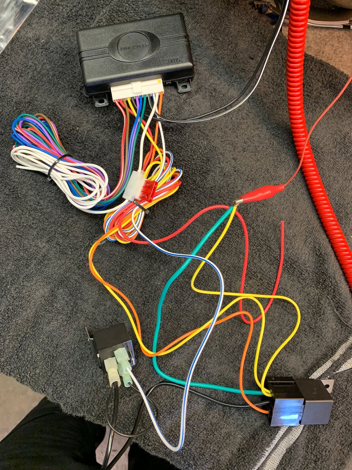

You need an extra SPDT automotive relay and a soldering iron.
There will usually be a few wires off the alarm that are not used. Usually auxiliary output wires. We are going to use two of these wires if available but one is fine too.

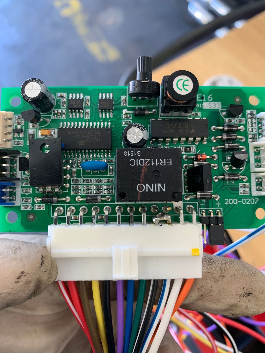

Open up the brain and cut the pins so that they are no longer connected to the circuit board. And solder the connector sides together so that the two wires make a loop inside the brain.
One of those wires will go to ground. And the other will go to the 2nd relay. If you only had 1 wire available, after cutting the circuit board side, solder it to the ground pin but don’t cut the ground circuit.
This is so that if the brain gets unplugged, the 2nd relay will lose its ground wire and the starter will not work.
It goes without saying that hiding the relays is an integral part of the installation. And the point at which the starter wires are connected to the vehicle, should be as hard to see and reach as possible because a determined thief will just reconnect the factory starter wires together.
That’s it. Should only take 10 or 15 minutes longer than usual but gives you an added layer of security without the hassle of a hidden toggle switch.
