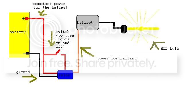

Old Apr 3, 2007 | 06:52 PM
skingfreak's Avatar
Posts: 828
From: Monroe, MI, USA
Default Re: (menappi)
<TABLE WIDTH="90%" CELLSPACING=0 CELLPADDING=0 ALIGN=CENTER><TR><TD>Quote, originally posted by menappi &raquo;</TD></TR><TR><TD CLASS="quote">edit...I believe it was home improvement..??? HAHA and I actually looked it up lol. </TD></TR></TABLE>
You are correct
<TABLE WIDTH="90%" CELLSPACING=0 CELLPADDING=0 ALIGN=CENTER><TR><TD>Quote, originally posted by menappi &raquo;</TD></TR><TR><TD CLASS="quote"> So once I get one of these machines, I just hooke the ballasts up to the red and black the same way they woudl be wired to headlights and that's that? Nothing to worry about..?</TD></TR></TABLE>
You have it somewhat correct, you have your positive(red) and negative (black) but you also have a switch (the part that plugs into your headlight socket) which depending on the kit, will have a headight socket already on there, or just two wires, in the case of the two wires, you just ground one, and power the other.
Now i just thought of something else, and i dont feel like earsing what i just typed ^ (afraid i may forget this --&gt but if memory serves me correct, in each kit you get a wiring harness which gets hooked upto your postive and negative posts on your battery (or another ground, which is recomended ) and the headlight socket ....well if you take one of these wiring harness (easiset may be from an h1 kit, since it just has the two bare wires) and do the positive and negative connections and hook the black wire from the headlight socket lead to ground, and hook the white (or what ever the positive wire color is) to a swtich that is hooked upto VCC (postive battery post for testing purpouses) you should be able to just hook up each ballast and bulb to test.
if i were doing that is how i would do it
sorry for rambling on, hopefully you can follow that.
EDIT: here is a picture for reference
Modified by skingfreak at 6:57 PM 4/4/2007
