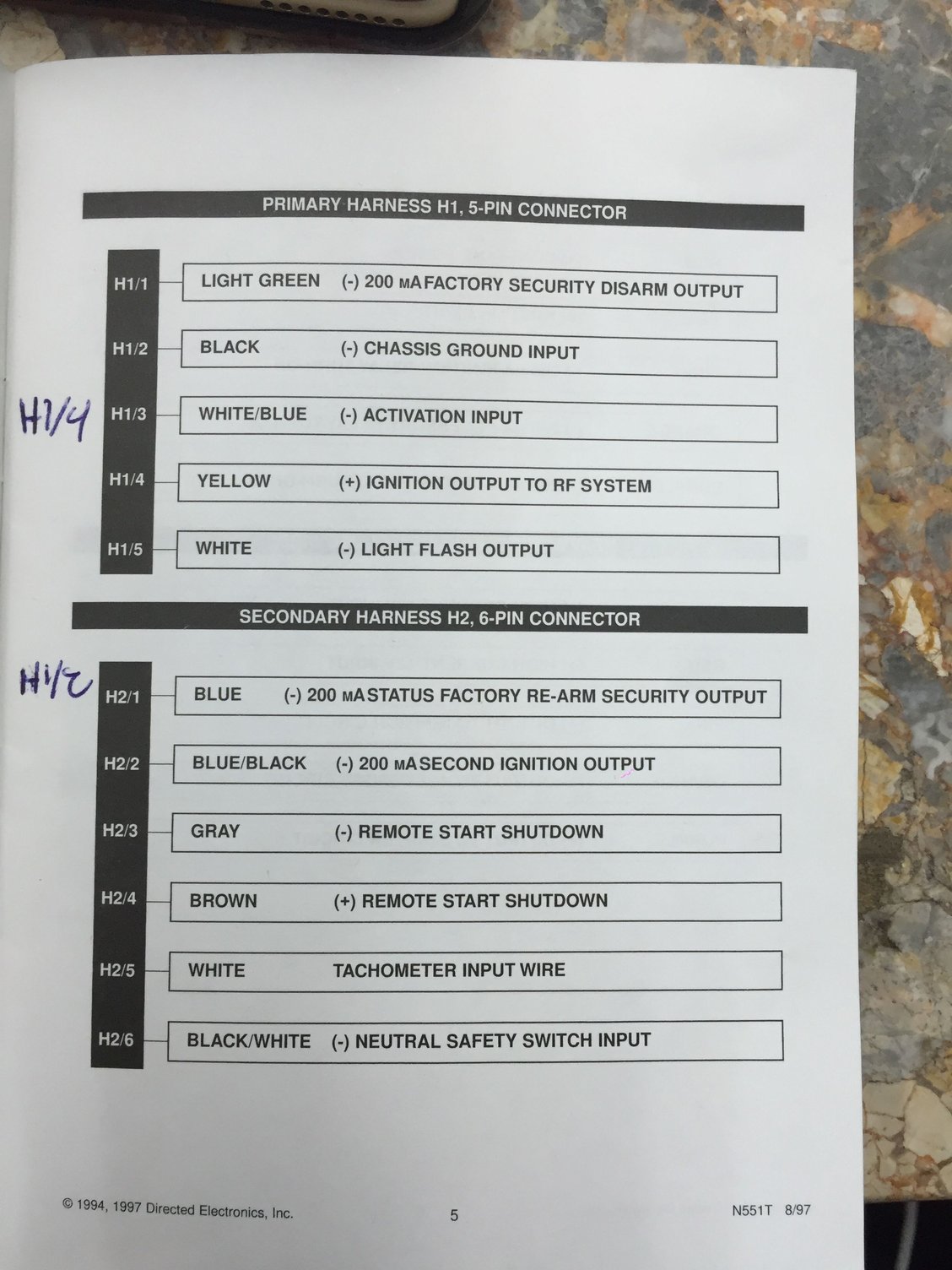

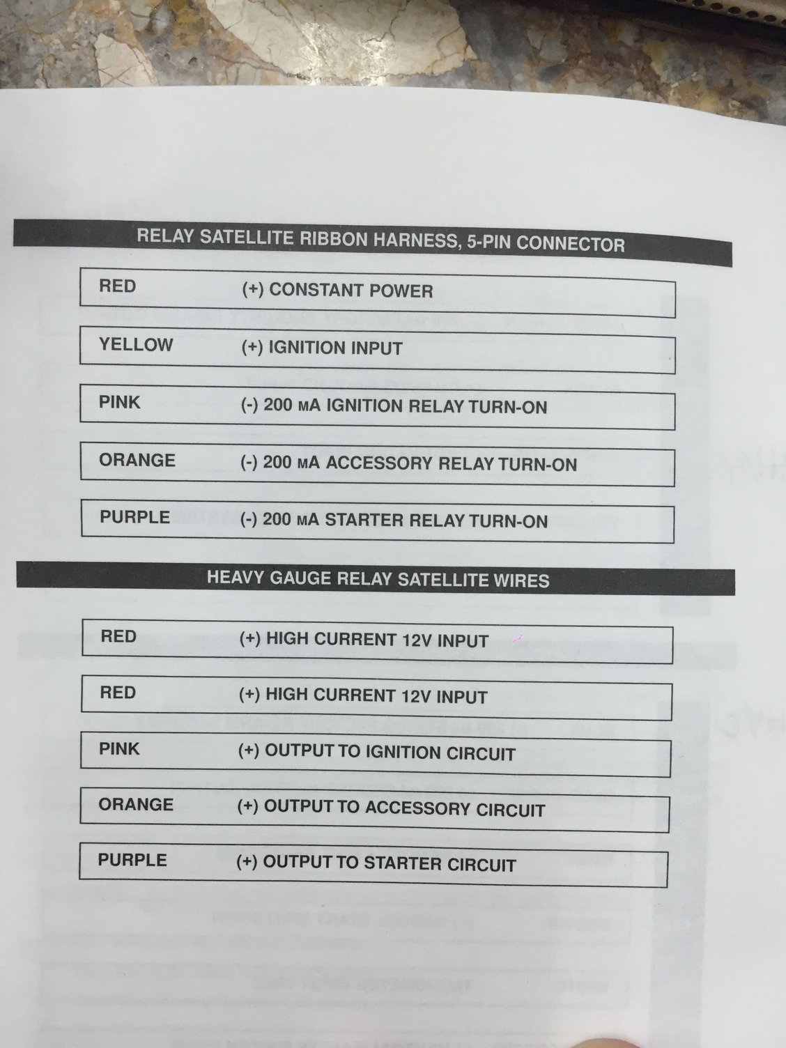

Hello everyone, so I am wanting to install a remote start system in my car without a keyless entry due to I already have a factory one, please help me with the wiring as I do not want to miswire anything.... Here is the wiring diagram for the alarm system, please tell me where to connect these wires to. 2001 Honda Accord V6 EX-L and is it possible to tie this into the factory alarm? Or do I have to put in a keyless entry too?

Don't take this the wrong way, but.....let a professional installer do the install.
