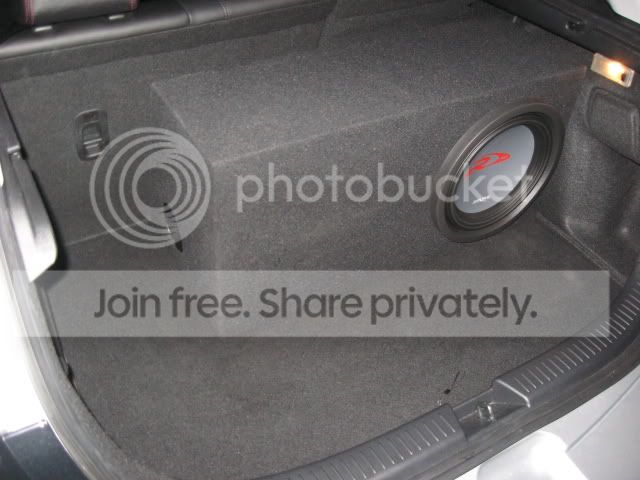

Old Oct 11, 2010 | 09:38 PM
EG-SIXV-TEC's Avatar
Joined: Dec 2008
Posts: 748
From: USA, someplace in CA
Post Re: Help 12inch SUB BUZZING sound?
Originally Posted by joeymc13
Have you tried what mhart said yet? pushing in on the cone of the sub, and listen for a scratching sound? (make sure your stereo is off.) If a seal on your box has broken loose, you can here strange sounds also. At this point, the easiest thing to do would be to see if you can borrow a known good sub, and put it in that box. If it still makes the noise, its your box. If not, then its prob a voice coil on your sub.
i found out the problem first i took the sub out, and it had no buzzing noise. i pressed it in straight up/down its good. but only made a weird sound if i press it in an angle position. i pressed or when i moved the sub box it made a noise i pressed it slightly and it seemed that the ported box is bad. i took it to a stereo shop and they checked everything again i wanted to make sure. the noise was really weird even they taught it was a blown speaker.
i bought a new speaker box that made to alpine type r specs. the box was the problem. the old speaker box was seperating/
