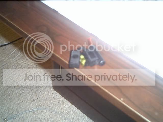

im trying to hook up my system and the wire that goes from the battery to the amp, i accidently broke it off where the fuse is placed..is it ok to use the wire still without that fuse peice?
thats the fuse peice i broke off..sorry for bad pic

you can still use the wire but you need to replace the fuse section. It's there for a reason.

so i gotta buy a new one or i can use it without the fuse?

Yeah you can use it without the fuse, but not recommended. Electrical surge goes through the wire and say good bye to whatever's on the other end of the wire.

Surges aren't the main reason the fuses exist, and there is a lot to worry about without a fuse in line.
Scenario: Run a power wire directly to the trunk of a car from the battery. You decide to move a heavy object around which pinches the wire, causing the metal core to touch the chassis (ground). Without a fuse, there is nothing to protect things from going bad.. real bad.
This happened to a friend of mine while we were working on his car. One of the wires became pinched under a bolt, shorting out the system without a fuse in line. As a result, the wire instantly became HOT, smoking (almost burning) the carpet above it. There is no doubt the vehicle would have caught on fire either by the heat or battery exploding if we didn't take the bolt cutters and sever the wire.
The fuse MUST BE located next to the battery, not in the trunk. If the wire becomes sliced by the sheetmetal in the firewall, the same thing will happen. Your equipment is the last thing to worry about.
Just spend a few bucks for a good fuseholder. It is much cheaper than claiming fire damage on your car!
