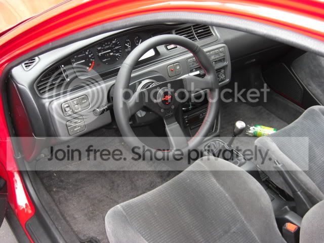

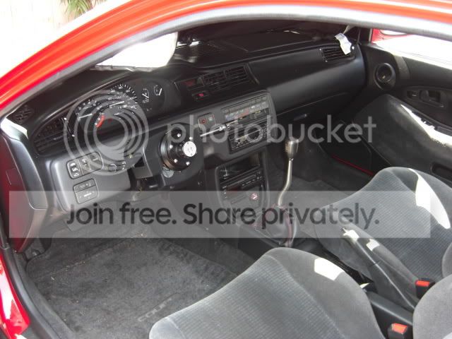

Got a few things done...

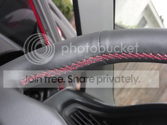

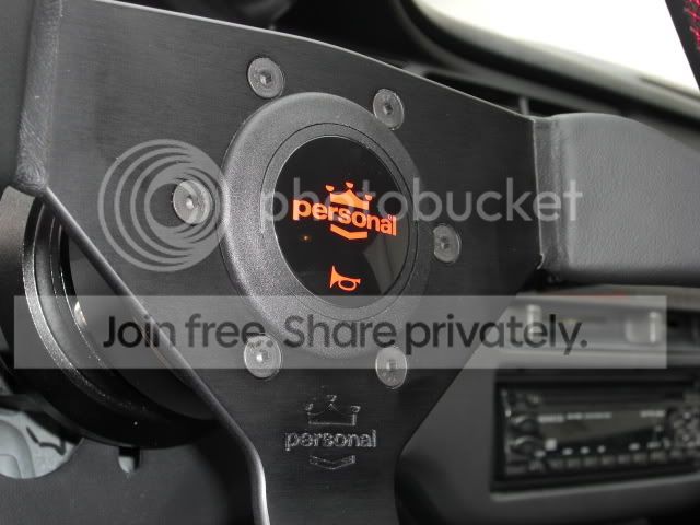

Steering wheel in (no write up or process pix, sorry)
Steering wheel detail:

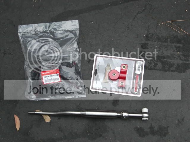

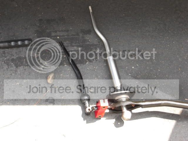

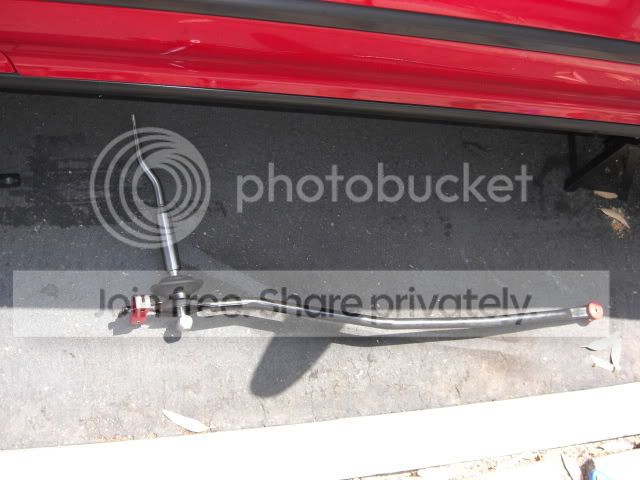

Now some random goodies...
Here's everything off the car... Not so much fun when you only have two jack-stands and about 10" clearance under the car
And a little comparison to the stock unit:

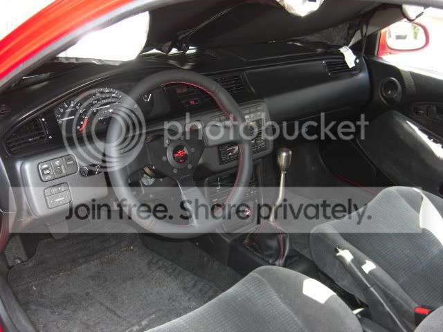

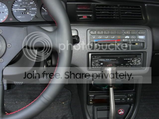

and a few 'after' pix (note the Type R shift boot installed as well):
First gear:
Second gear:
(not really good to show how much closer it really is, sorry

<TABLE WIDTH="90%" CELLSPACING=0 CELLPADDING=0 ALIGN=CENTER><TR><TD>Quote, originally posted by BR0KENB20 &raquo;</TD></TR><TR><TD CLASS="quote">that shifter is pretty cool</TD></TR></TABLE>
FastLine Performance. Its weighted and has the same throw ratio as a gsr/type r shifter, which is considerably shorter than the stock single-bend. Shifting is easy as hell with it, since it's weighted so well... For anyone that's played baseball, it's like warming up with a donut on the bat, then taking it off to actually bat. It's light, easy, and smooth.

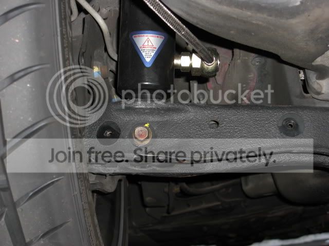

Well, update as of today is my ASR swaybar kit does NOT work for my car. It crosses up and over the LCA *right* where the reservoir fitting comes out of the bottom of the shock (can only be mounted inward, can't make it face backwards ) Pic for reference:
It really won't make a huge difference anyway because I'm running 12k in the rear and it's nearly infinitely adjustable. I'll have to really drive it hard once everything else is on to determine what needs to be stiffened or softened (in terms of sways or springs). I should've waited on this part but I got a little to spend-happy. Well, live and learn. I may be going to 15s as well, so the first $1300 takes the wheels/tires (like 400 miles on them) and $300 takes the swaybar/subframe kit (partially installed, never used)

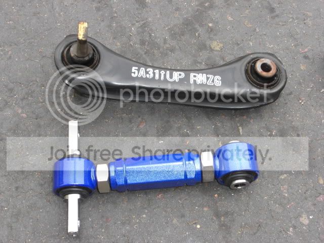

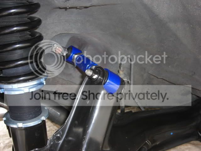

Well, I didn't get a whole lot done today... I ran out of time trying to install and eventually uninstall my ASR subframe brace/swaybar kit, so I finished putting the rear end to stock earlier. I went ahead and adjusted the rear coils up about 1/2" for handling purposes, and while I was at it, decided to install the GoodUSA rear camber kit.
Here's a comparison of the GoodUSA unit compared to the stock unit. it's difficult to tell, but it's a pretty sweet sparkling blue color with spherical bearings that have dust boots covering them.
and here it is installed: (for the time being, i just adjusted them to be the same length as the stock units, until I get an alignment)

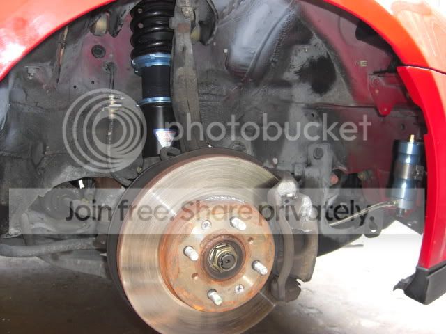

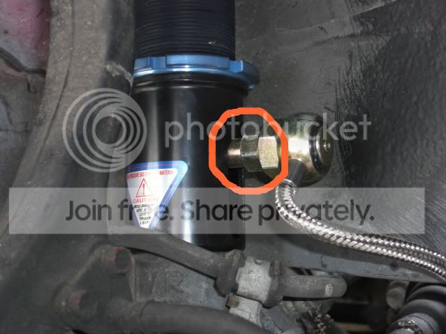

I also went ahead and raised the front suspension up as high as it would go. I didn't bother doing a before after shot of ride height, because the difference was about 5/16 - 3/8". The adjustments are limited because of the fitting for the reservoir. I took a pic and circled the part that shows the limited movement. Here it is, maxed out.
And another pic, just to show how everything's routed:
The driver's side is identical.
