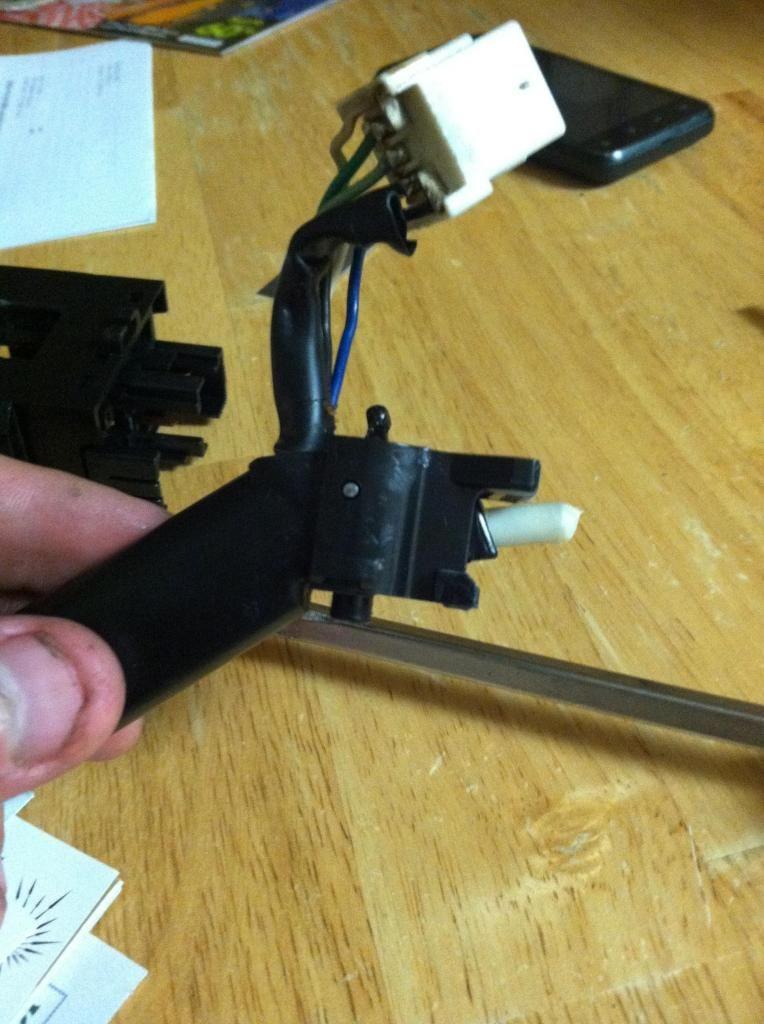

Using this write up, and electrical being my forte, I relocated my cruise controls from the steering wheel to the rear wiper switch. But wait! My sedan doesn't come with a rear wiper! Well you see, I went to try and find one off a 5th or 6th gen Civic hatch or Integra. But alas, I could not locate one. I did, however, find a couple of EFs with a (functioning) rear wiper switch. With a... discount, I managed to get it for what the entry fee costs for the yard. (shhh)
The wires weren't exactly the same color, being a couple gens and a model difference from the write up. I just read the wiring diagram and figured that **** out. Pics of the goods below...
The EF switch housing wasn't the exact same as the 6th gens...
EF switch:
EJ Sedan switch:
The EF housing is smaller. But its innards are the same. Here's how to get the switches in pieces I can work with.
The rear wiper controls are just an extra harness add to the inside of the switch.
Inside the EF switch:
So I take the housing of the EK, and the switch and rear side (?) cover of the EF and trim the screw holes a bit...
And it's done!
Just hit the 'wash' function either direction and it Sets the cruising speed. And I also figured out, I only have the Set/Decel function. I couldn't leave well enough alone, so I tried to disect the **** out of the wiper switch without actually cutting it open, to see if I could get the wires for both sides of the wash function separated so I could restore the Res/Accel function... It didn't really work out very well. The switch looks massacred, but it still works. I just need a new one for aesthetics.

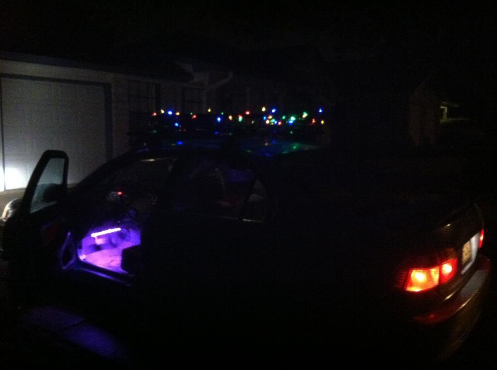

I figured since I could only use the Set function, I should do something with the Off/On part of the switch. So I got in some under dash lights I've had for... a year. Shitty pic, but you get the point:
I'm doing some under the dash and front seats (for the same-ish effect in the back seats) that's hooked up to the rear wiper switch. Except there's one thing I wanna add. You know the Dash Lights Brightness Controller? Next to the Main Cruise switch. Yea, that one there... Well, I never use it for it's intended purpose. So I'm going to do something with it. The lights under the rear seats are going to have brightness adjustment.
At first, I disconnected the harness from the switch and jumped the pins on the harness. I blew a fuse, and tried again, and blew another fuse. Sounds wasteful, but I keep extra fuses around, sue me. I figured I can't just connect the wires directly. So I'll put the switch that came on the car behind the dash, and have another OEM one for the rear lights. Sweeeet.
