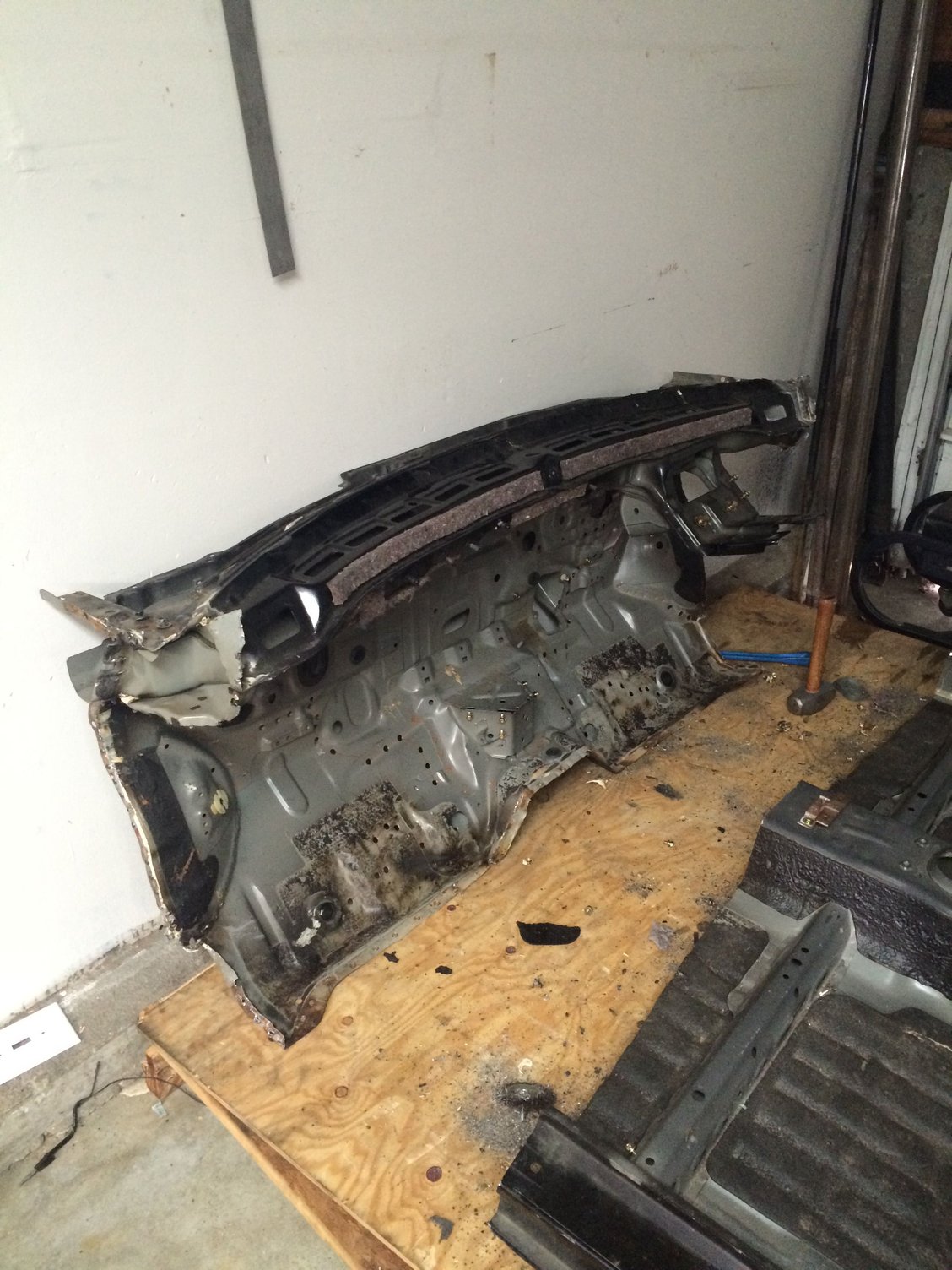

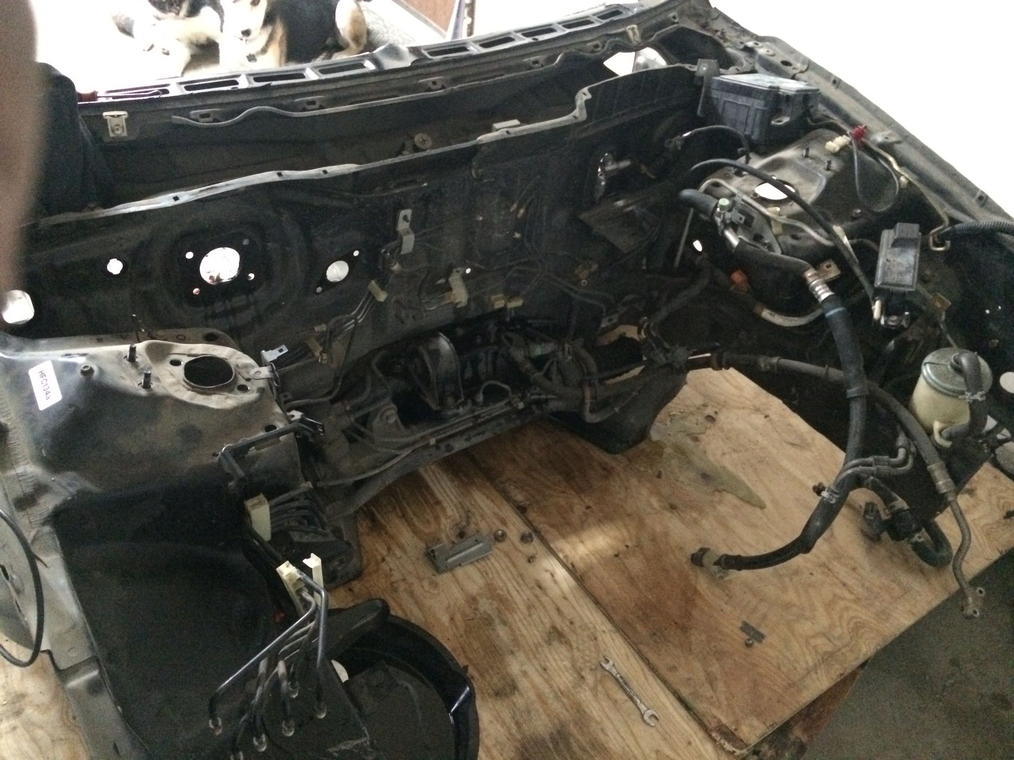

Stripping the engine bay.
Firewall Out.

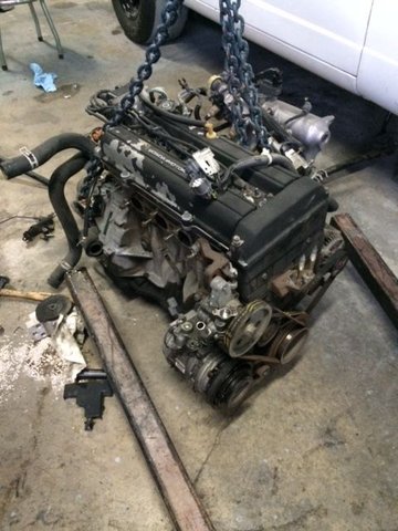

Quick update, the GSR actually arrived today! So, here's a quick pic before she gets torn down.
GSR Engine.
-Amp

Update: It looks like there could potentially be more damage than I thought. The guy I got the engine from said it smoked under vtec, provided a video, and it was dark smoke. But, I think the block may have a crack in it. Super unusual area for a crack to form so I guess I'll just wait to see what the machine shop says. By the way, I can catch it with a finger nail.
Possible crack?
-Amp

Update: Turns out the apparent "crack" was just a water mark. Not sure how, but hey, that's good news too me. Bad news though, that cylinder was hour glassed so I'll need to bore it .020 over. Pistons, rings and all new bearings ordered. I'll get pictures after it's back from the shop.
-Amp

Update: I got more done yesterday than I thought I would. Front bumper, fenders, front and rear glass, and both front doors are off. Rolling right along! I'm hoping to have the engine out this weekend but I've got a lot going on. Might not happen. Also, no more super large pictures... apologies. haha

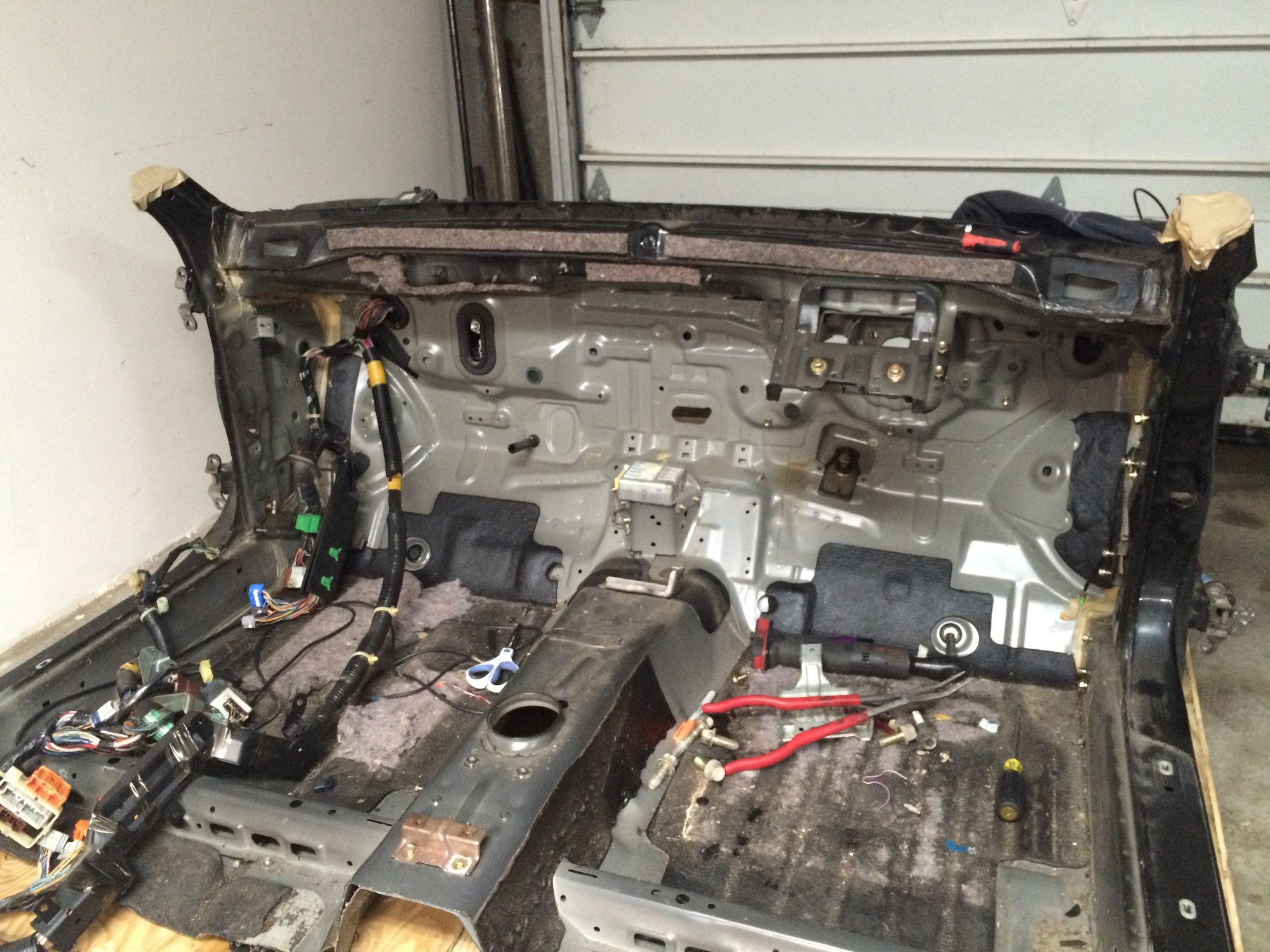

Update: Just a couple more pictures of it all coming apart. The rear quarter panel I'm actually really excited to have done.
-Amp

Update: Got the engine out, under dash components, more work to the back end, started cleaning up some metal parts.
Leave them blasted but clear coated or paint them black?
-Amp

Update: I know it's been a while since I've given an update, and unfortunately it will be a bit longer yet. I have a lot going on and don't really have time to get down to the shop right now. Here's the only thing that's happened between the last post and now.
Cleared up firewall
