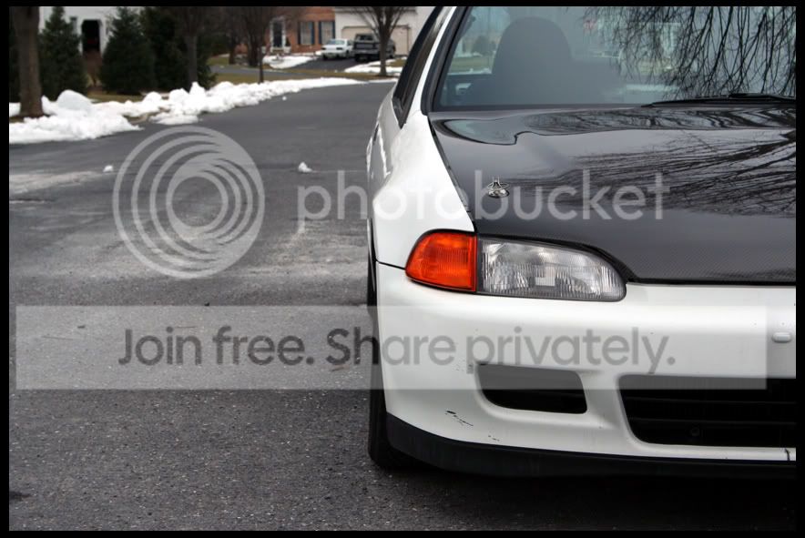

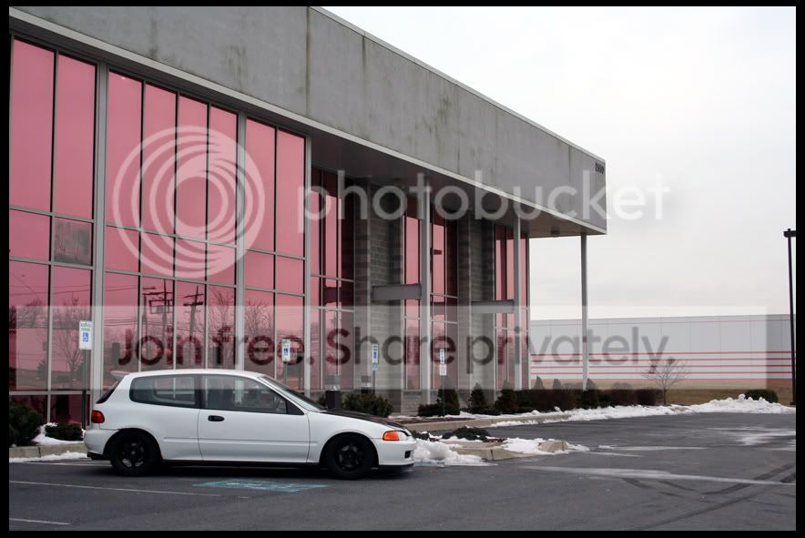

I just picked up this gem yesterday. Future plans include cams, valvetrain, headwork, pistons and rods.
It was very overcast today, almost zero sun, but I'll have better pics shortly once the weather clears.

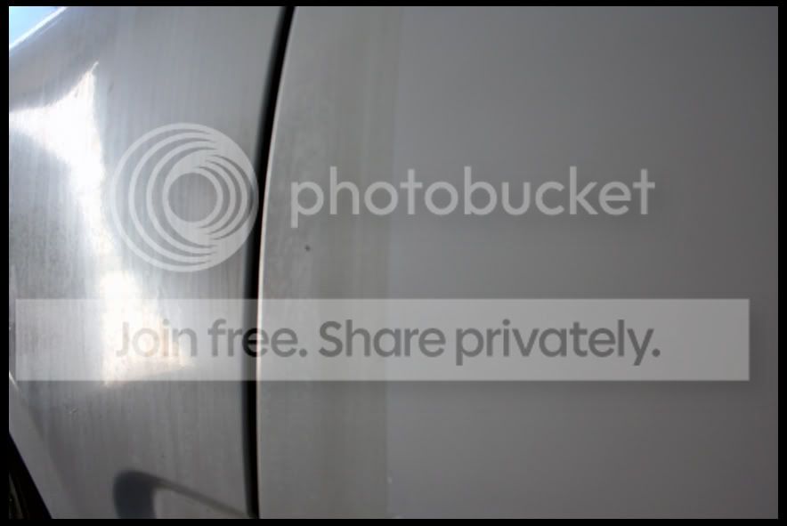

Pics from 2-17-08 You can see the before/after detail
Enjoy

Awsome pics. I wish I still had my white hatch
What's the goal for it?

Very nice.

Track use and to promote our company. The brake & suspension setup is already nicely dialed in (Koni/GC combo 450F/550R with GSR brake upgrade front and rear. Hawk HP+ pads, GSR front sway bar, ITR rear sway bar, Beaks subframe brace). It just needs some more power and a cage It's just a stock GSR swap for now with I/H/E.

Is something horribly wrong with the drive side?

Haha, just noticed that. Nope not at all. It's just the locations today and the time of day didn't allow for good driver side shots at all.

amazing wat water n soap can do

The effect of the light on the windows is pretty cool...looks like a nice project as well, good luck with it.

Needed much more than what soap and water could ever do. Started off with covering the entire car in a degreasing solution, then a hand wash, then washed the entire car in solvent (except for the CF). Buffed with some intensive compound, polish, then waxed.
