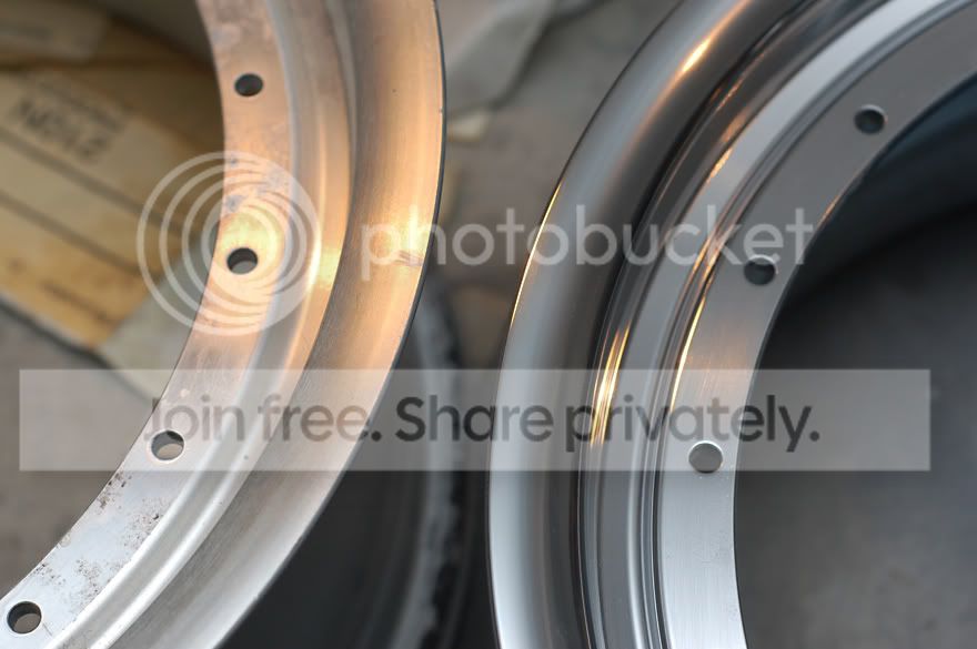

i've had these BBS' sitting around for a while now. i got the idea to do a full/well half polish on them. here is the progress.....
how they look before
now during the process
one of the lips polished
before and after
now one of the wheels polished, but not yet painted
they are going to be painted silver like before.....you can see the area where they are going to be painted.....

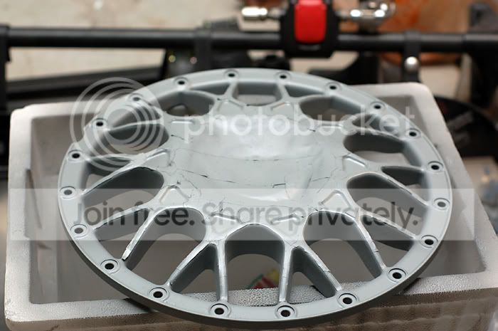

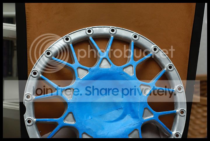

all masked off, starting the first coat of primer right now....

cool, but there's some shakey lines on that mask job, good luck!
Old Nov 29, 2007 | 03:35 PM
95greenlude's Avatar
Posts: 2,930
From: Las Vegas, NV
Default Re: (99_hb_on_air)
^doesnt matter
paint/primer wont stick to a polished surface, just use a little fine steel wool to get off the paint

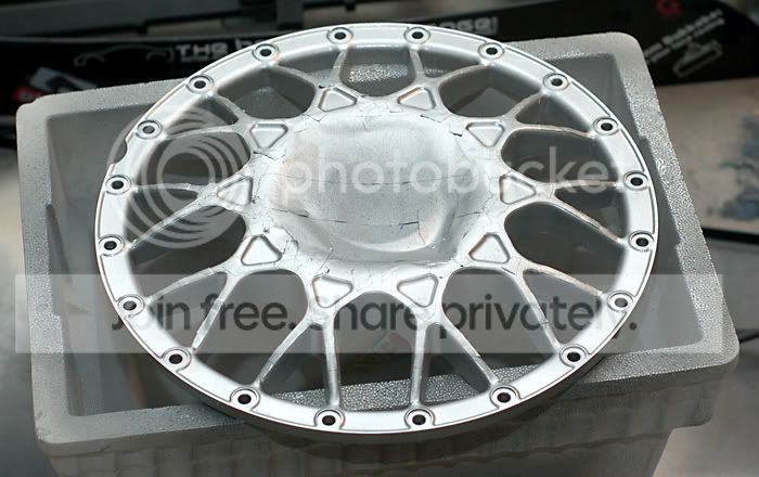

after 3 coats of primer....
will start painting after i get back from the gym!

2 coats of silver paint, one more to go.....then 2 coats of clear and the tape can come off.....
