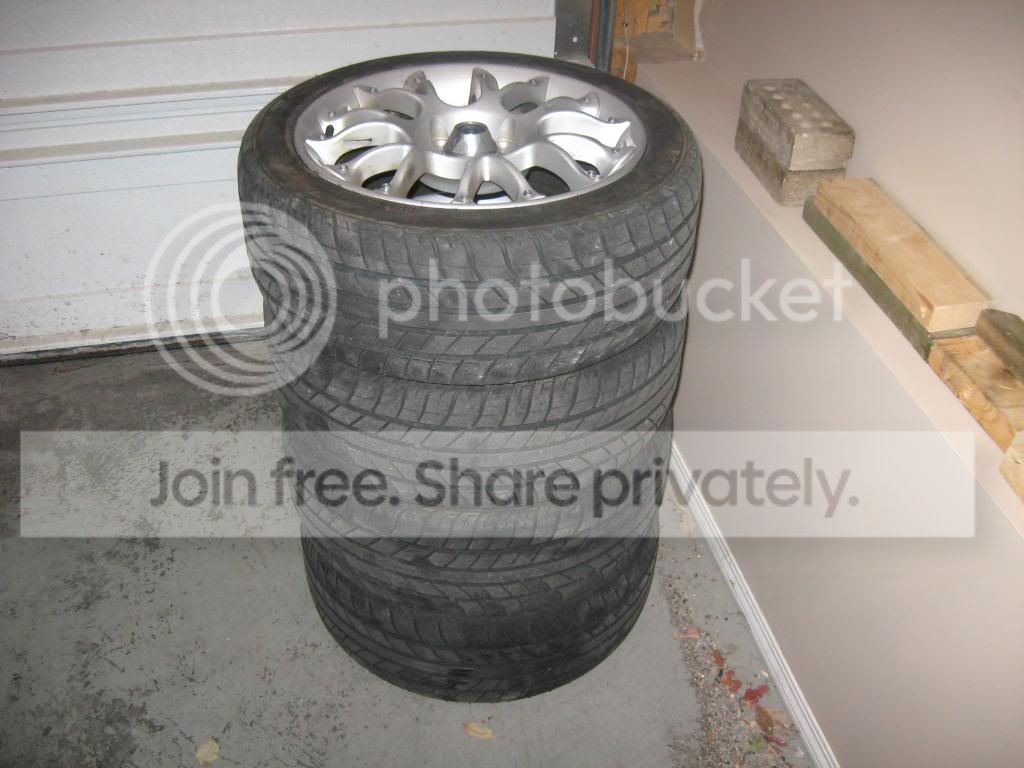

The summer wheels and tires will be for sale shortly as will the winter steelies with Michelin X-Ice rubber as I don't need them.

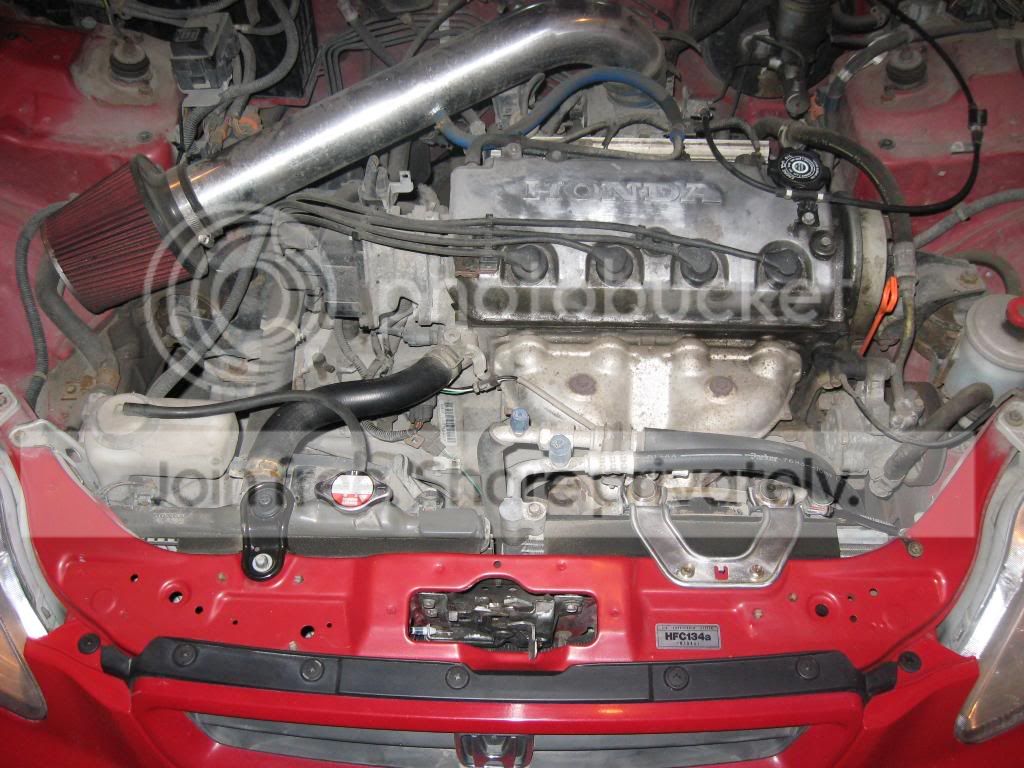

Ebay special short ram

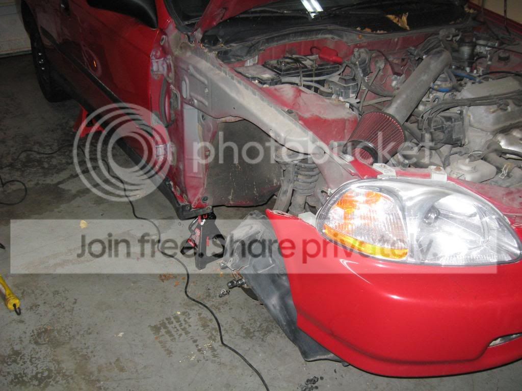

Passenger fender bent in, will probably try and bang it back out fairly soon

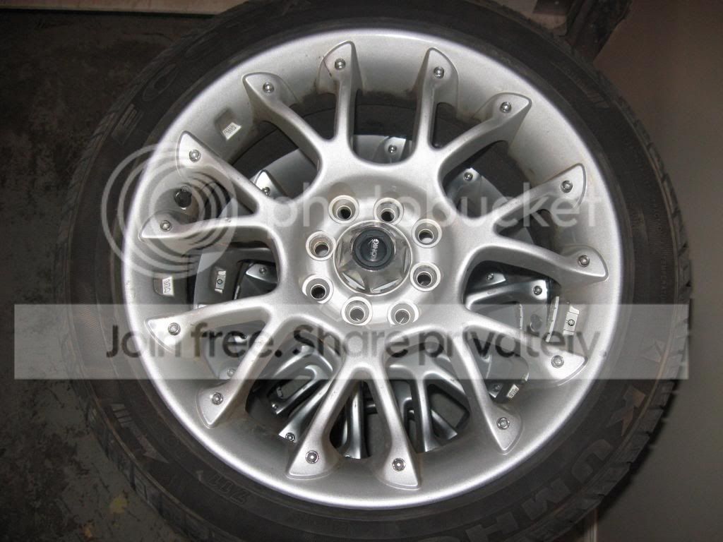

One of the Konig rims and driver side

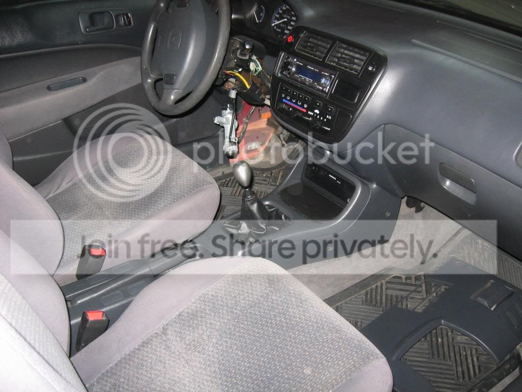

Wonderful busted steering column as it was stolen not so long ago
So here is the starting point!
Looking to fix the steering column fairly soon, let me know if anyone is selling a good condition used one.

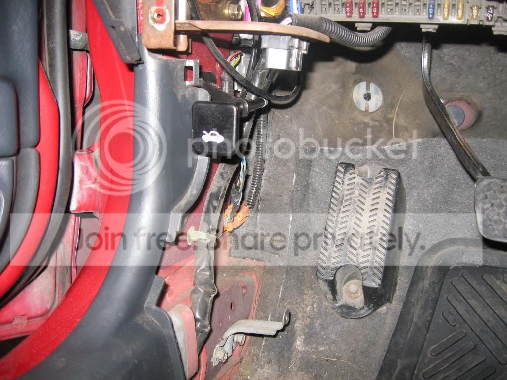

The brake lights aren't coming on but the night lights are so I need to look at some fuses

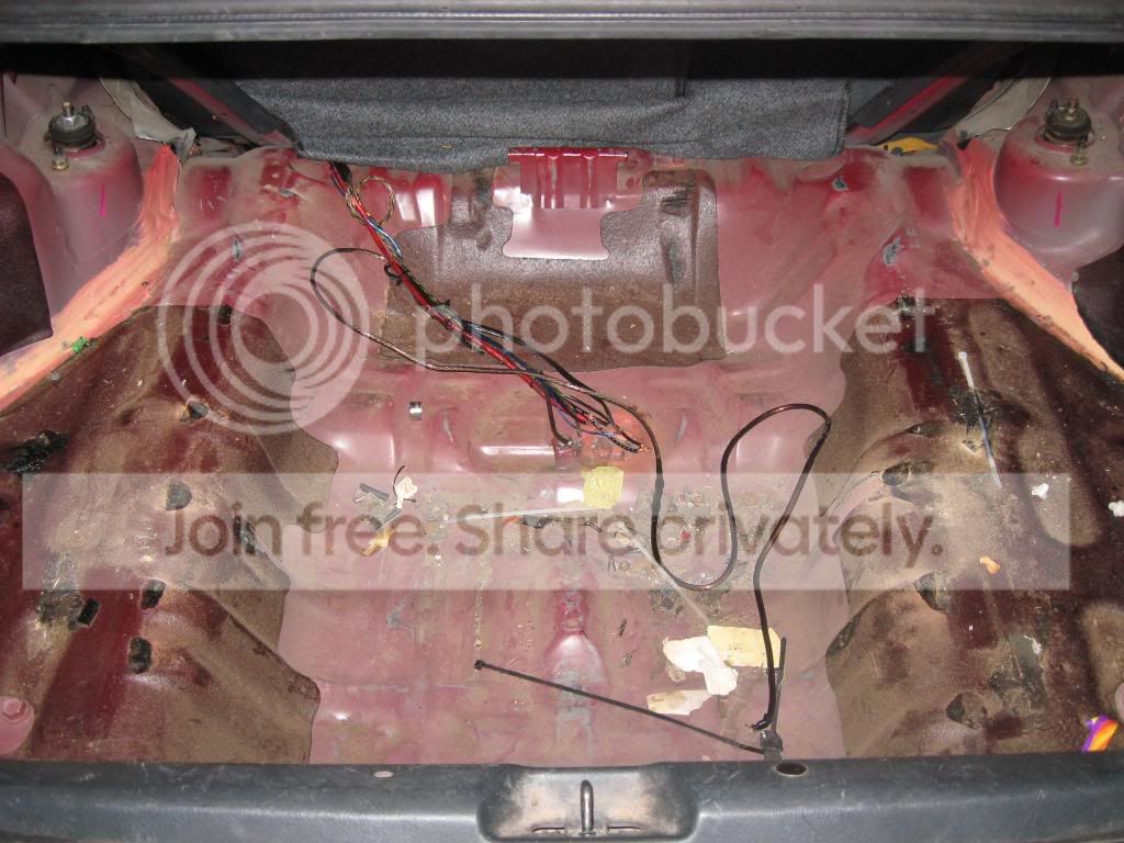

Trunk cannot be opened from the cabin and the trunk light is on so will be fixing that soon.
The hood level to release the latch is broken off so that will be changed out as well.

The trunk latch now opens from inside as it should, the passenger fender has been removed and I will try and straighten it out a bit before throwing it back on the car.
Removed the riced out **** that was cracking and was just wiggling around and started removing the carpet in the trunk to clean everything up.

Also removed the winters and sold them.
I am not sure what konig rims these are but they are 16's wrapped in 205/45/R16 Kumho 711's with some decent thread left. These are up for sale locally.

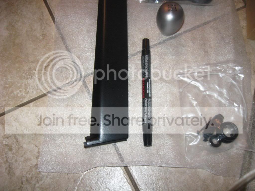

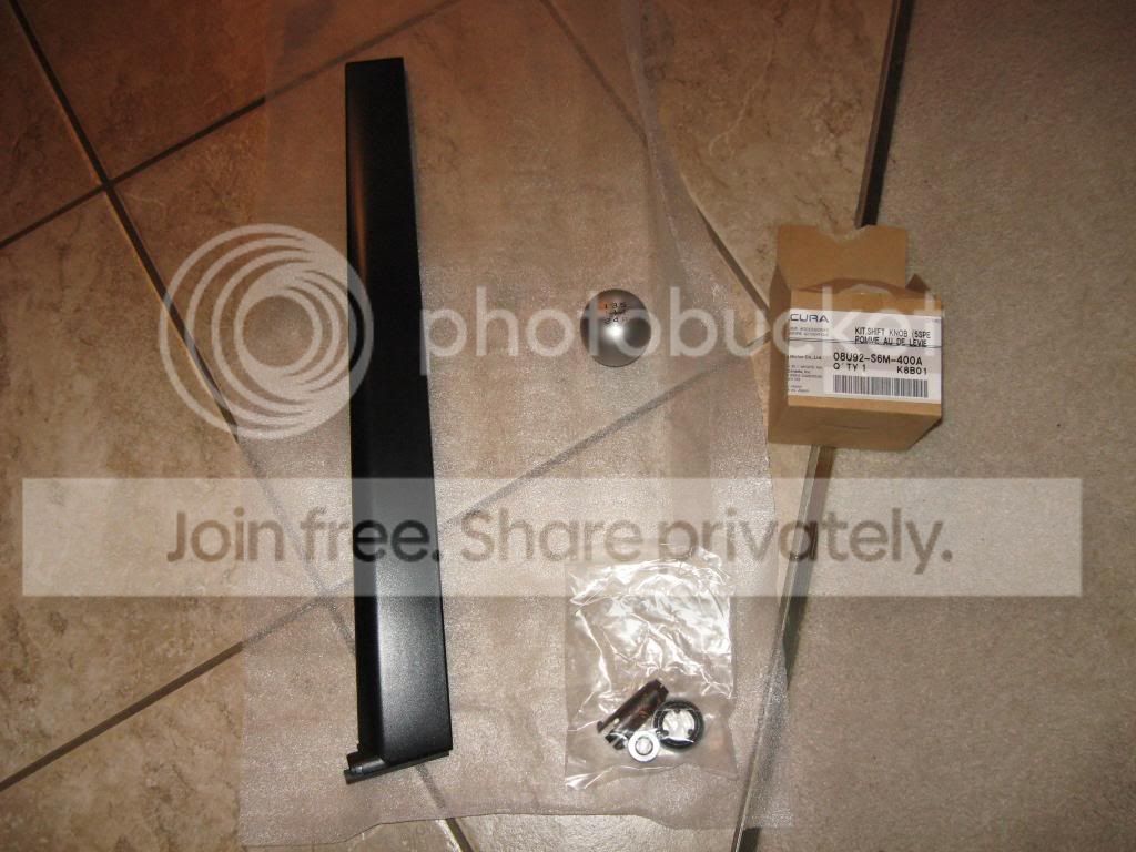

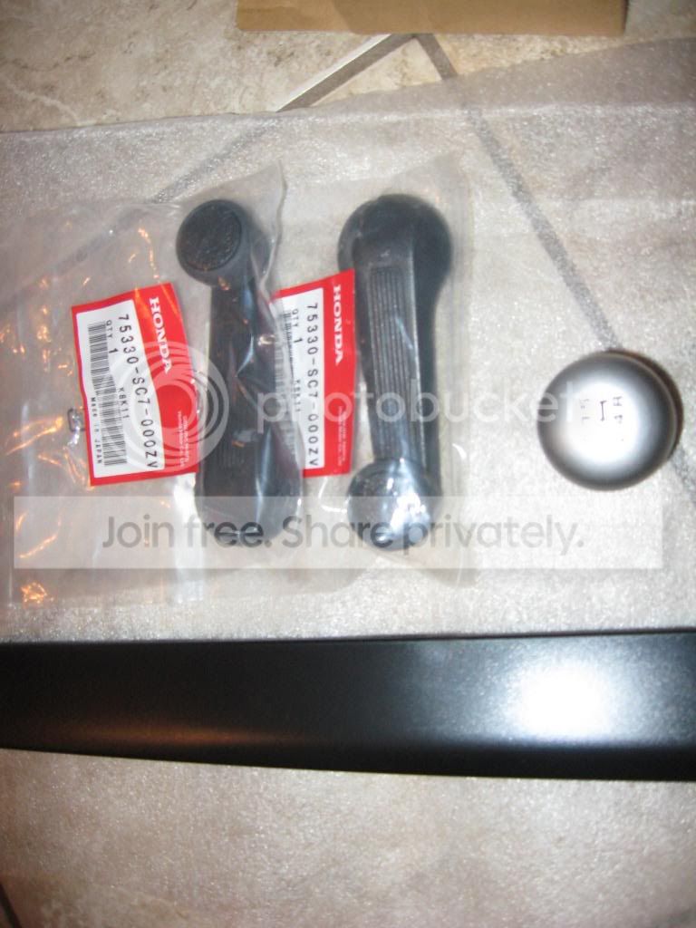

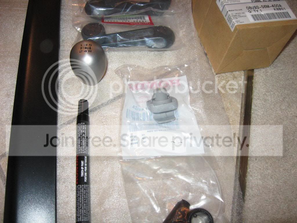

Picked up some OEM parts:

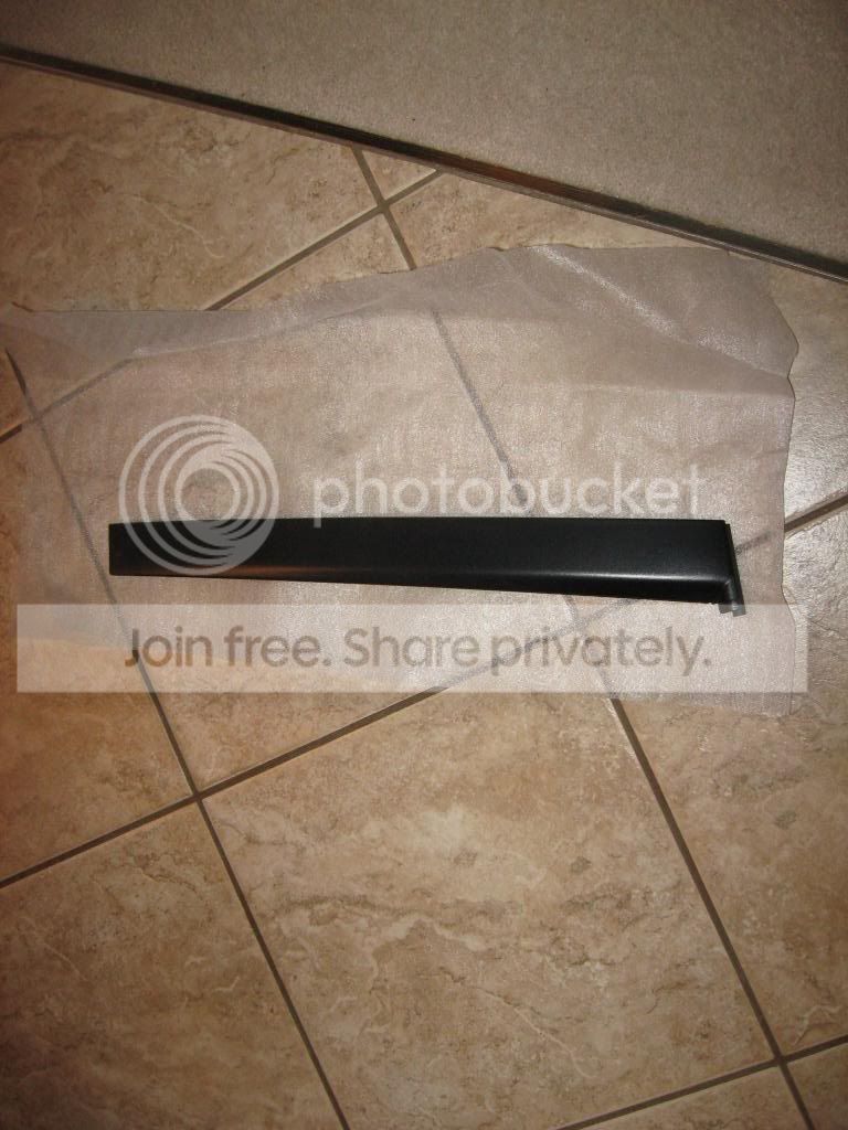

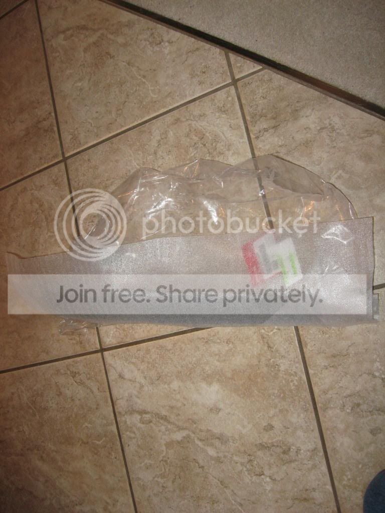

Plastic window piece

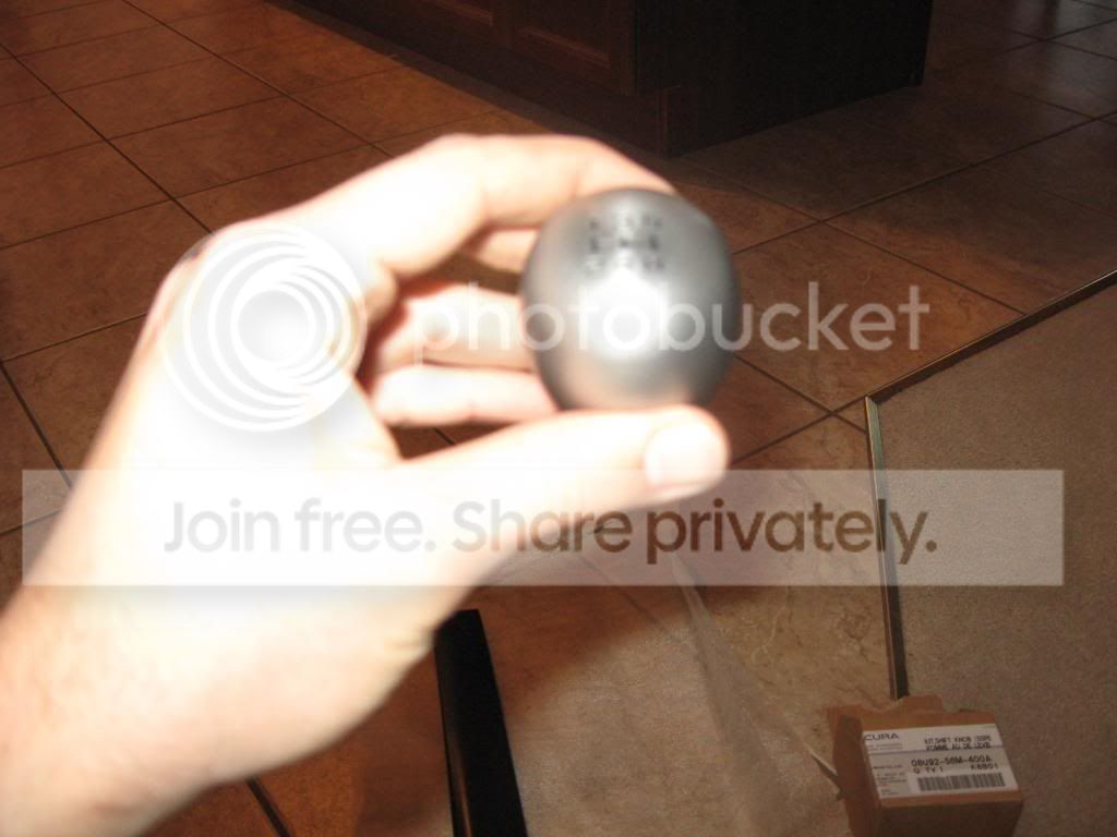

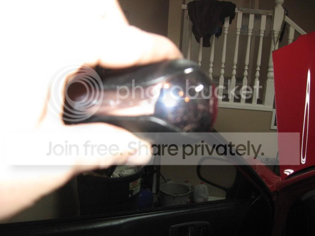

Acura OEM Shift ****
Manual window levers
touch up pen
Clip for sunvisor that was broken
hood latch cable
This was the missing piece on the door

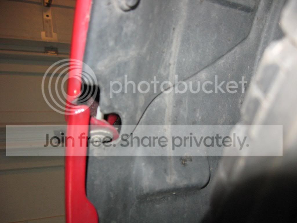

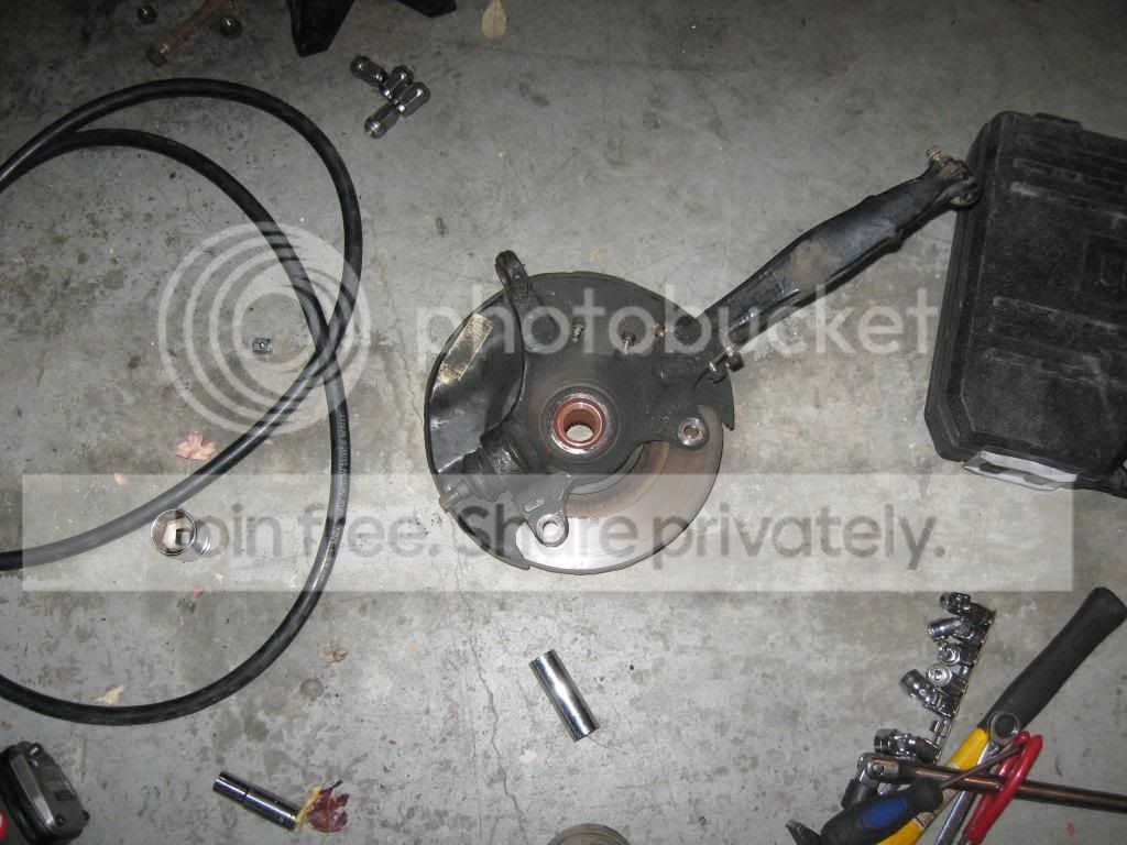

Driver side axle had a ripped boot and I wanted to change it but the axle nut was on so tight it broke 2 reducers from 3/4 to 1/2 inch and my impact wasn't taking it off. Tried a 5 foot long breaker bar and even jumping on it did nothing.
So I removed the whole assembly and had a friend at Honda impact it off with a stronger gun
Good to go back on!

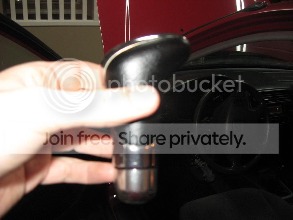

New shift **** installed

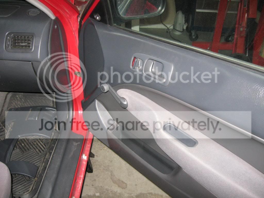

new window levers installed
new door piece trim installed

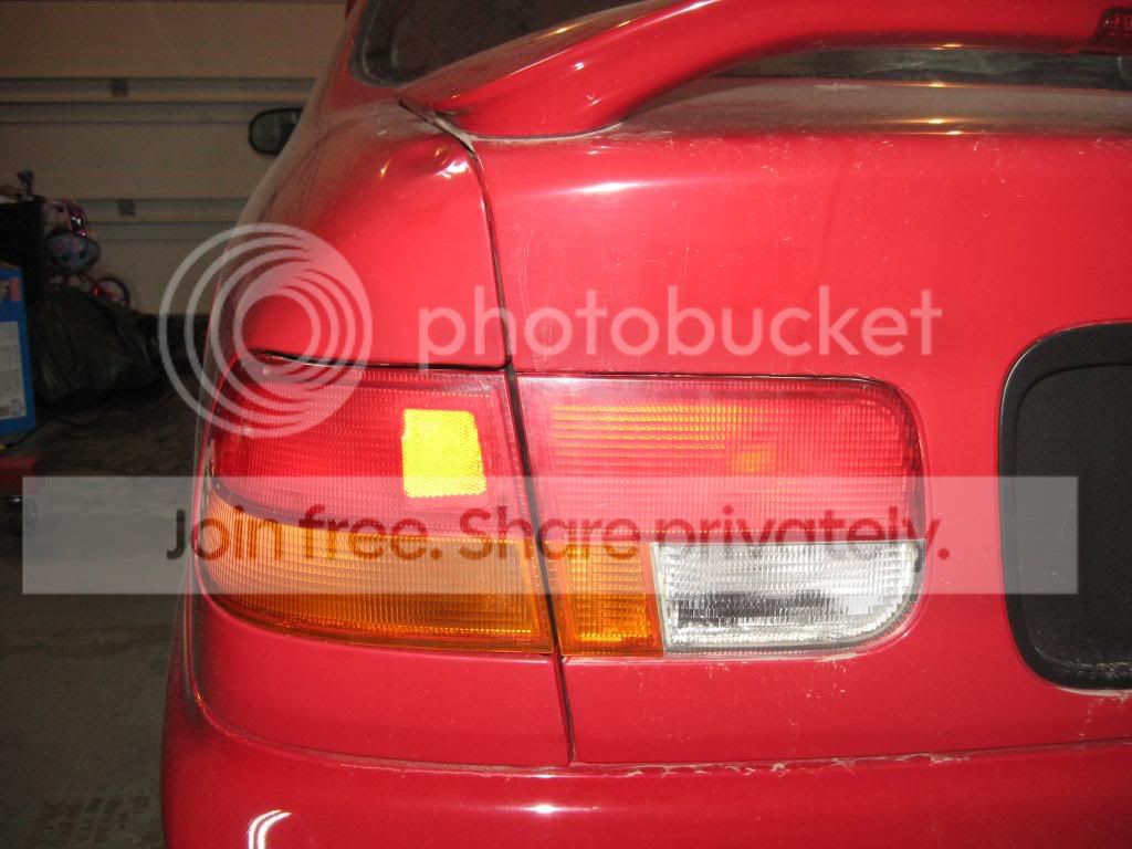

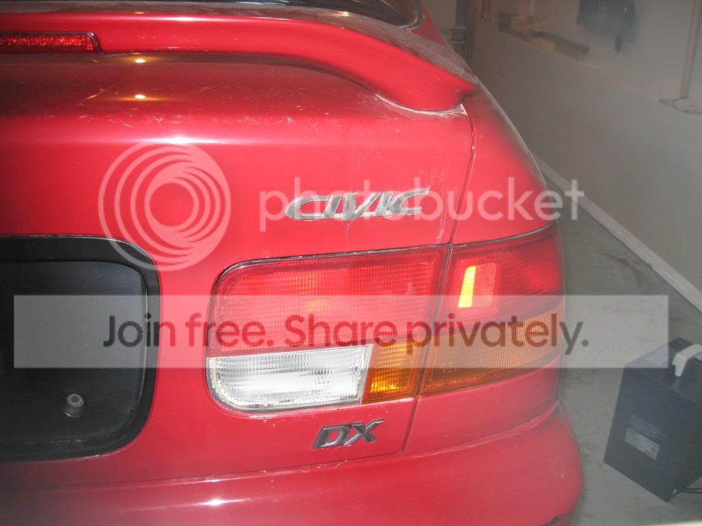

That's it for tonight but I found a mint set of OEM 98 tailights with harnesses at PNP today so will install those in a bit.

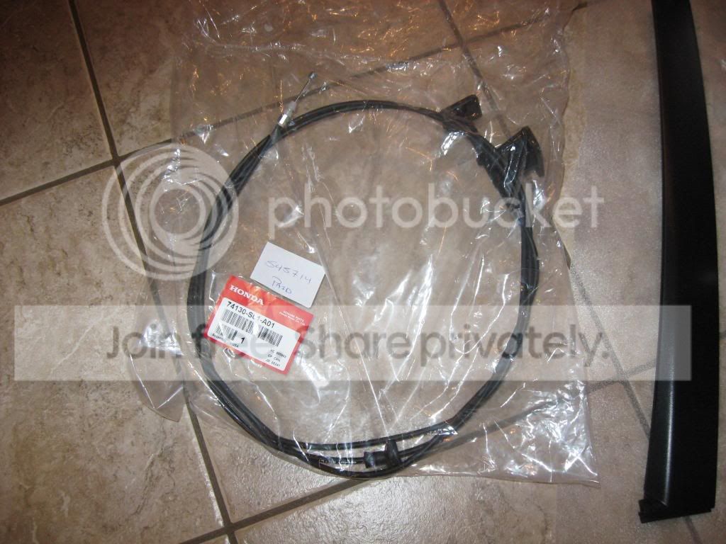

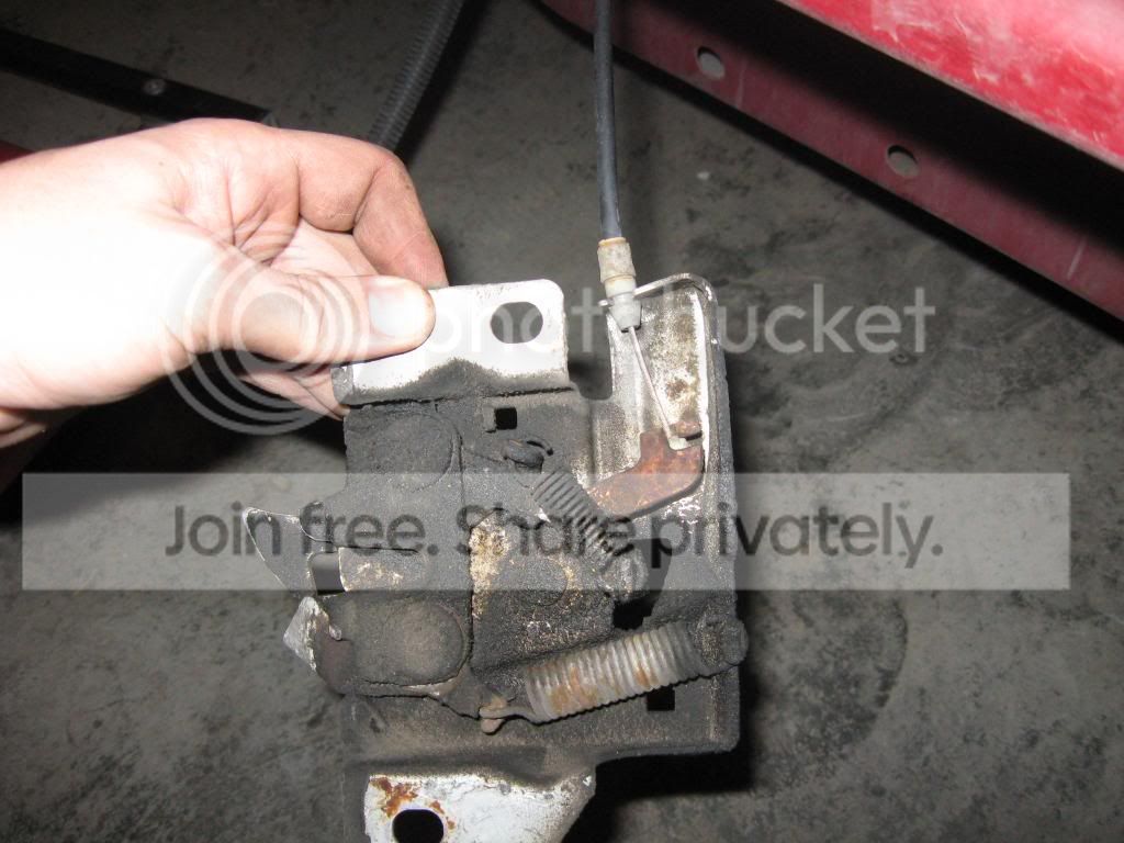

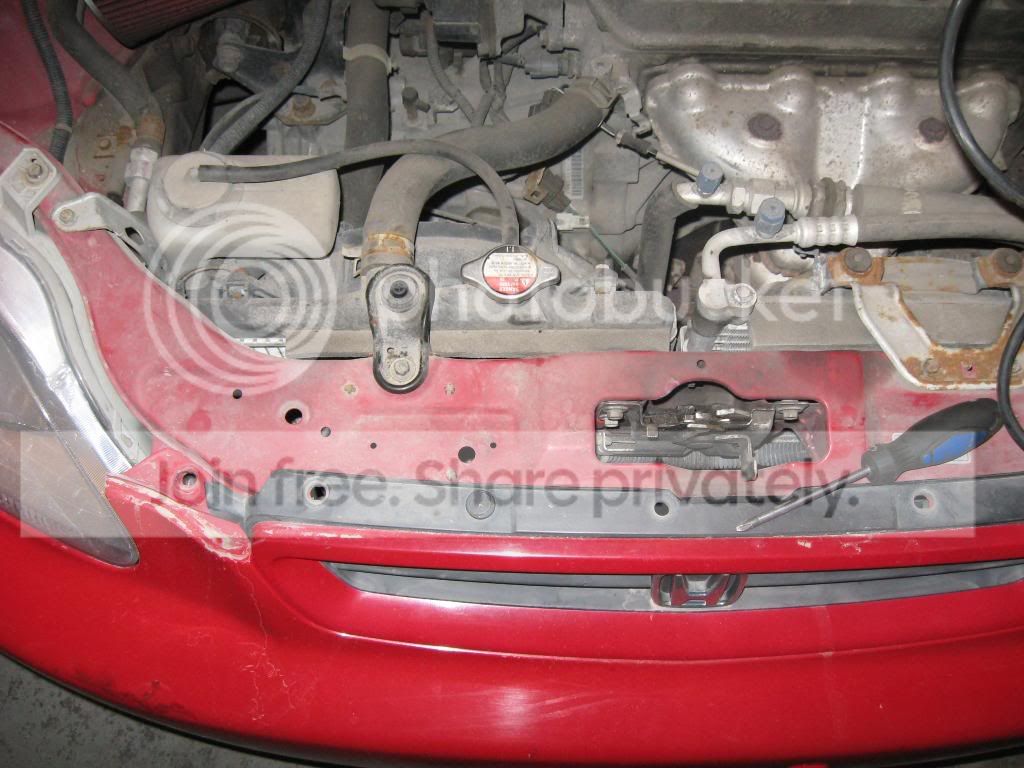

Spent some time yesterday replacing my hood latch. Took too many pics but some folks may appreciate this little writeup when comes time to replace theirs.

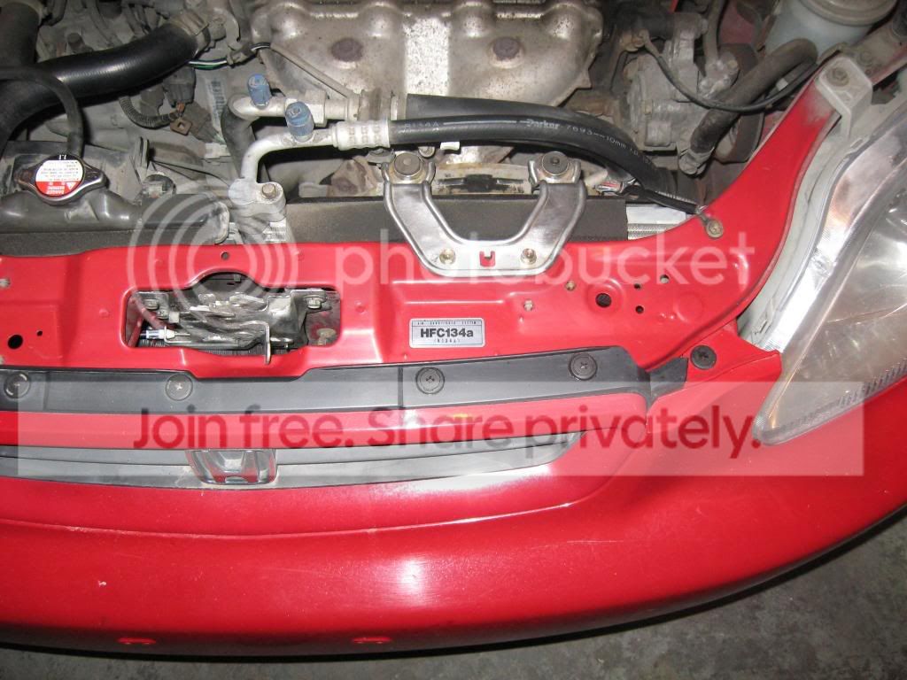

Here is what I started with
First remove the front bumper

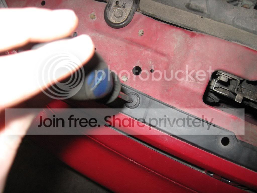

Remove the plastic clips with a philips screw driver
Then, where the bumper meets the fender, remove the philips screw on each side
Then remove the 2 screws holding the bumper under the car

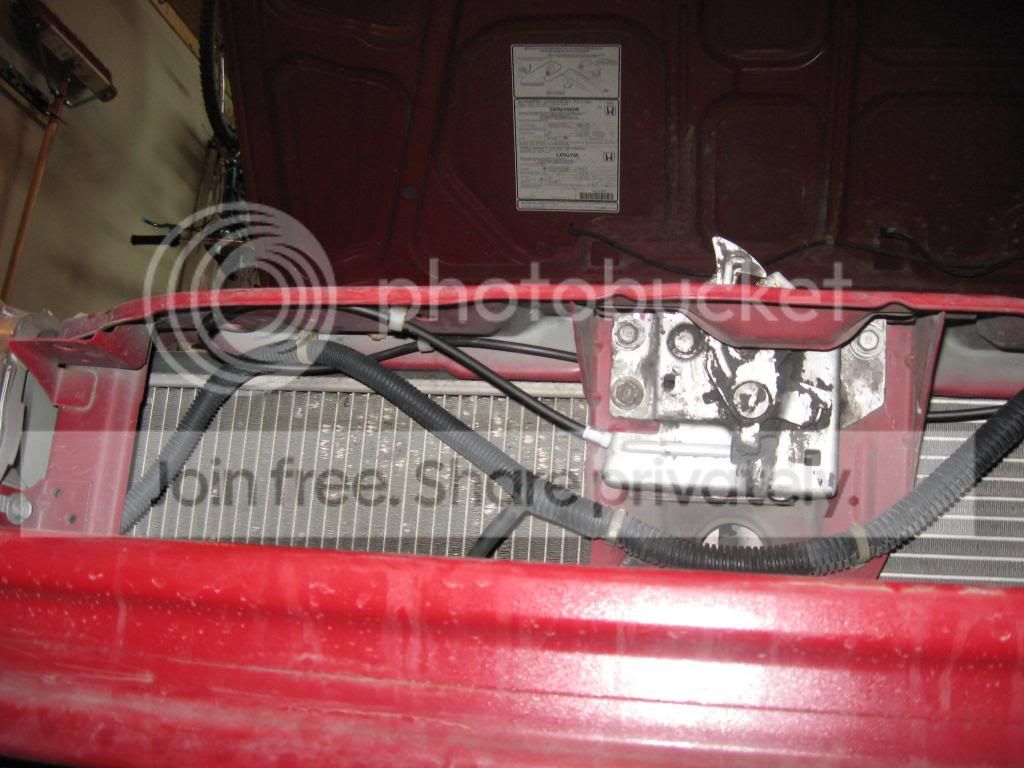

Here is what things will look like with the bumper off

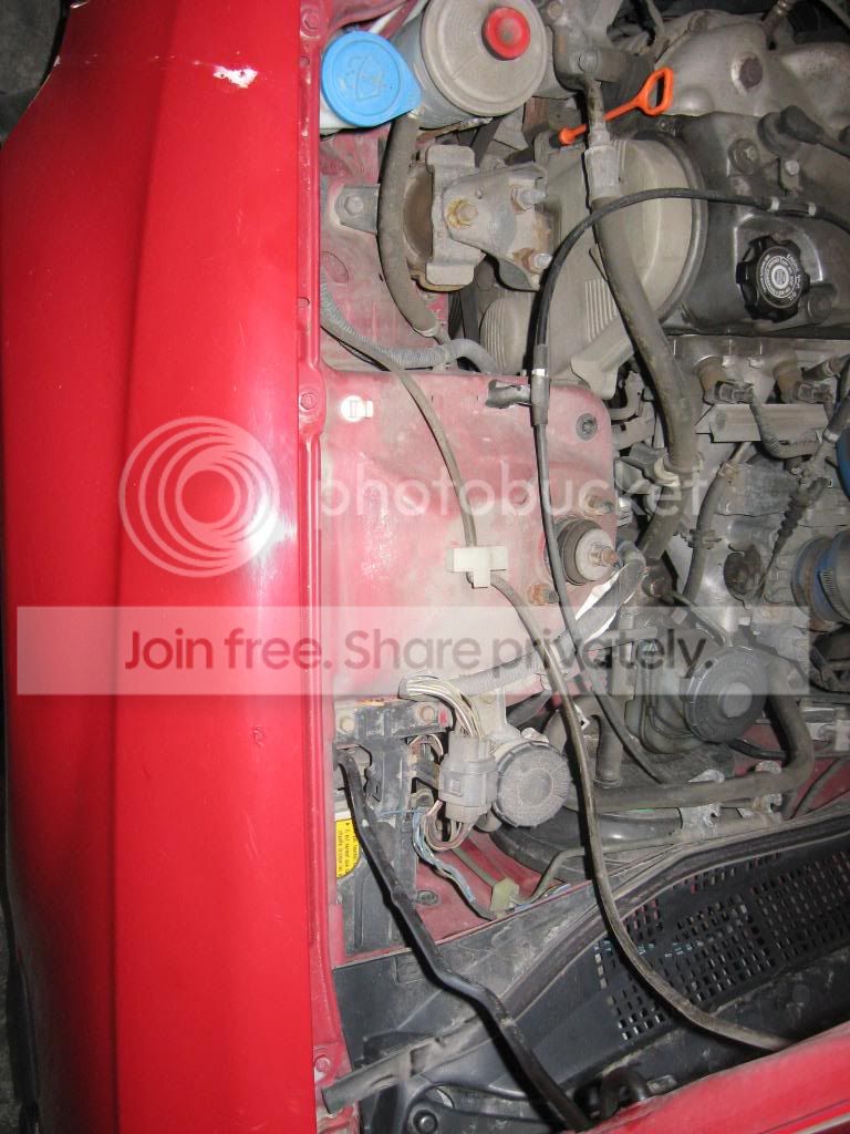

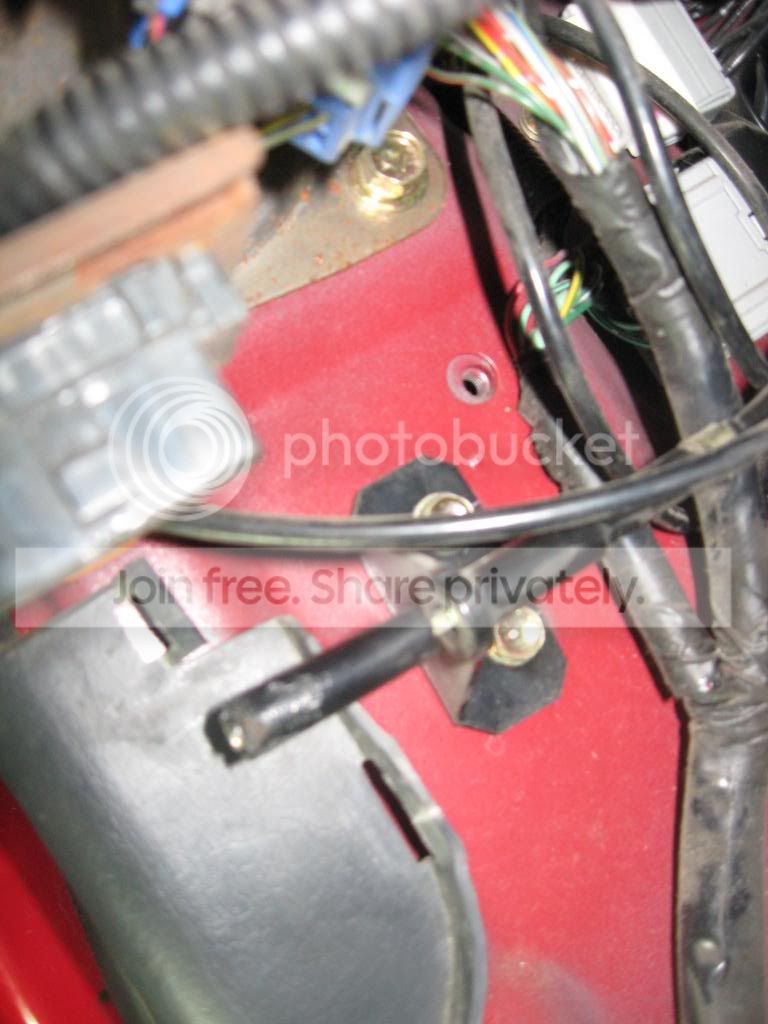

To get the hood latch cable off both the fender and side skirt must be removed. Also as you can see the cable is held by some plastic clips that need to be pushed out with a pair of pliers
What they look like removed
Start by removing the 3 bolts that hold the hood latch to the car they are 10mm.
Once that is done flip it around and disconnect the cable

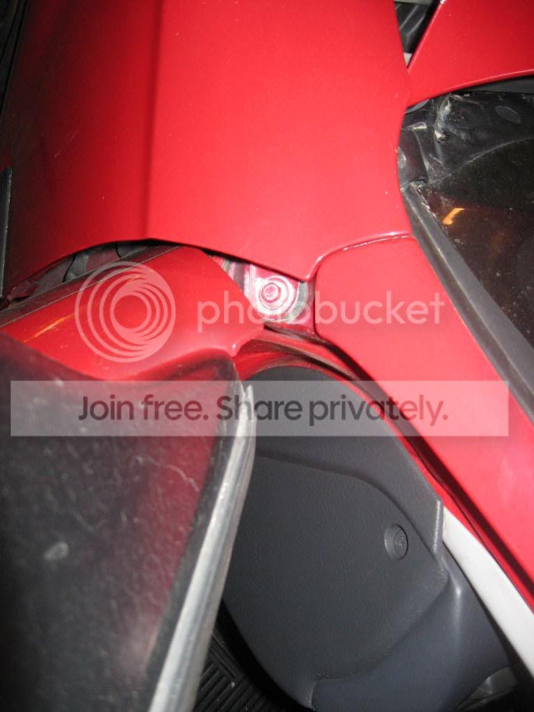

Now let's start removing the fender bolts
2 10 mm back here
3 at the top here
1 here

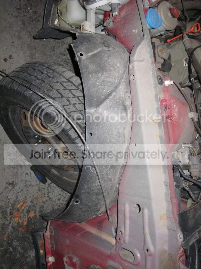

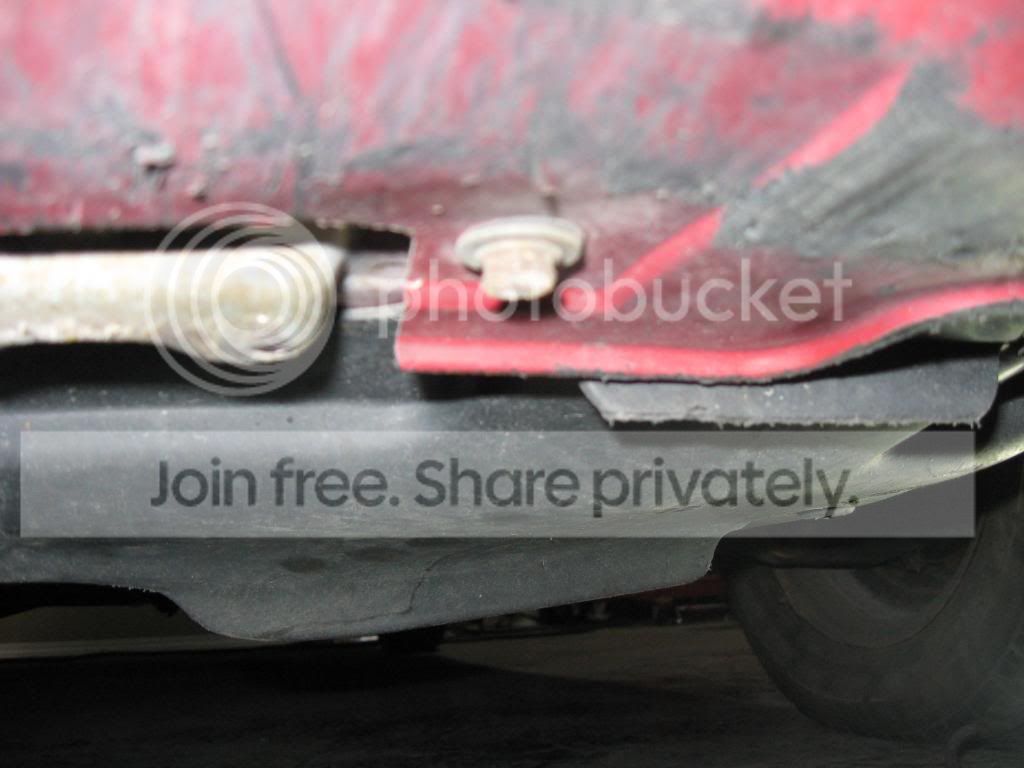

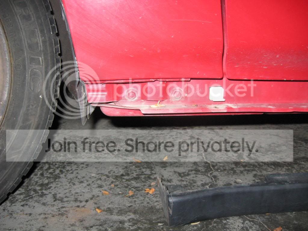

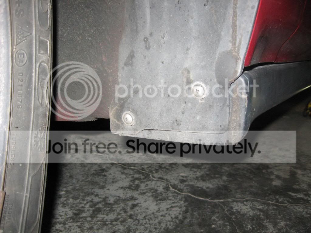

Only 2 more are left and they are hidden behind the side skirt
Remove these 2 philips screws

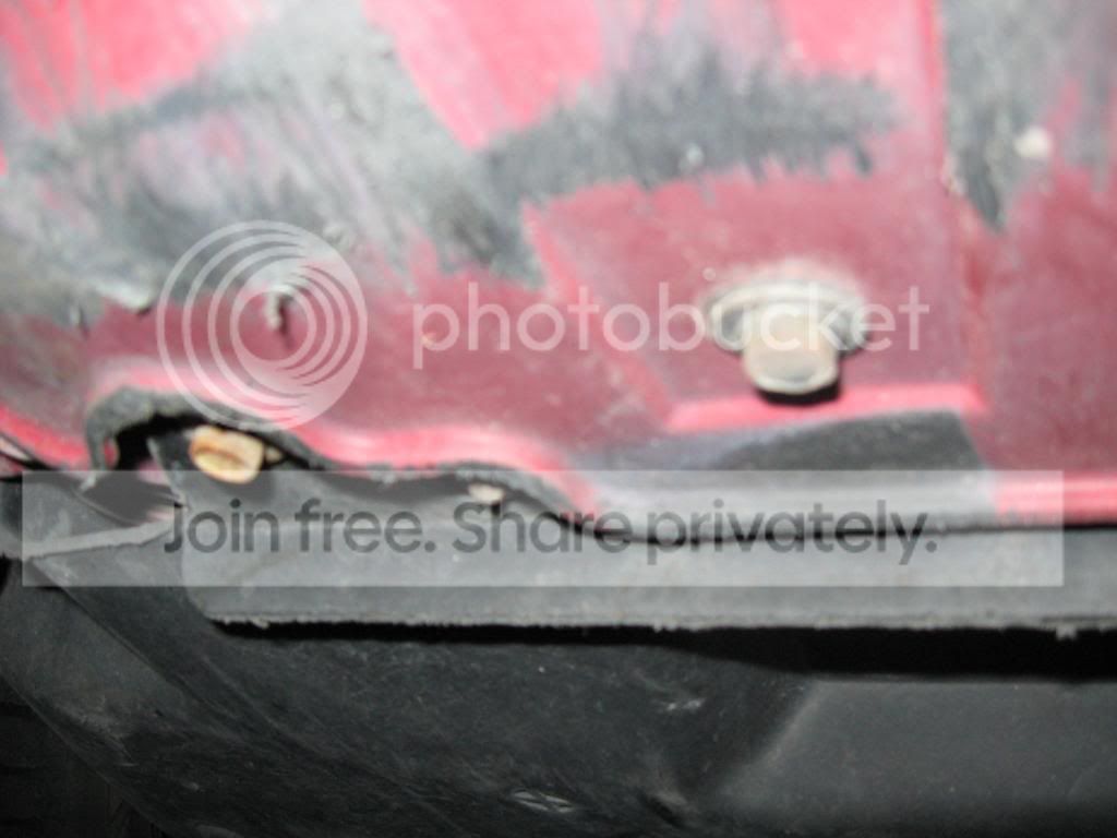

Remove the 3 clips under the car
From the rear wheel well lightly tap the skide skirt forward and it will drop to the ground exposing these
Remove them as well as the clips holding the fenderwell plastic to the the fender and wiggle the fender off

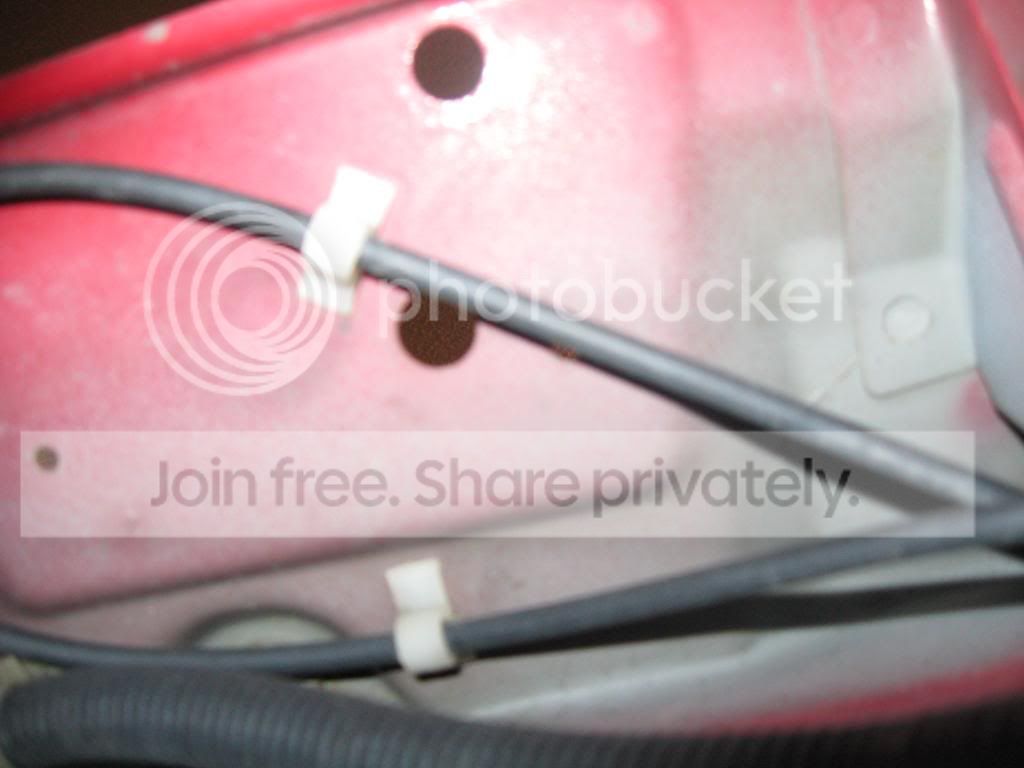

Remove all clips and start snaking the old cable out
Now only the rubben grommet going into the cabin is left, push it in so the whole assembly can be pulled out from inside
From inside the cabin remove the 2 10mm bolts holding the cable to the frame and pull it all out.
Install the new one and you're golden!

New 98 si tails found at pnp last weekend
Since I do swaps once in a while with EFHatch we decided to pick this up to take care of the b*tch pin

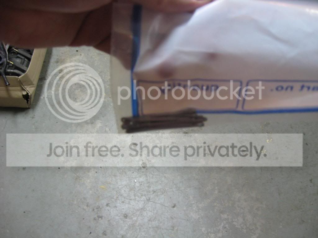

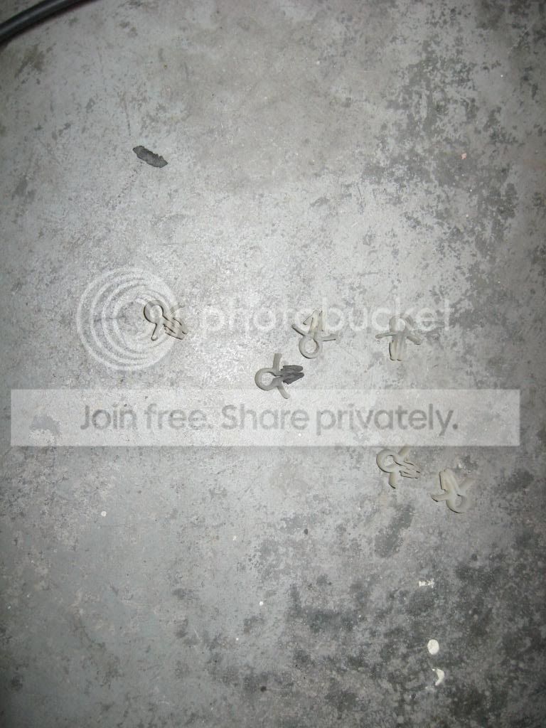

He also hooked me up with some cotter pins since all the ones on the car are on their last legs

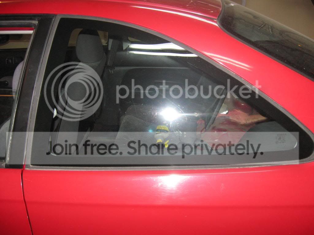

Here is the progress on the tinting removal

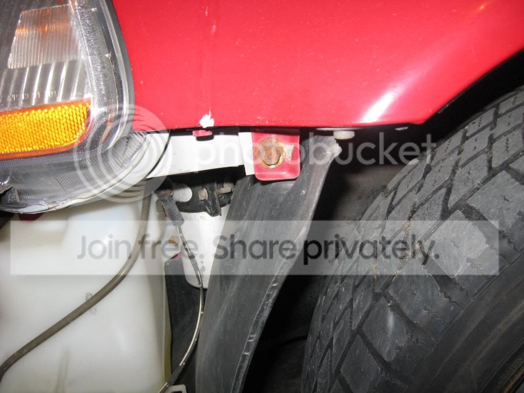

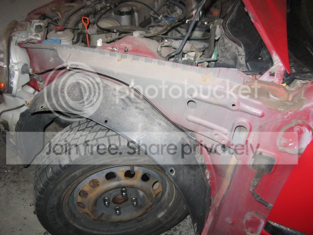

If you remember a few weeks ago when I took some initial pics of it the passenger side fender was bent in:
After some fun with a hammer, a wooden block and a few other things here is how it looks, not perfect but a lot better and the door doesn't come in contact with it anymore!

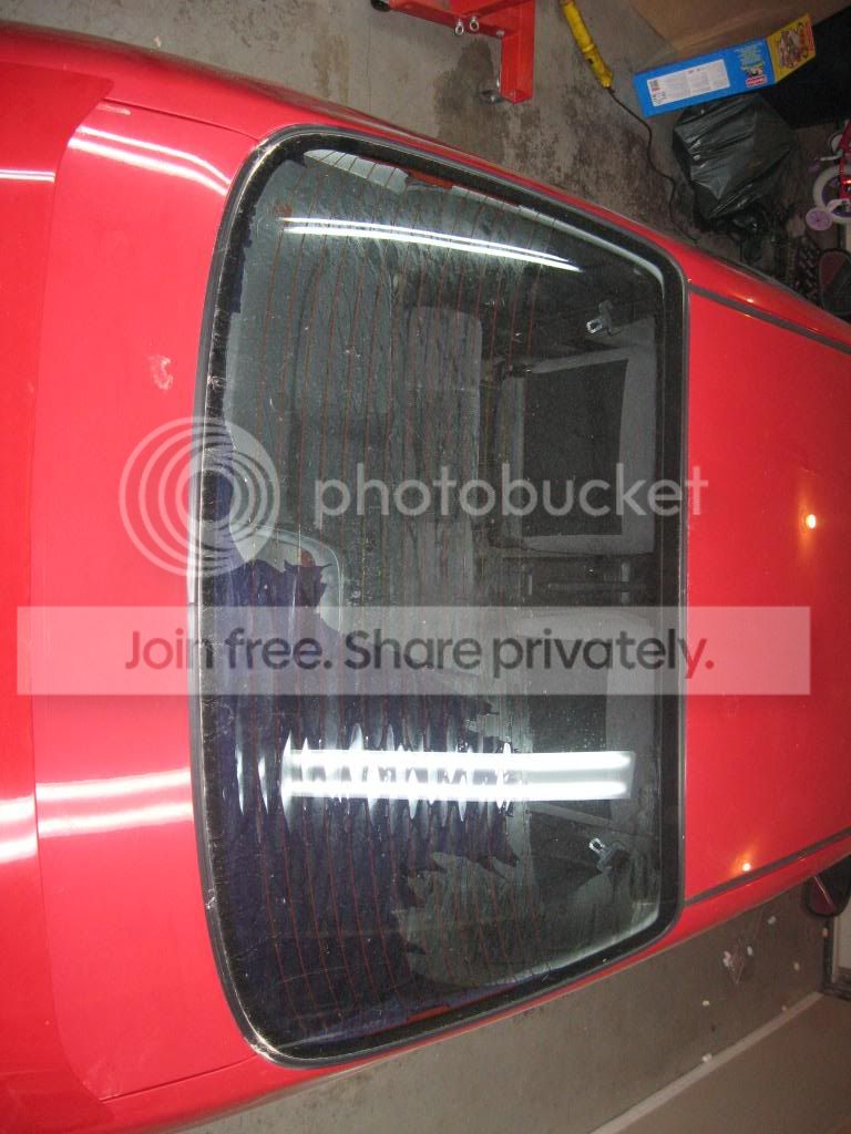

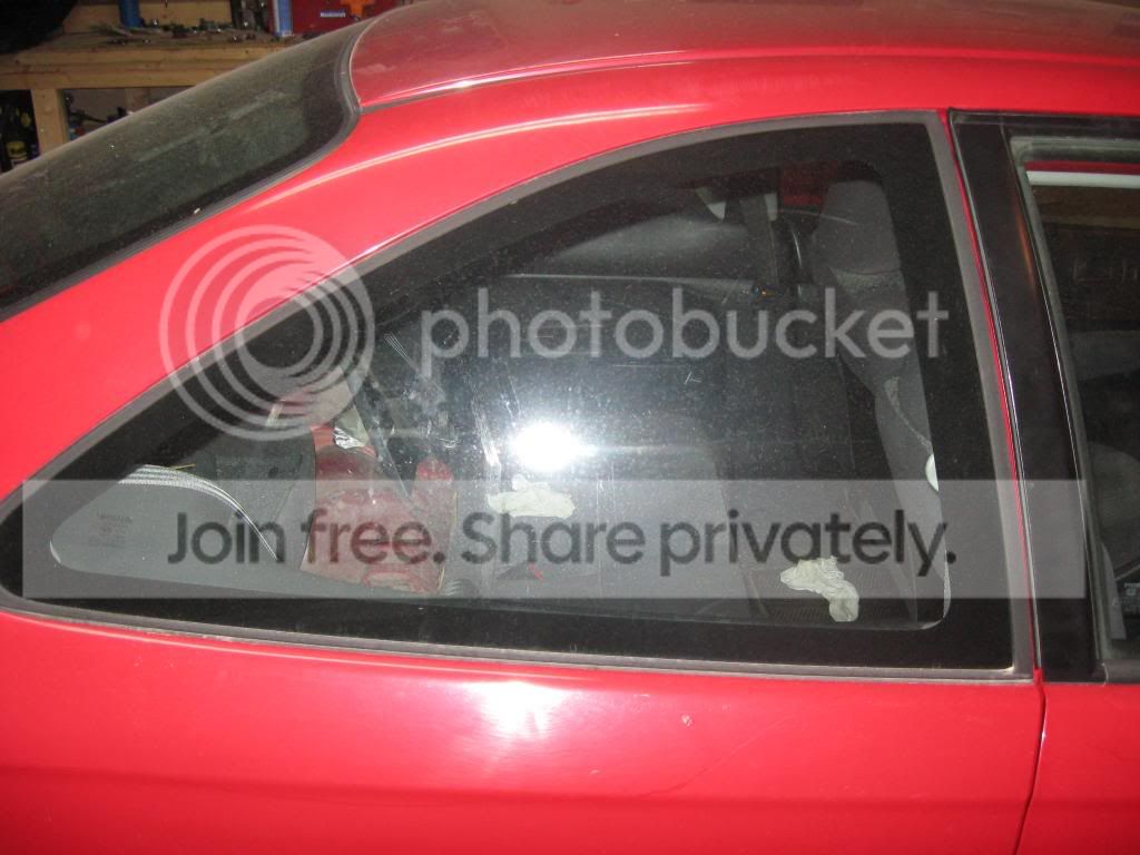

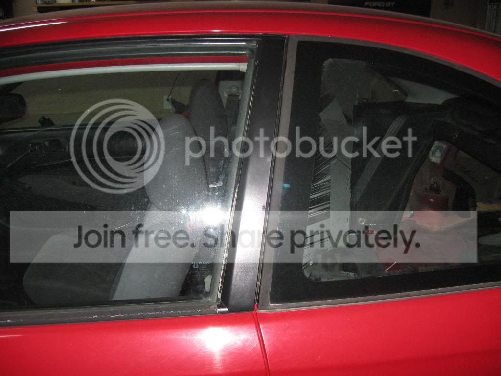

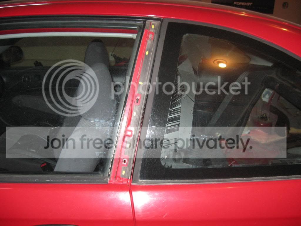

Next here is what the tint removal looked like after working on it a little a couple days ago
And here it is now, all of the tint is gone :D
Still need to remove a bit of glue but the steam cleaner and steel wool are awesome at getting that done!
And the interior at the moment lol
Rear before
After :clap:
And how the window looks

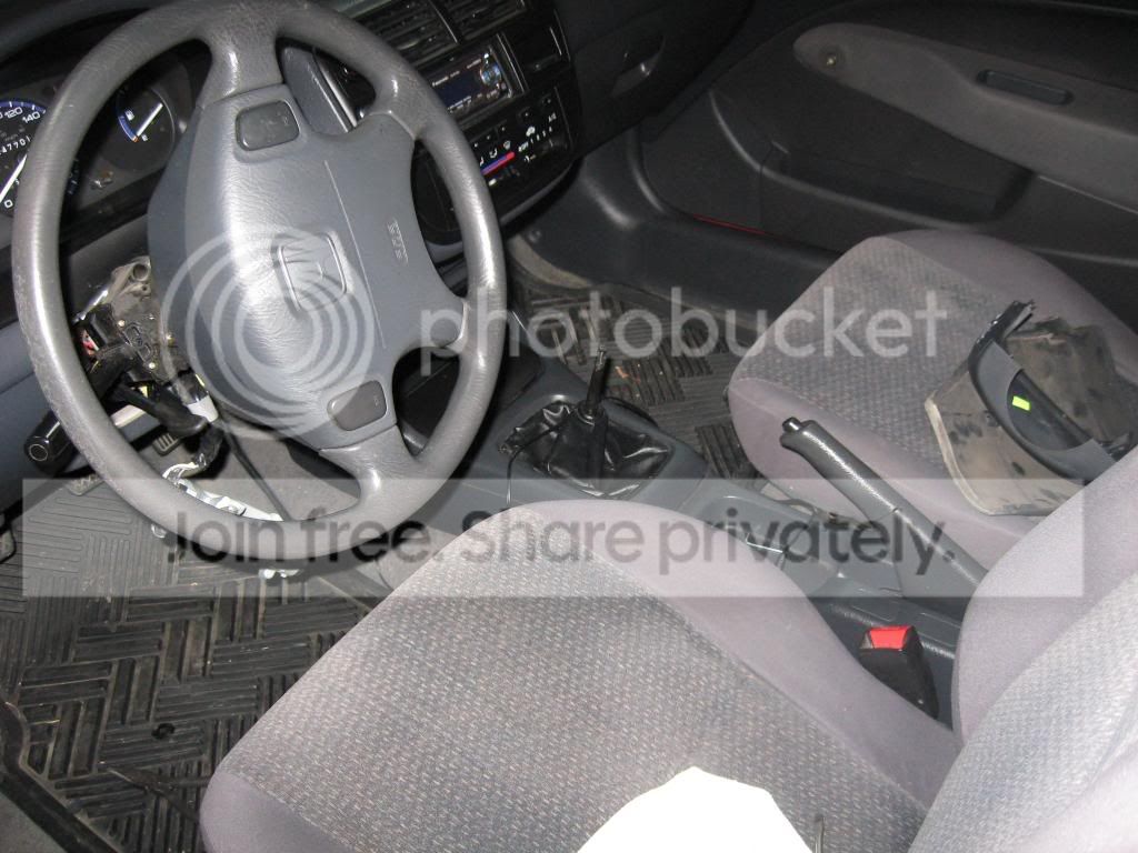

If your car was stolen at some point your key cylinder can now be removed as it's no longer held by anything
Gently snake the wires out of the column and pull it out of the car should look like this:
Old and busted:
New Hotness!
(Please note the 2 new breakaway bolts for the cylinder and the fact I had my cylinder reprogrammed to my cars keys by EFHatch at Honda West)
Installating is the reverse of removal!
Here are some shots of mine all back together:
Feels so much better not having it hang and hit my legs when I drive it or get in and out!

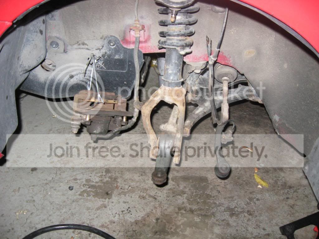

Also installed some Skunk 2 rear lower control arms color is hard annodized.
Also changed all bolts for the rear LCA's, got some steering column cover bolts and a couple caliper bolts that were missing when I picked up the assemblies used.
As you will see the driver side rear LCA is not on yet as the stock one is still held by a broken bolt. A sawzall should fix that pretty soon
On to the pics:
And the pass side rear LCA that doesn't want to come off

Here are a couple pics of some stuff I picked up recently.
Sold the 16's so picked up some brand new 15's for cheap ! Not RPF1's yet but they will do for this season.
15X6.5 4X100 Ikon Apex

Here are a few more things I did recently:
swapped the DX cluster with no tach for an Si one with a tach plug and play
Also picked up some hub centric rings and some cheap tuner lugs and this is what one of the wheels looks like mounted

The engine bay will be getting cleaned up as soon as it starts getting a bit warmer and I can wash it.
Still need to polish the Honda letters back to metal and yanking out the complete a/c system in a couple of weeks

Did a bit of work on the car this weekend. Previously I had removed the whole back half of the car's interior.
Today EFHatch and I removed the carpeting, the rear pannels connecting to the headliner, the center console and some of the firewall sound deadening on the passenger sider.
Also removed the A/C from the engine bay but the core is still in place under the dash for now.
We also installed the A032R's and took it for a drive and it is scary grippy. It had more grip than we could legally or had the ***** to test out for now.

Also removed all airbags and installed a block off plate on the passenger side
Removed the y7 exhaust manifold and replaced it with a 00 y8 one for slightly better flow. Also had a second o2 bung welded to it so I could run both o2 sensors, no CELs
bay starting to look a little bit better
couple pics without the good wheels and at the wrong ride height but they show some of the decals on the car
