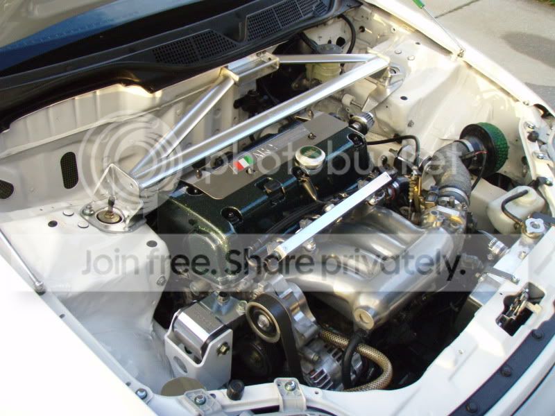

nice. if you would have to make the dicision of going with the ek subframe or the eg subframe which one would you prefer?
Old Nov 12, 2009 | 04:11 AM
  #632
t.schultz's Avatar
Joined: Apr 2009
Posts: 1,253
From: hybridracing.com
Default Re: k20 ej6 hatch...hybrid-racing/chasebay east coast style
go with the eg subframe. worth the money. it pulls the motor up and back so you will have good ground clearance and intake mani clearance...
ek subframe.....
eg subframe....

That white EK above is my buddy John's car. He's now supercharged.
