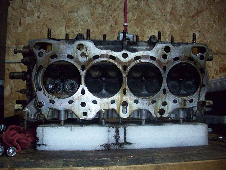

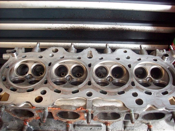

Engine is on the stand and the head is off. Had a bit of a shocker pulling the cams. 4 out of the 24 cam cap bolts were only finger tight. :shock:. Upon close inspection the cam journals and caps in question appear to be ok, no scratches or anything. Ill have to mic them to be sure. Also, it would appear this engine has had a rather unfortunate treatment, stop leak. The **** is everywhere!
The head, in all its nastyness!

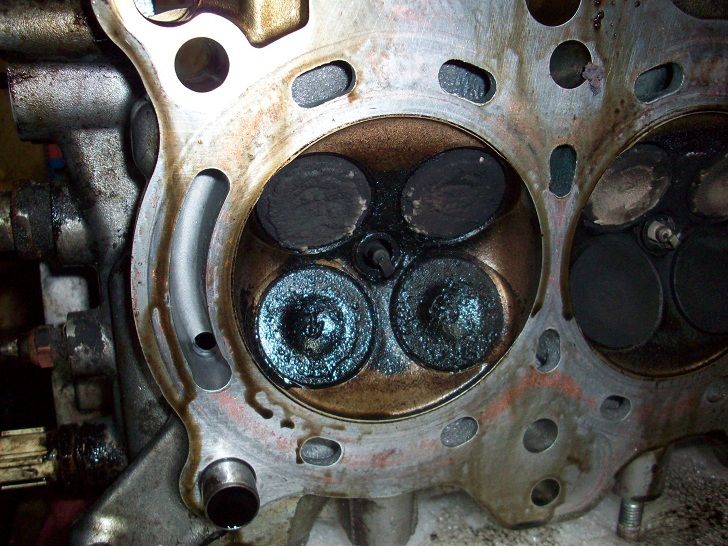

#4 Combustion chamber.

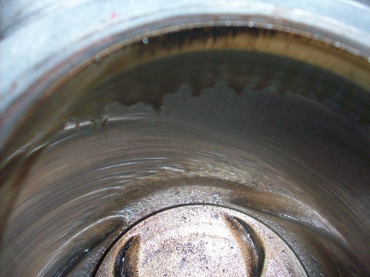

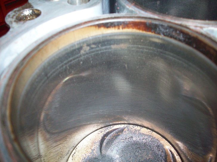

All the cylinder walls are in rough shape. #1, 2, 3 have some cross hatching left, but not quite what I was hoping for. #4 cylinder wall has more less no cross hatch what so ever, just a glazed mirror finish with an ever so slight reminiscence of cross hatching. I suspect failure of #4 oil control ring the be the major contributing factor here. Would also explain the condition of #4 Combustion chamber.
Cylinder #2 [** 1, 2, 3 looked nearly identical]
Cylinder #4

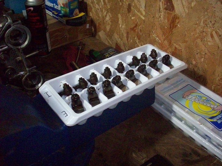

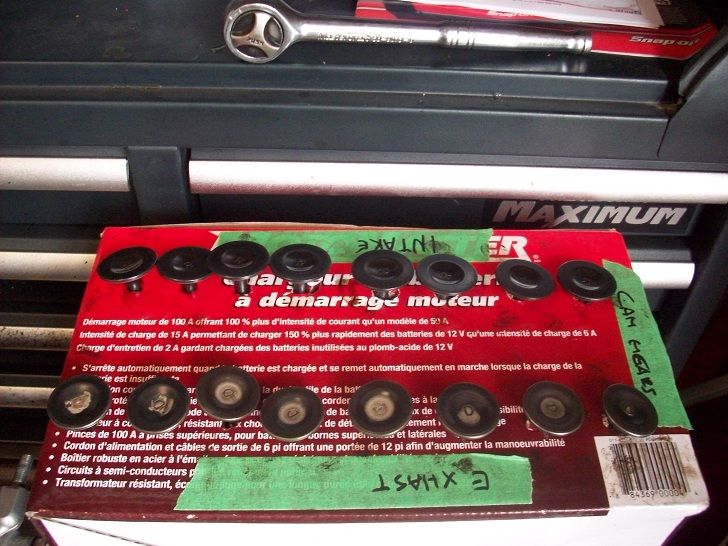

Quick Tip - Ice Cube trays are great for keeping the valve train organized

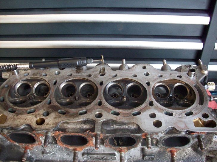

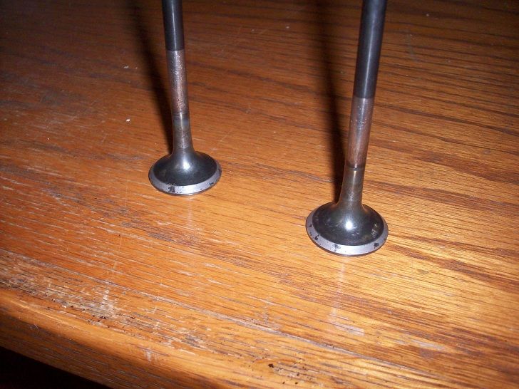

Took the head to work today to clean and lap the valves. All went fairly smooth. #4 Exhaust valves are toast though. Ill have to pull apart my spare head and steal a pair from it. Gave the seats a cleaning with a mini brass wheel and a quickie in the parts washer. Hopefully tomorrow I can start cleaning up the Intake runners.
Valves all cleaned up.
Just tidying up. Removing all the carbon buildup from the valve seats before lapping.
All 16 lapped and a quick cleanup in the parts washer. Some very minor pitting in a few of the seats. Nothing to loose sleep over. This isnt going to be a 600hp race engine so im happy with how it turned out.
#4 exhaust valves. Theres no helping these. Time to start tearing down my spare head for a pair of valves and re-lap #4 exhaust.
