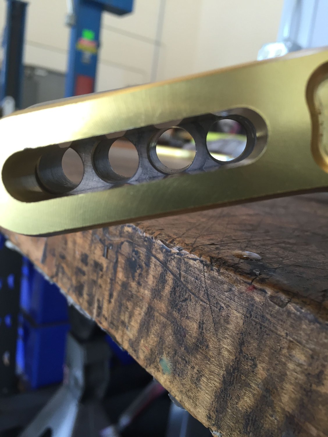

I was lucky enough to get my hands on a few ASR 32mm rear sway bars and spent some time rate testing them. ASR changed away from the fixed mounting hole design to a slotted design. The actual dimensions and locations of the slot are the same as if you connected the mounting holes from the previous design.
I did the rate testing with the older bracket design, then made a template so I could mark my slotted bar.
The test was done with 1" of deflection. This is the 0.95 wall thickness bar.

Quick questions:
1: How did you measure the load? Was it connected to the chain opposite of the hydraulic jack?
2: What's to keep the links from slipping in that slot? Just the friction of the bolts connecting the arm to the end links?
1. Yep, A chain is connected to the table on the right side. Clamped in the center on the bar, and the jack has a load indicator and end-link. so you raise the jack 1" and see what the load is.
2. Not exactly sure on this one. But I have talked with a few people and slipping is not an issue that I have heard of yet. I suppose having proper hardware and making sure it's tight is good enough?
I suppose if the force is more in Z (vertically) than in X (axially like along the car's longitudinal center line), they should stay in place... I suppose.
