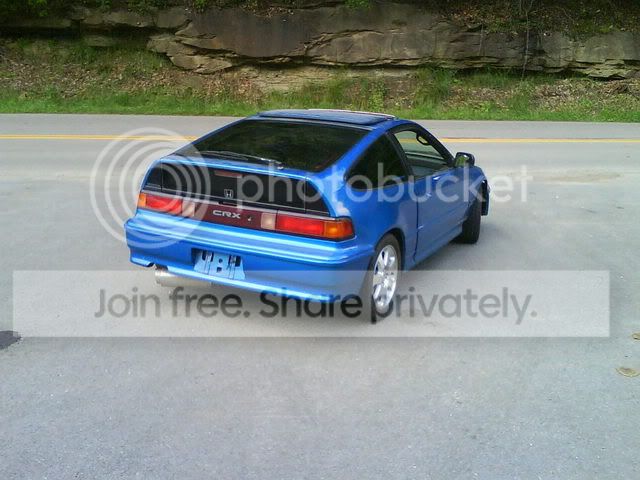

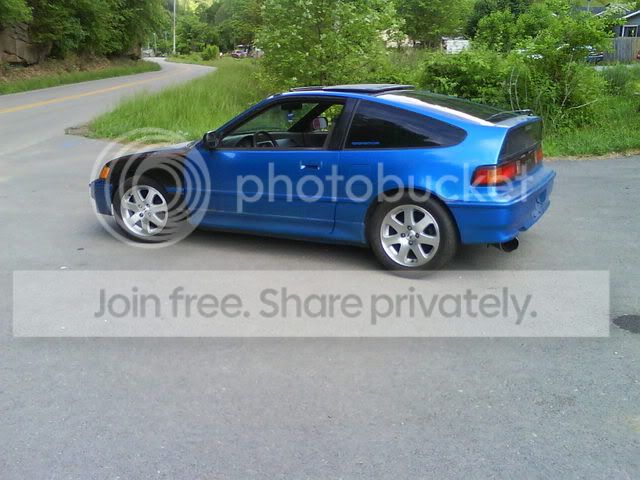

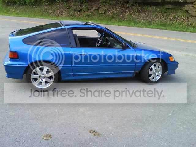

UPDATE UPDATE UPDATE!!!
Have I ever been slacking on this car. Kinda feel bad for the thing. Anyways, today I woke up and just felt like messing with it. Soooo acouple hours later I ended up with this!
Replaced the axles and upper/lower ball joints, controll arms..etc etc..
Come on guys let me know what you think...keep me motivated to finish this thing!

paint that left front fender

Lookin pretty good man. Keep the progress going!

Haha..thanks! No I have a front fender that is painted the same color but it has a small dent. This one just needs refinished. Which is on my list of things to do.
<TABLE WIDTH="90%" CELLSPACING=0 CELLPADDING=0 ALIGN=CENTER><TR><TD>Quote, originally posted by Creator &raquo;</TD></TR><TR><TD CLASS="quote">Lookin pretty good man. Keep the progress going! </TD></TR></TABLE>Thanks man...im trying to keep busy on it.
