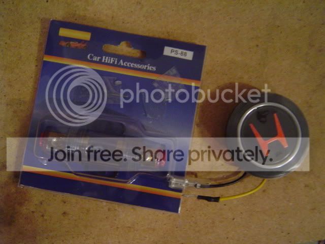

This came in the mail today!!!

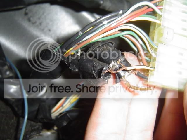

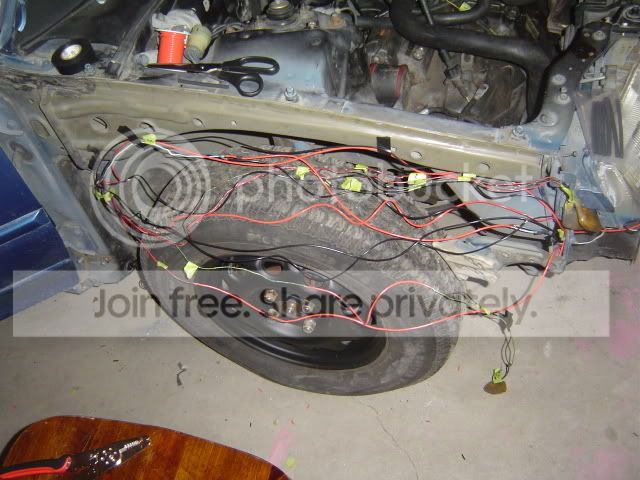

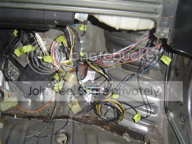

Here is what under my glove box currently looks like...I know it looks like a mess, but I know what everything is.
Here is the passenger fender. Everything is hooked up..I just havent soldered everything yet. Then I have to wire loom it clean!
Here is the problem I am looking at right now. My plugs to my ECU are Ugly...I dont know how to repin or even where to find those little pins to replace it with. Looks like its my only hope though because they cut the wires to short...ehhh

all u have to do is get one of those little tiny flat head screwdriver that fits in the hole and wiggle it arond and pull the pin and wire out.
hey i have some extra pins with like 3 or 4 inches on them layin around what color and how many do u need? just pm me and ill ship them to u

Looks like you've got enough wire to just de-pin those pins from the connector (not too hard to do), and solder the wires together, and heat shrink it. Should be OK. Then just re-insert the pins into the connector body. If it's too short to do that, find a connector on a junkyard car and pull some wires with pins and splice those into your harness.

I think thats what I am going to try doing when I get home from work..Thanks!

Thanks man. I will let you know if this plan doesnt work.
