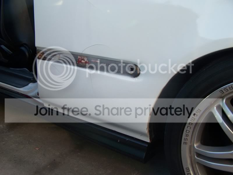

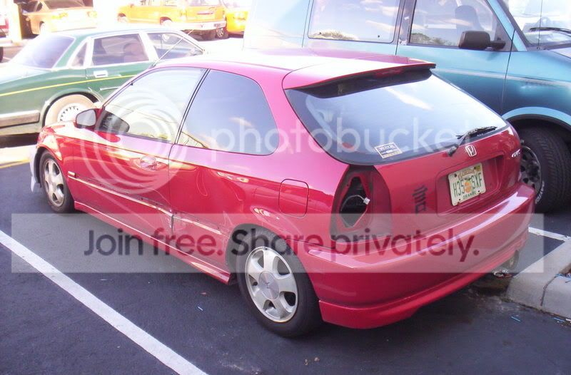

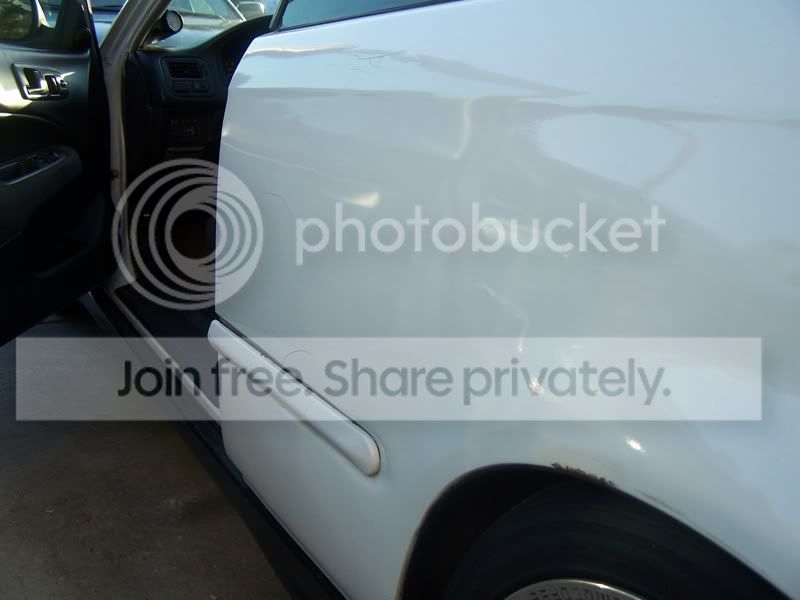

This is how the 1/4 panel looked when if got side swiped

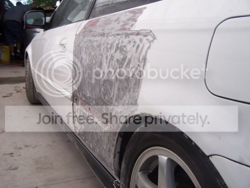

And this is how the 1/4 panel looked after if was fixed
It was a realy bad job, the bondo cracked not long after, and not to mention the asholes didn't even pulled out the dent. They just filled the hole dam thing with bondo.

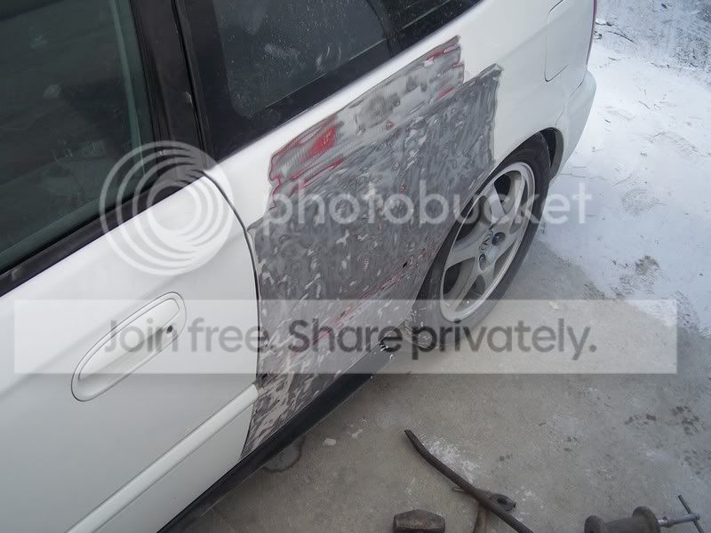

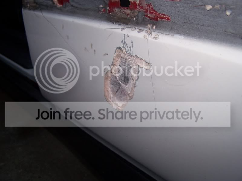

I took some bondo off with a screw driver just to see, but at some point, it had up to a 1 inch thicknes. Lets put it like this, before the back wheel well was flush with the tire, and now there is a gap, so I need to adjust the coilover.
Took all the bondo off and pulled it as much as we could. We still needed to use some bondo in some parts, but it was kept to a minimun.
After that it got primered.

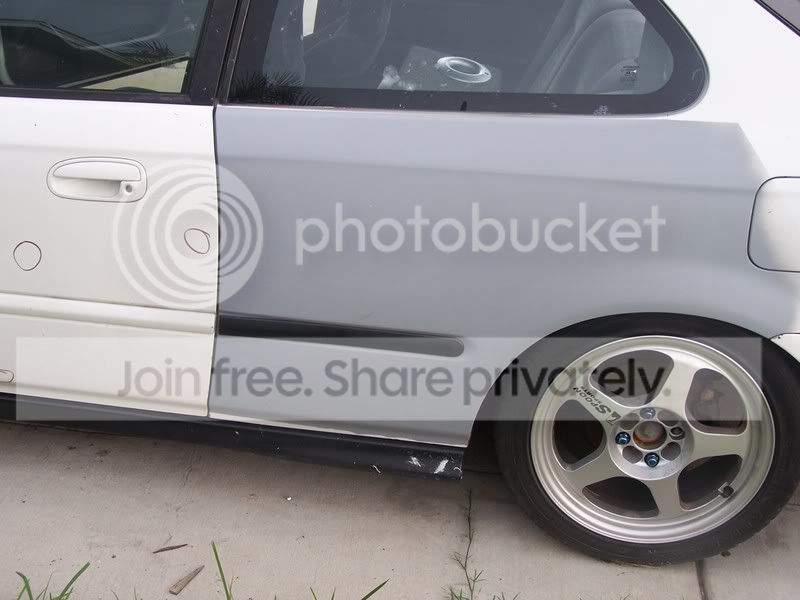

Here is a pic of the finished quarter panel, primered and ready for paint. Dont crack on the wheels, they are not staying. lol

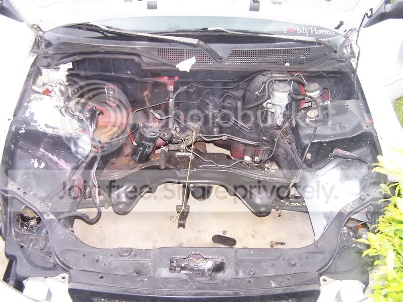

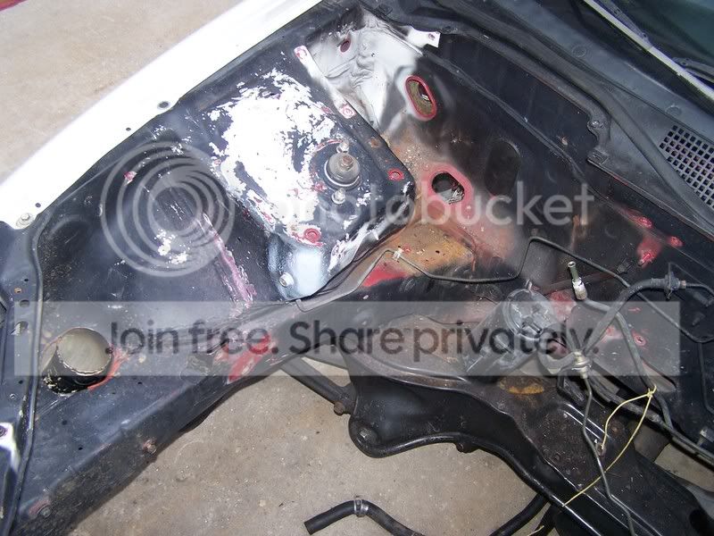

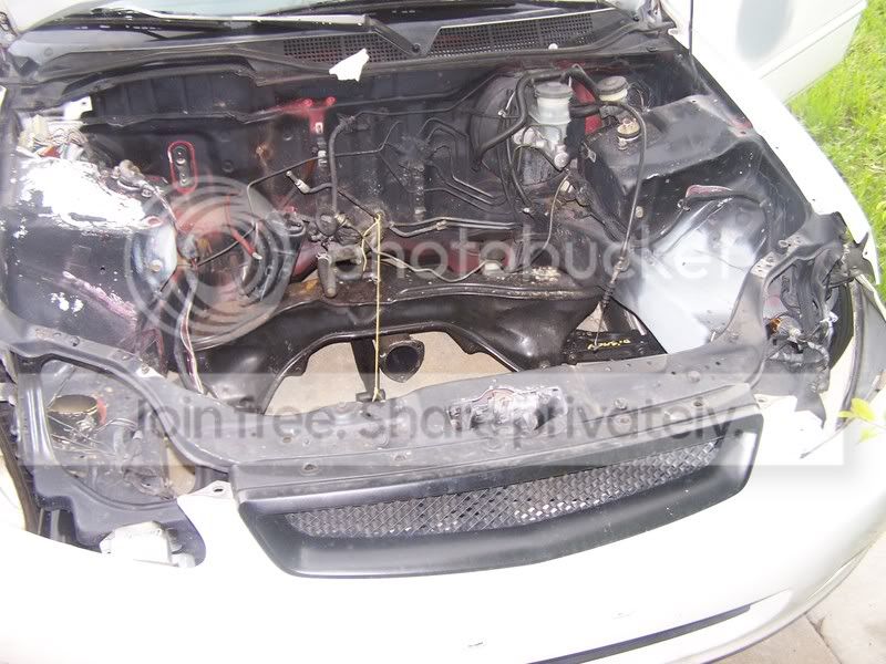

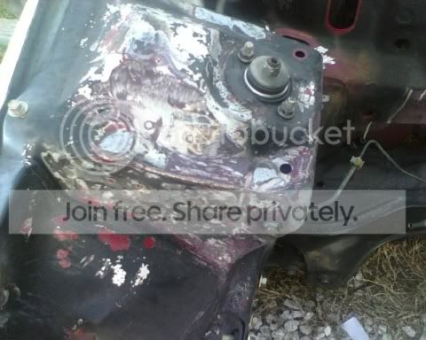

So I took the engine out, and realized something. My [freak]ing engine bay is hurt. I took the fuse box, and a couple of other things out as well.

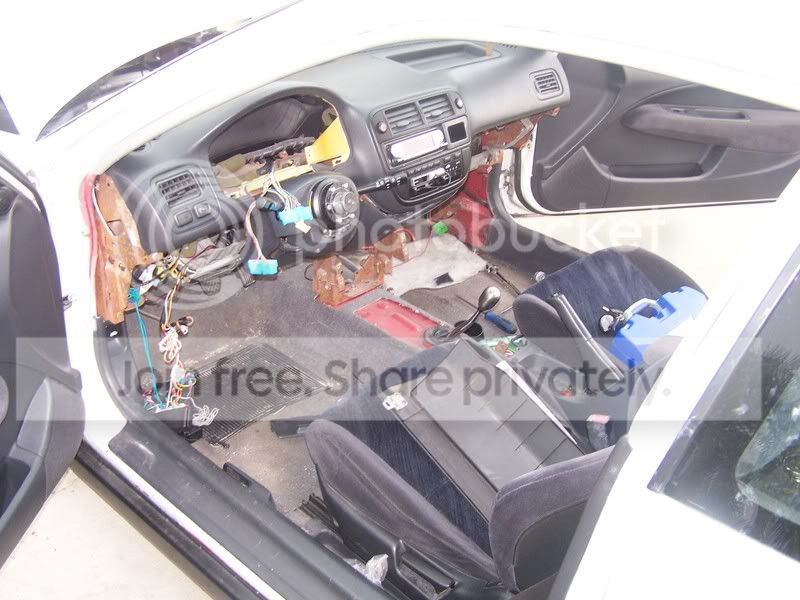

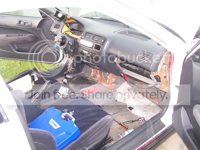

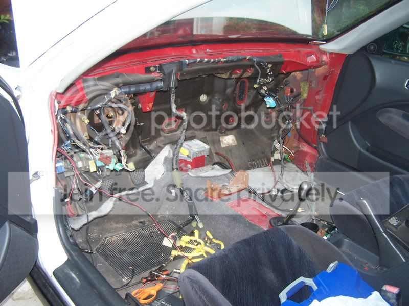

So I started taking the interior out for paint, and also for the wire tuck. I also took all the AC stuff out.
I extended all the wires on the passenger side, and ran them through the side.

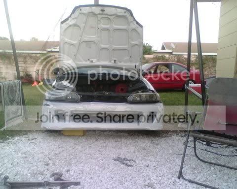

Ok, so its been a little over 3 months since I did anything to the car, but now the works resumes.
I didnt really do anything to it this weeked, just moved it to my friends house (aka the shop..lol)
and just for fun and giggles, I put his jdm front over my car just to take a pic, but dont worry...I dont like front end conversions.
The hard work begins this week. We are going to fill, shave, and primer the engine bay, and finish the wire tuck.

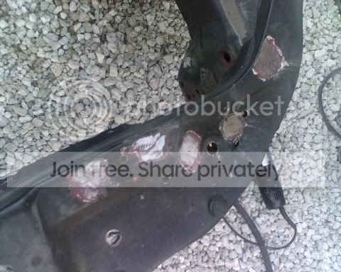

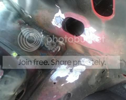

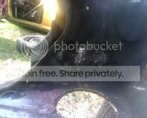

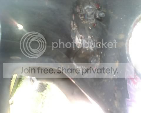

oK guys, so here is the work up to now.

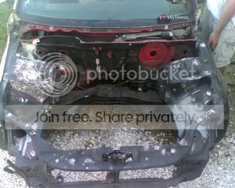

Most of the extra holes have weld spots, and are grinded down. I feel like a lazzy *** because I didnt do any of this myself. Everything was done by two of my friends. lol
I'll be there early tomorrow morning to keep on going.
BTW sorry for the crappy cell pics. I will have my camera tomorrow.
Tomorrow we are stripping all the paint, filling, and primer.

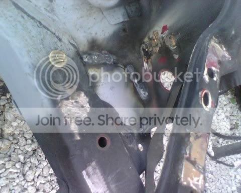

Ok, so this are the updates
-Radiator support is done
-Passenger side strut tower almost done
-Drivers side strut tower, couple of hours of work left.
-All welding on firewall is done, but still have lots of work left.
We primed all the bare metal before calling it a day for rust isues.

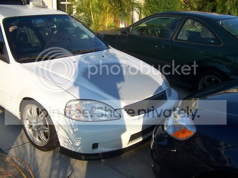

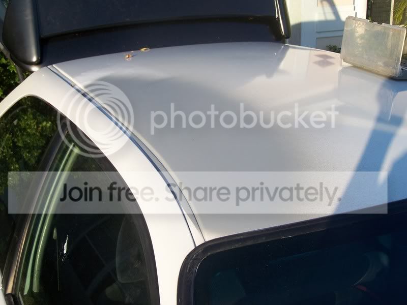

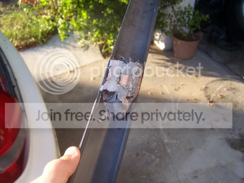

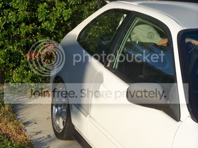

So i been neglecting the thread a little! lol
Here is the progress till now.
BTW I only put those white 17s on to see how the color will match with the white.
They are not staying.
