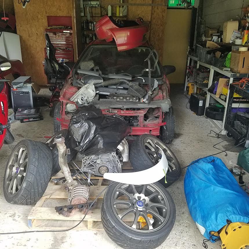

What's up everyone. I'm new to the forum but I've been researching threads on here for a while. I came across a deal that was too good to be true. I found an old lady 1 owner 96 Civic CX with 100K on the odo. She sold it to a friend of a friend that let it sit in his garage for 3 years. He was going to do a B20 Drag build but ended up having to move to Colorado. It is taken apart about 80% and came with extra goodies. I was told that the existing D16Y7 was running but had some sort of head issue. That works for me because I want to do a MiniMe build. Seems interesting and will give me a change to learn about these engines. I've compiled a list of items I want to get. Feel free to chime in. The items I've chosen are based of things I've seen in other builds and seem to be the basic recipe. I'm sure there will be other major and minor parts I may need to complete this. So far, this is what I'm looking at.

It came with a B20B

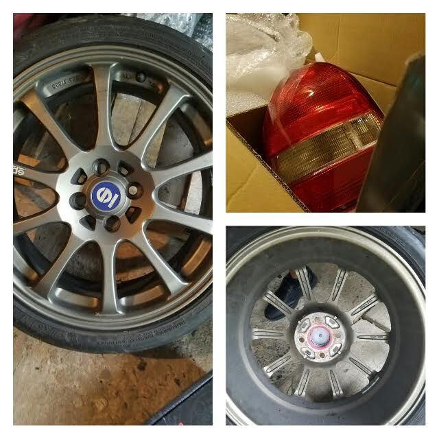

17x8 Sparco wheels/w tires
So far I bought a new hood, fenders, headlights and tail lights. They were really faded and had some damage not worth fixing.
Don't mind the over fender. That's for my Cressida.

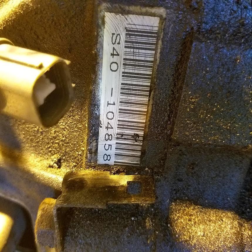

I've heard mixed reviews about the S40 transmission. Some say they are really weak. From what I'm reading people change some of the internals or get a different stronger transmission. I need to look into this more. The car will be a weekend event car and mostly spirited driving.That's all for now. Compiling more lists!! Doing more research.

My front suspension is coming in on Friday. So for the rest of the week I'll be putting the interior back together and hanging all the parts that I got. So, hood, fender, headlights and taillights. After I get the arms, I'll get those on and then switch out the 13 inch wheels for some 17s
17x7+42 Sparco Assetto Gara Bronze
