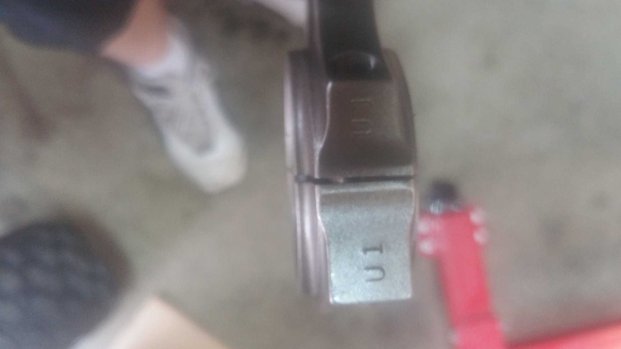

Also I started cleaning up my pistons for block assembly yesterday. The first one turned our pretty good.
Wondering if bearing is right. Is it supposed to go all the way across the rod journal?

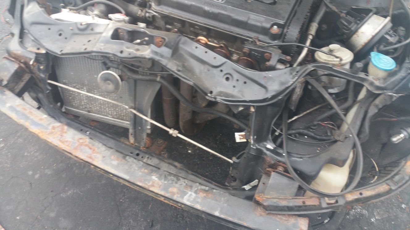

Well been a while. Missing our local event this week due to windshield. Was cracked and they let me run last event. But basketball hit it and shattered it. Tried to get safe lite to replace under warranty they said no go. So I ordered a cold knife and got it today and took it out to access the rust damage.
Pictures are below. I think my plan of attack is going to be to cut it back to after the first tab and then weld a new piece of metal to that and fix the lower structure. There is a post on here about fixing it glad mine isn't that bad after cleaned it up. There was a ton of seem sealer in there so wondering if someone has tried to fix or cover up once already.
Let me know what you guys think. Also took some pictures of the passenger side to show no rust over there.

Well got the cancer cut out and ground down and started making a piece to fill it from an old hood I had. Enough for today hopefully next time I'll be able to weld it in and make the top piece.

I've worked on it a few times and pretty much suck at welding the $99 welder probably doesn't help much.
Looks to be sealed though and will be adding layer of por15 over it. Before final welding of top piece.
