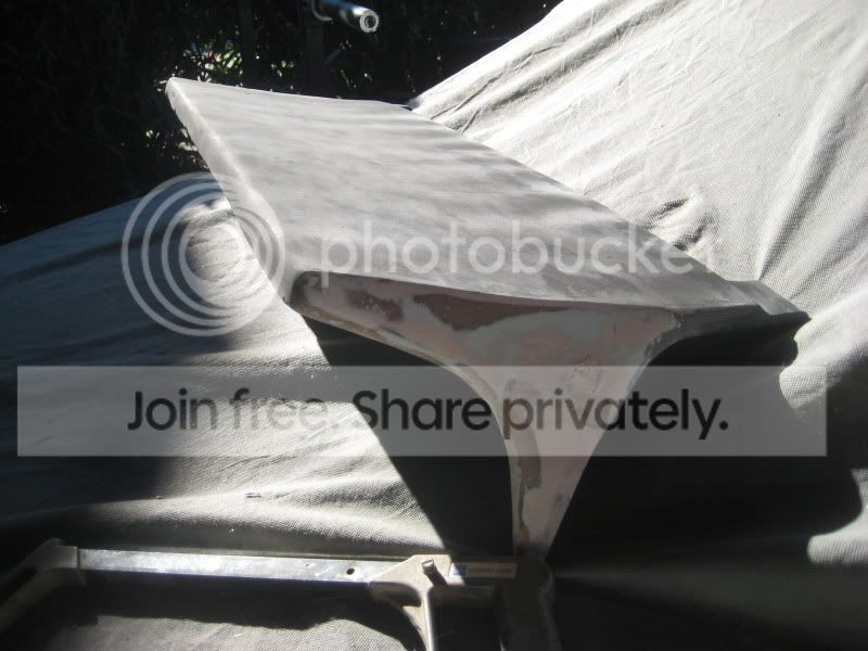

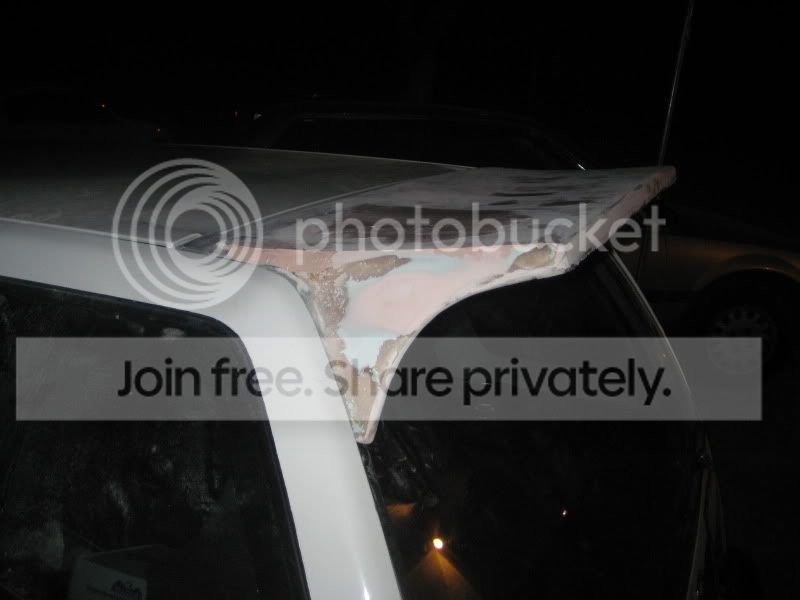

Originally Posted by CBURKE
Try laying that filler a little more flat. That will help you get the low spots filled and it will also not be as much work sanding. Looks great, keep it up!
yea, it was drying up fast cause i did it at night so i added a but more hardener. an orbiter sander took care of that and the rest was blocked. thanks for the look out! my spreader was old from doing my bodywork on the car. i got a new one yesterday and its laying flat and smooth now.

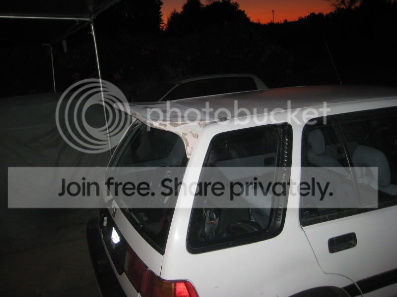

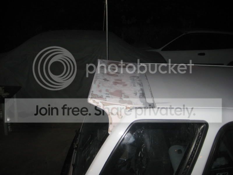

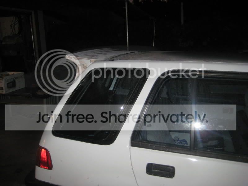

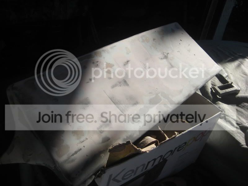

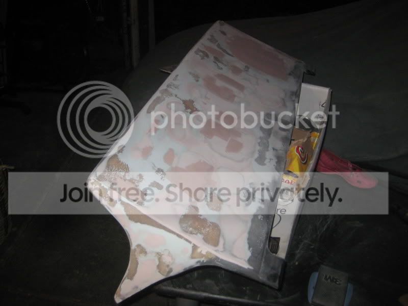

i got around to working on my wing again today. put a smile on my face haha.
sanded down the bondo and laid a coat of black on there for the guide coat so i can find the low spots and fill it in.
here you can see whats left of the black which are the low spots that needed filling.
it got dark pretty quick so after the last layer of bondo (i hope) i left it dry til morning.
i have not worked on the underside yet. if all goes smooth tomorrow morning on the top side, the under side will start. also hoping to make a trip to a local store to buy some gelcoat etc.

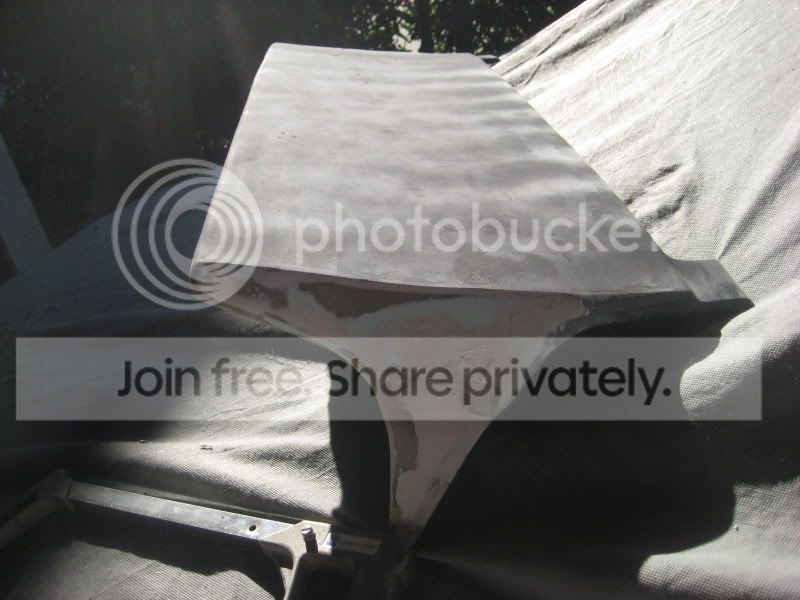

i took the step today to make a purchase on the basic items i need for making a mold.
todays work.
