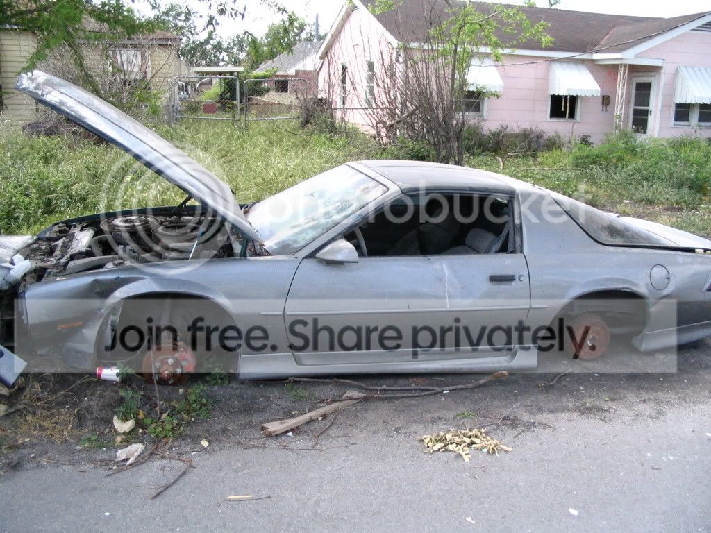

Here is the area where I live during Katrina... Stupid storm took my Grandmother

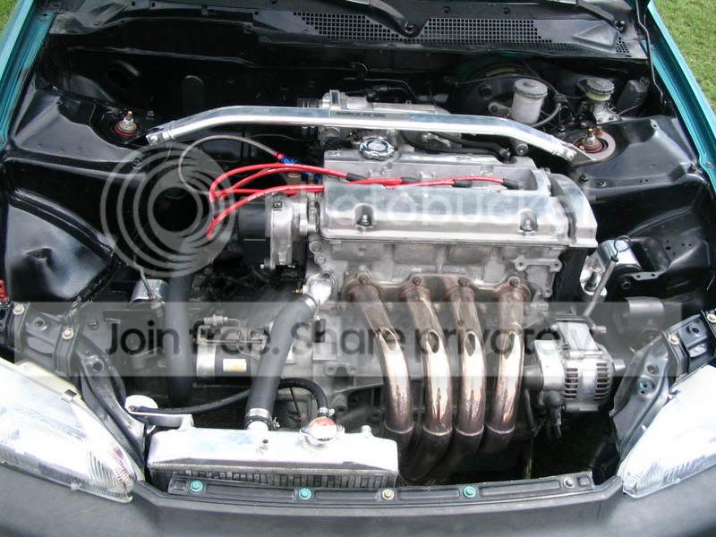

I started to modify my H22....
And my CB7 went through many stages before I found the chasis I always wanted...
Well on to my civic
H22a
Brauning Motorsports P&P head
crower stage 2 cams
crower valves
brian crower springs titanium retainers
S100 in p28
skunk 2 TB w/ port matched plenum
Rmf header (thanks Randy)
buddy club exhaust
oil cooler
Function Form type 2
skunk2 camber kit front and back
asr subframe brace
itr sway bar
skunk2 LCAs
ETD traction bar
15" slips with bfg sports
GSR Brakes
old school Nardi steering wheel
del sol seats
Thanks to jhpusa (daryl), inlinefour, icb, mfactory, and EBAY

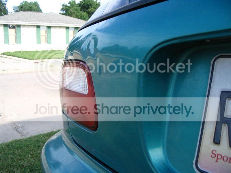

Alright here are my issues.. SOME DENTS....

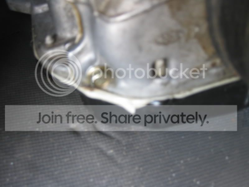

Next is my Mounts.. I think I might have the wrong transmission bracket. The one I have is from the CB7. I am going to check to see if the CB7 and the prelude part #s match.

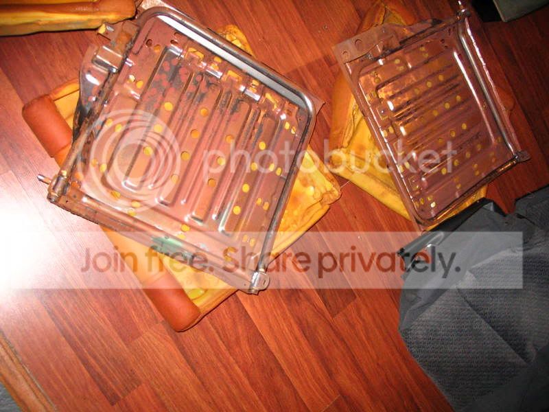

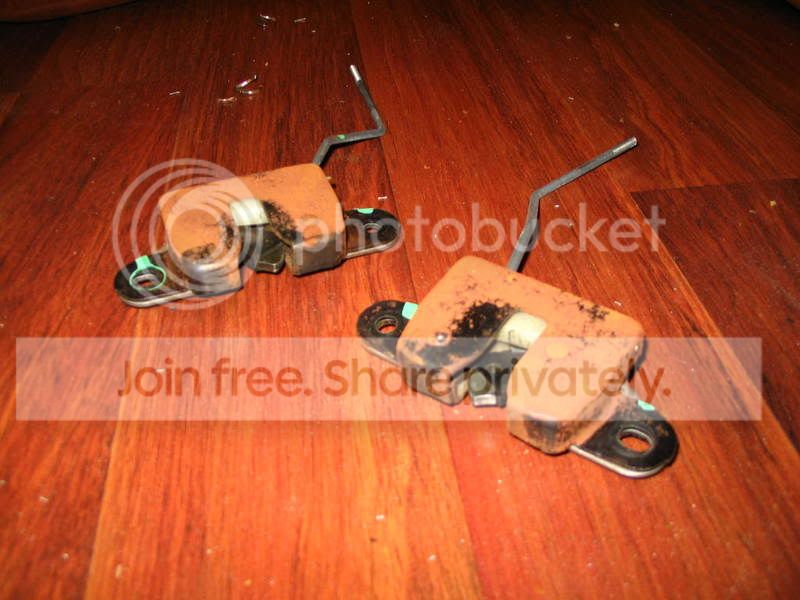

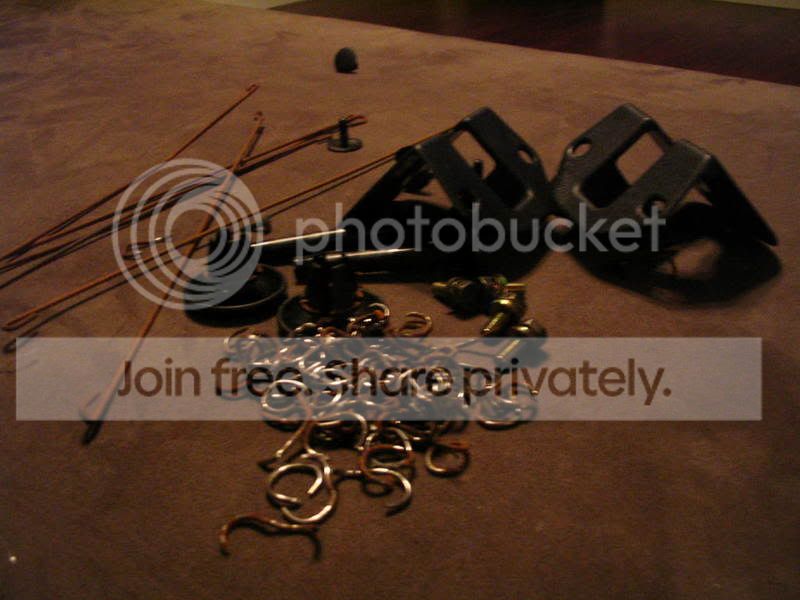

I decided since my time is short between work and being a youth pastor, that I would get some smaller things out the way. I had this idea about reupholstering my back seats, until I seen how much it entailed. So here is the tear down of the seats.
They were pretty dirty from the previous owner(s).
I started taking them apart to find this rusted mess.
They had clips everywhere
Smokey
washing time
They actually came out real good. Way better than I hoped. I am going to order new hardware and clean and paint the rest.

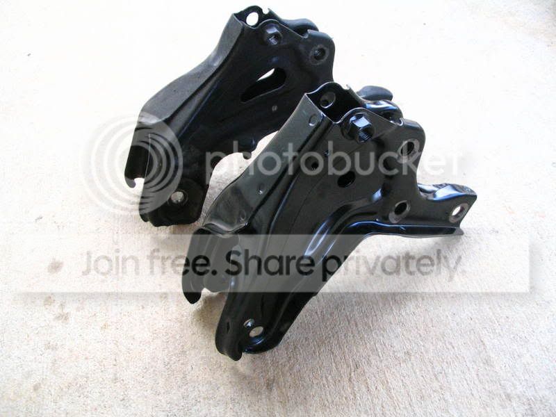

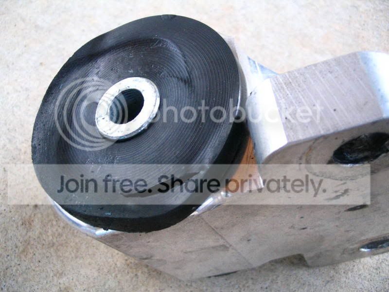

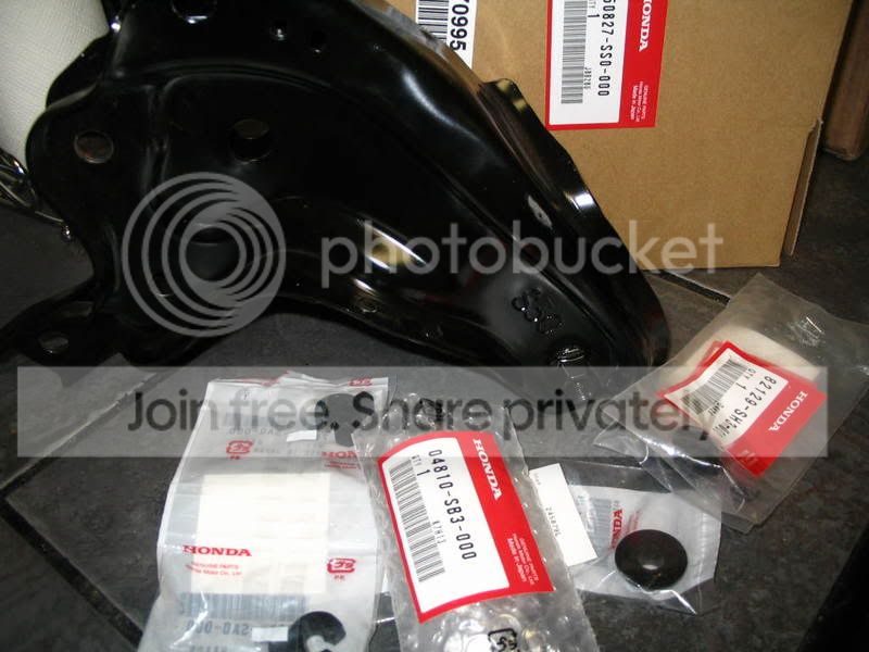

I called hasport and they told me I have the wrong rear trans mount. (thanks Rob) I ordered new urethane, and have a couple shipments coming from Majestic Honda.

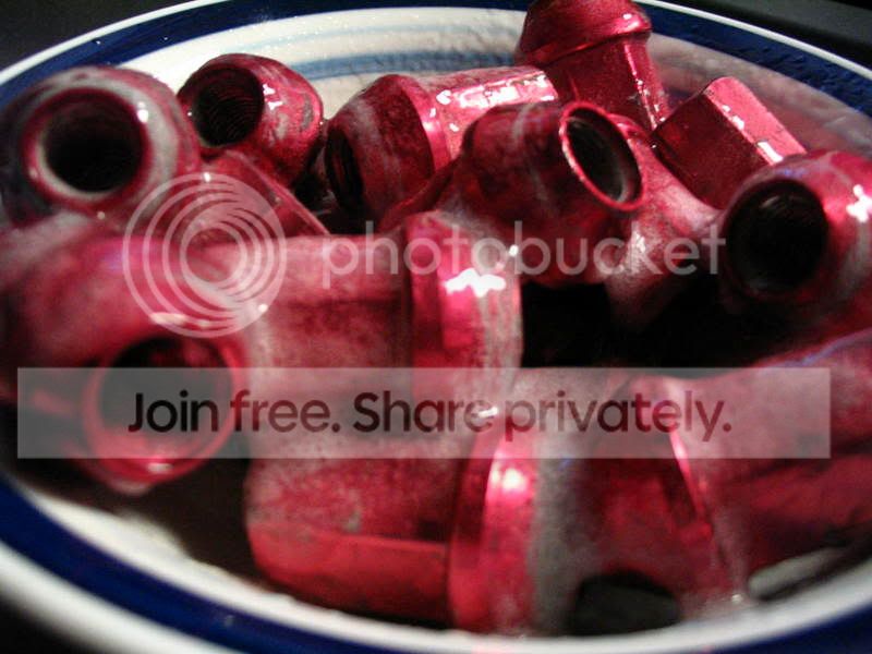

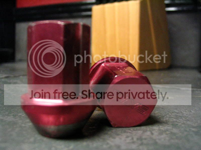

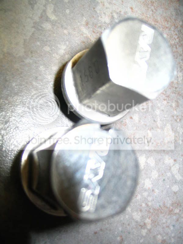

I have some Rays lugs from when I had my volk te37s on my Accord. But I Hated the Red that turned into pink anodization.
So I researched in Yahoo, and found out how to strip the anodized coating off.

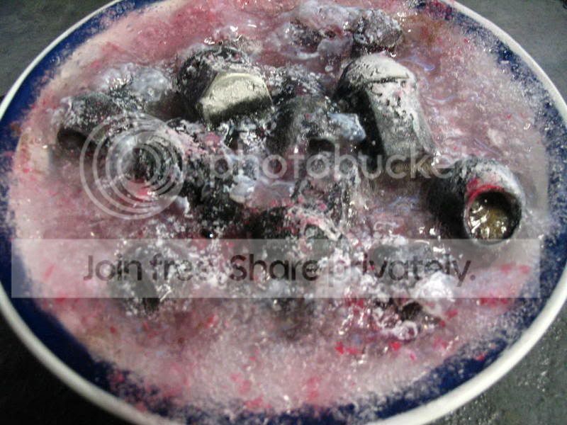

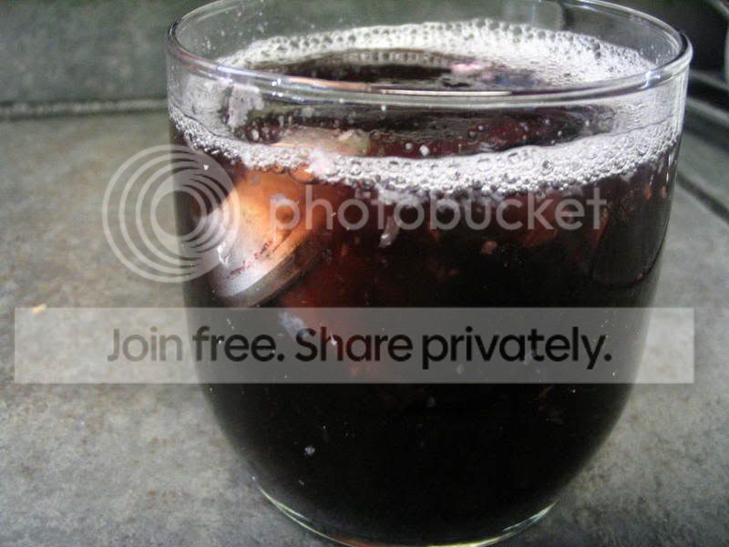

Step 1----Soak or spray object with OVEN CLEANER--thats right oven cleaner. The article said to use the yellow can of easy off. Well I didn't have that, so I used what I had. By the way paint stripper doesn't work. Here is what I used.
waited overnight

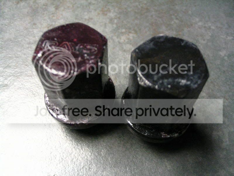

OOPS!!!!
Then I thought of something
Then all that black just wiped off ( I let them soak a couple hours)
Next I just used some Mothers aluminum polish
Way Better!!!
Alright hopefully on to bigger things!
HAVE A GOOD DAY!!

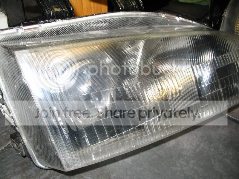

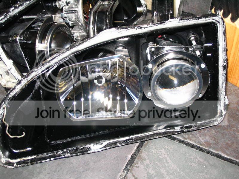

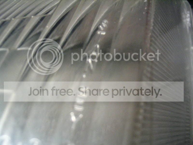

Alright I have been really busy helping my wife out with vacation bible school at church. I have parts stacked up but not on, which is totally not me. Usually the first chance I get ( about 10mins. after the ups/FedEx person leaves) the parts are installed. I finally got my rear prelude bracket in from Majestic. I also finished painting my rear seat stuff, and all the parts are in for that as well.
Have you ever had an idea that you thought was soo cool and then when it came to pass you were like, "what the heck was I thinking?". Well when I learned my Jdm eg6 headlights wouldn't fit because of my altenator hitting it, I decided to make my own headlights using tyc projectors and the jdm pieces. Here is that bright idea.
Well I have now decided to put the Jdm plastic lens on the Usdm housing because I hate the glass nipples on mine. In the oven and voila....

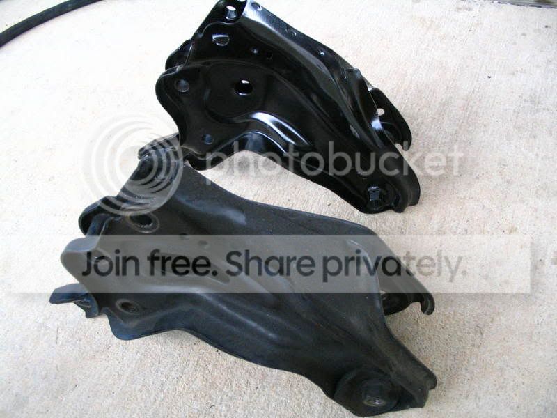

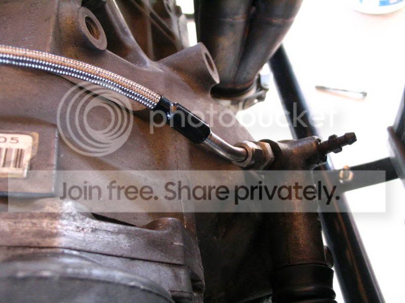

First thing was I Installed the B and R fittings clutch line...

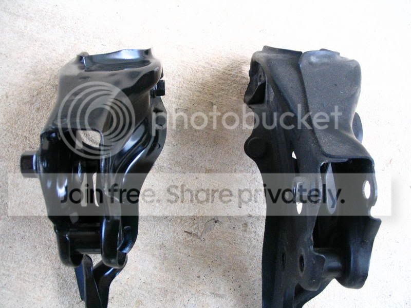

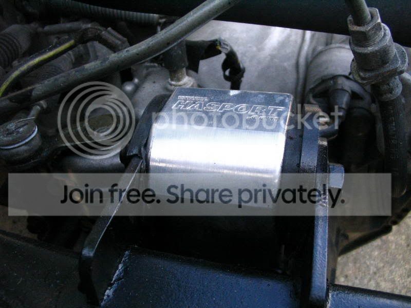

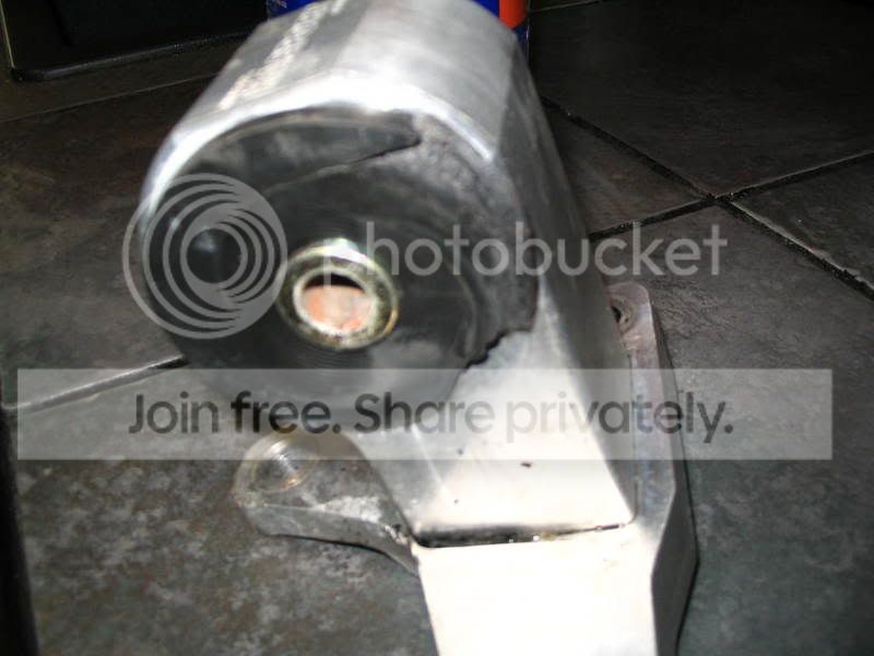

Then I decided to put the right rear bracket on my motor
Notice the difference between the CB7 (acccord) bracket and the prelude one.

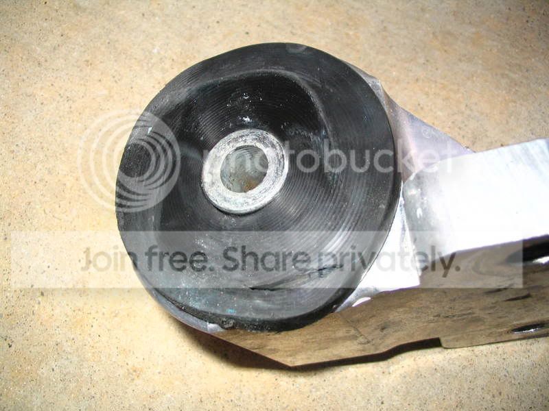

And then i replaced my motor mount inserts with new urethane (thanks rob @ Hasport!!)
Here is what the incorrect bracket will do on your mounts.
Alright was that not interesting? My car doesn't vibrate like it used to (whoo hoo).

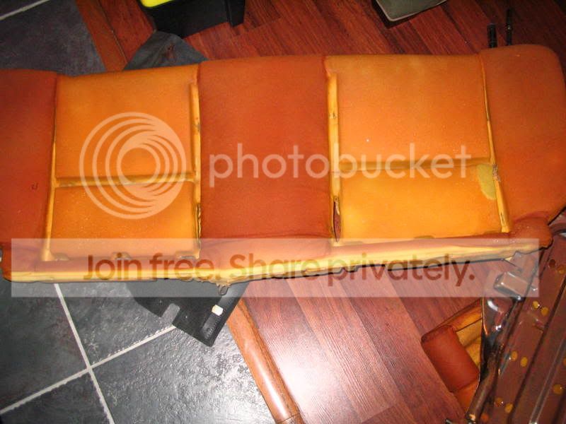

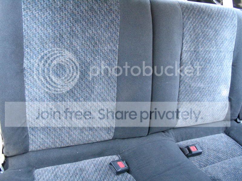

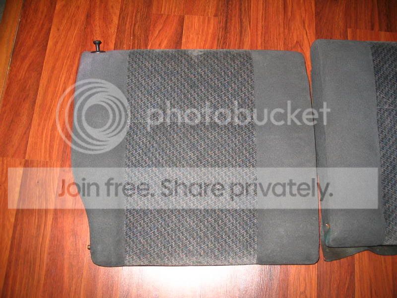

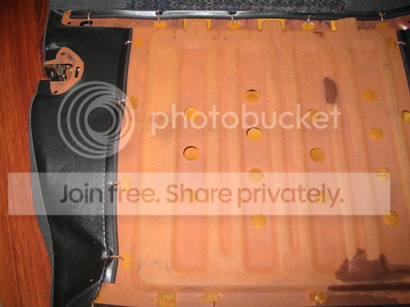

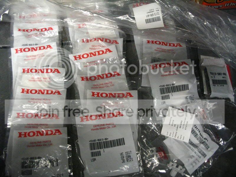

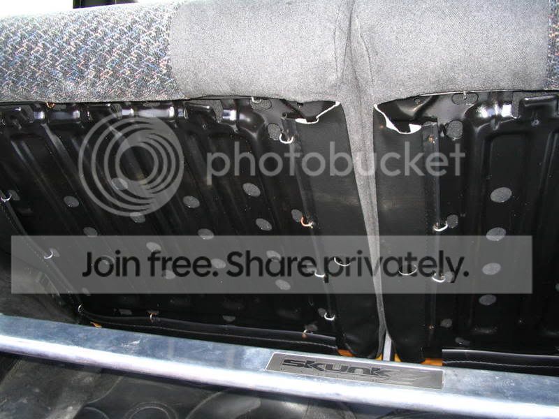

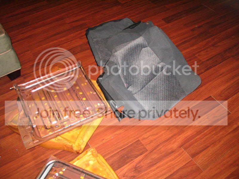

Anyway I finished the two uppers of my back seat . I have to get more clips for the bottom though. Next I will be finishing my tuck and my bay and then body work!! I also have to finish polishing my wheels. Until then, Have a great day!!

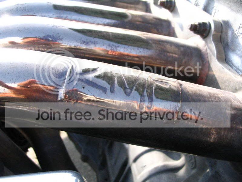

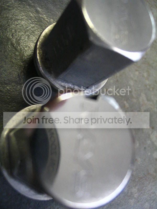

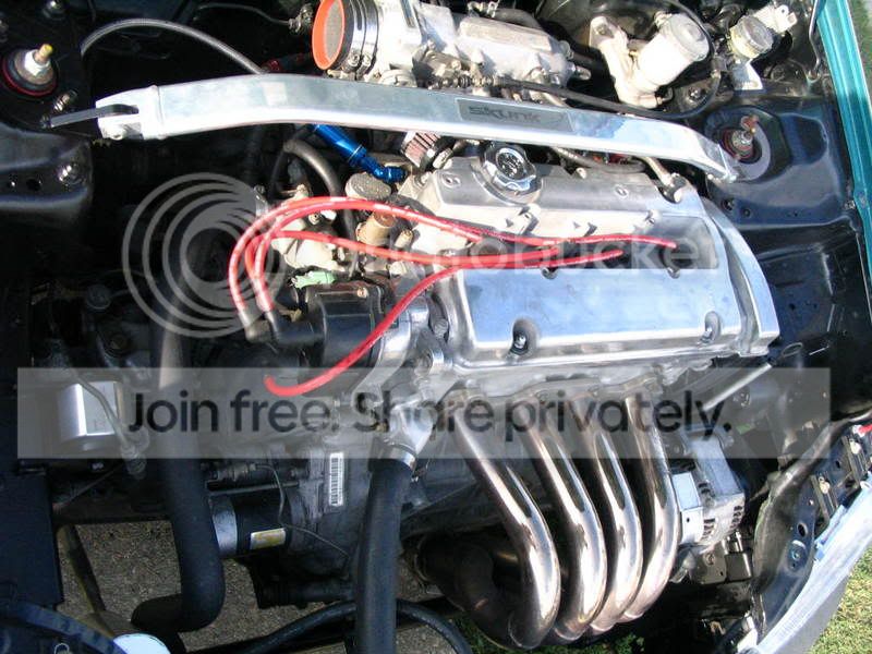

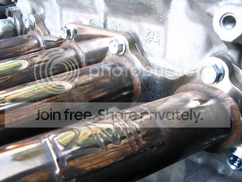

A little quick update---I changed my rusty header studs for some new bolts
and I also extracted a broken bolt from my where my wire cover goes on my valve cover.

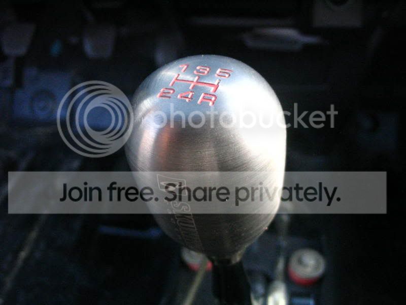

I ordered and polished this...
Thanks for any help and have a great day!!!

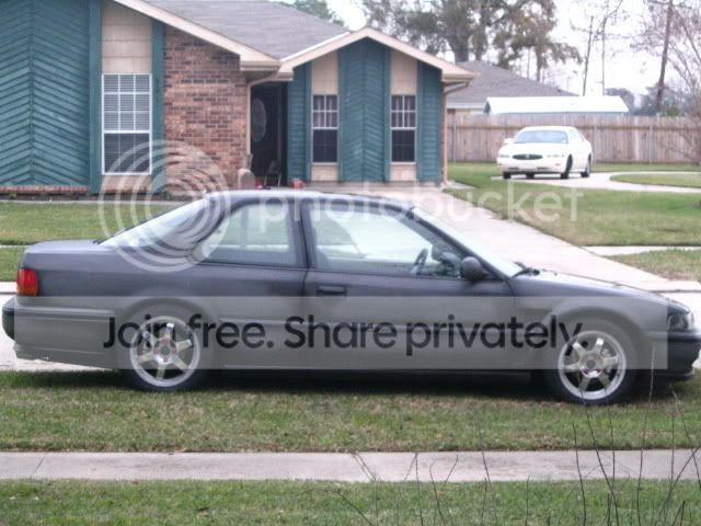

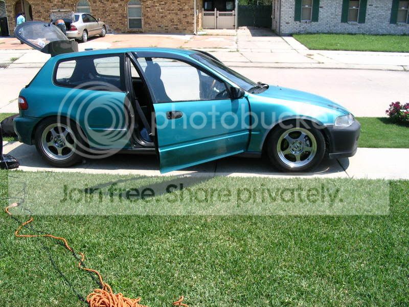

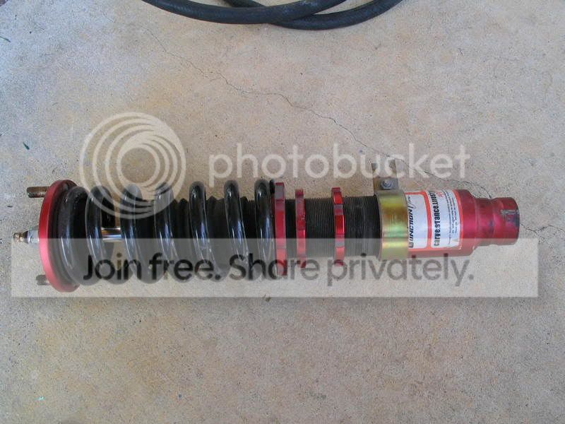

First the good news------ I finally adjusted my Function Form coil overs and ordered new hardware for them( Thank YOU SOOOO much Andrew at F2autolife.com!!!! You the Man!!!!)

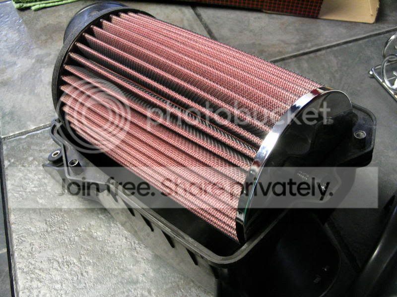

got my ITR intake tube and box. decided on a K&N, because I didn't see spending another $80 more on a Spoon.

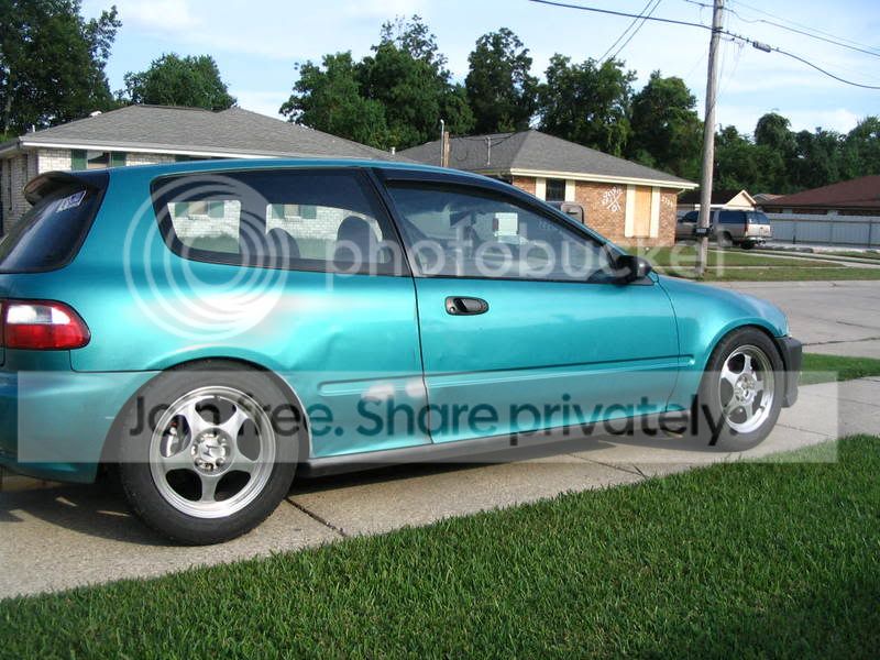

But I lowered it too much in the front. It looked awesome, but my Skunk2 camber kit was hitting the shock tower. I also believe that the axles were hitting the forks. So no pics of that- due to the fact that I would be extremely jealous to look at it.

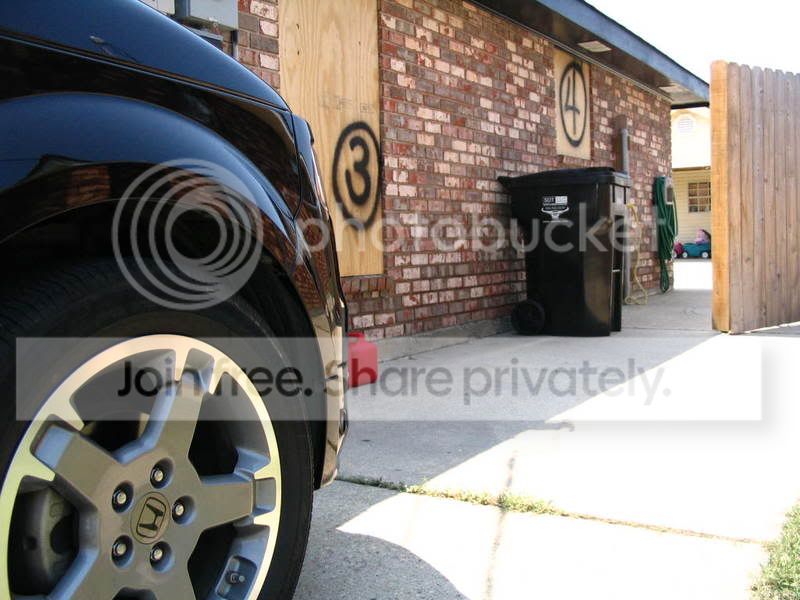

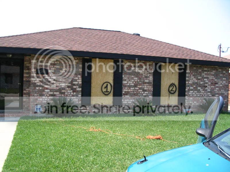

Hurricane Gustav Sucks--- WE have Mandatory evacuation orders for our parish(county). So here goes this headache.
Pics of Us getting ready---
my new stance-- also rolled the fenders
finished my seats

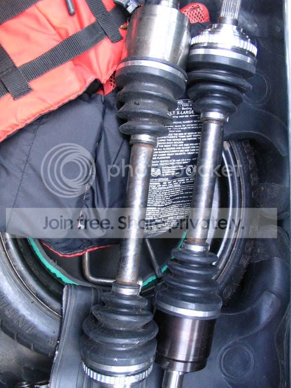

Extra axles--just in case (don't know how I'm gonna get the nuts off w/o a compressor)

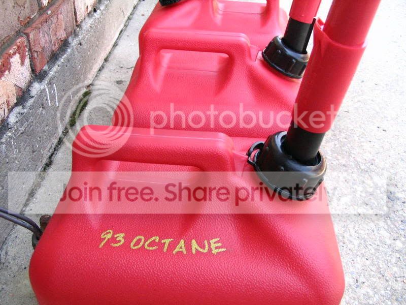

Extra gas-- can you tell witch is for the civic?

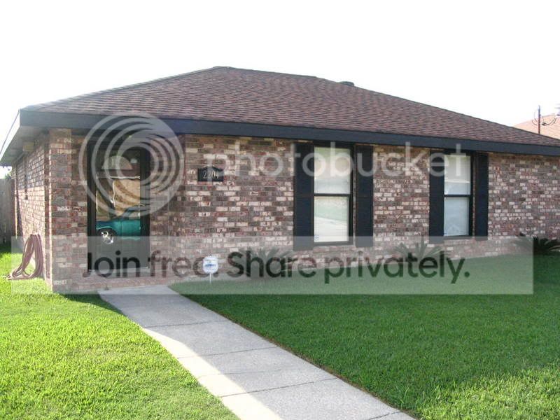

boarding up my house---
