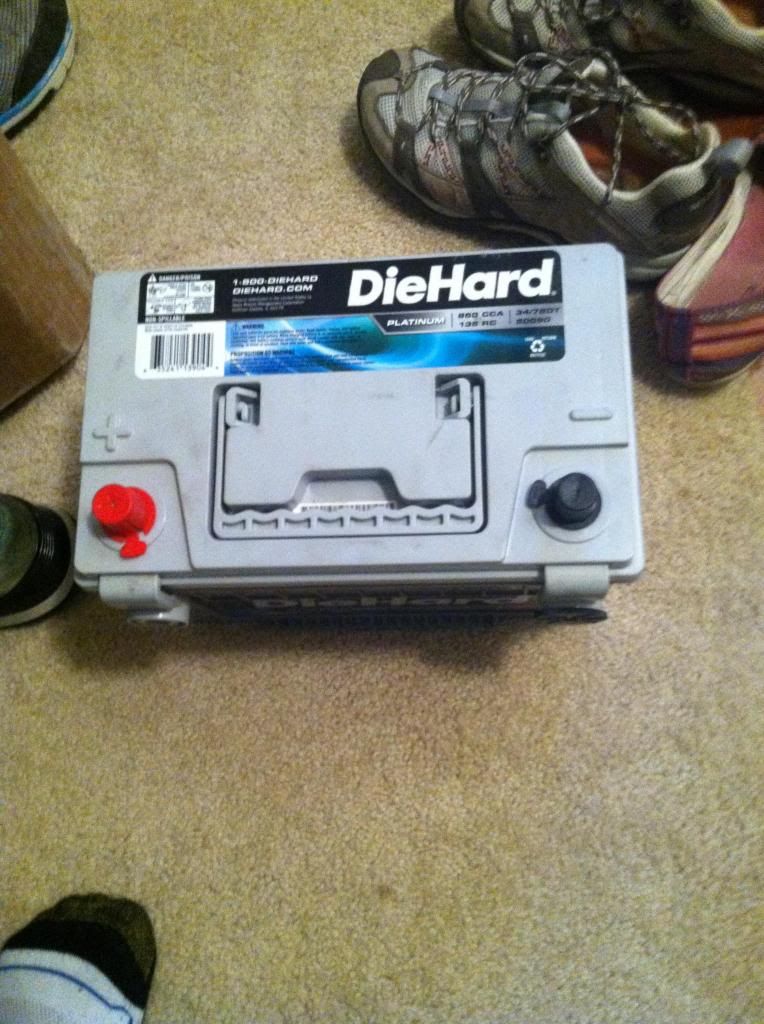

also picked this up today. group 34 platinum. Great battery

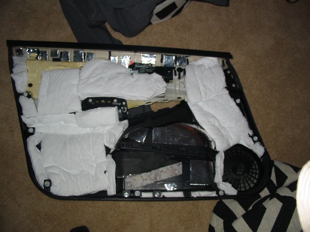

I also did some more sound proofing work to the car on Wed and Thur. Russ was working on his car and helping his daughter with her new car purchase so I was on my own but he was nice enough to let me work at his house and steal his fine silverware while he was out.
Here is the SDS MLV. I was quite surprised with how easy this product is to work with. It is very high quality and Don did his homework with coming up with this vs a standard mlv which ive heard is sometimes difficult.
Started laying stuff out and cutting(razorblade works awesome, was doing all this freehand and my first time)
started to seam it all together. Instead of the vinyl glue he offers, i used a thin, strong ducting tape. I want to be able to remove/adjust if i ever need to, and I already had it. All cuts/seams had pieces to make sure exposed areas were covered.
after this was done, I was definitely interested in seeing if i could notice a difference. I had a few hours labor into it and the cost of the product. I can say with certainty that this is definitely worth doing if you want a quieter ride. I was extremely pleased with the reduction in noise from the rear of the car, and will be doing the whole floorboard once I order more MLV.
Made sure it all buttoned up like stock with all push clips and screw clips in place
And lastly, I stuff the **** out of the doors with 3m Thinsulate Acoustic that SDS sells as well. You simply cut it and apply with hot glue. This is another product I was interested to see the benefits of, and once again I was not disappointed. With the oem SI system, it sounds awesome. No rattles, I get a midbass thump surprisingly, and no buzzing.
The only thing I want to attempt at some point on the doors is a layer of MLV. I spent a couple hours trying to make a piece work but I couldnt quite get it. If i cant get MLV in there, it wont be a huge disappointment, but if I can work on it enough to fit it, then great.

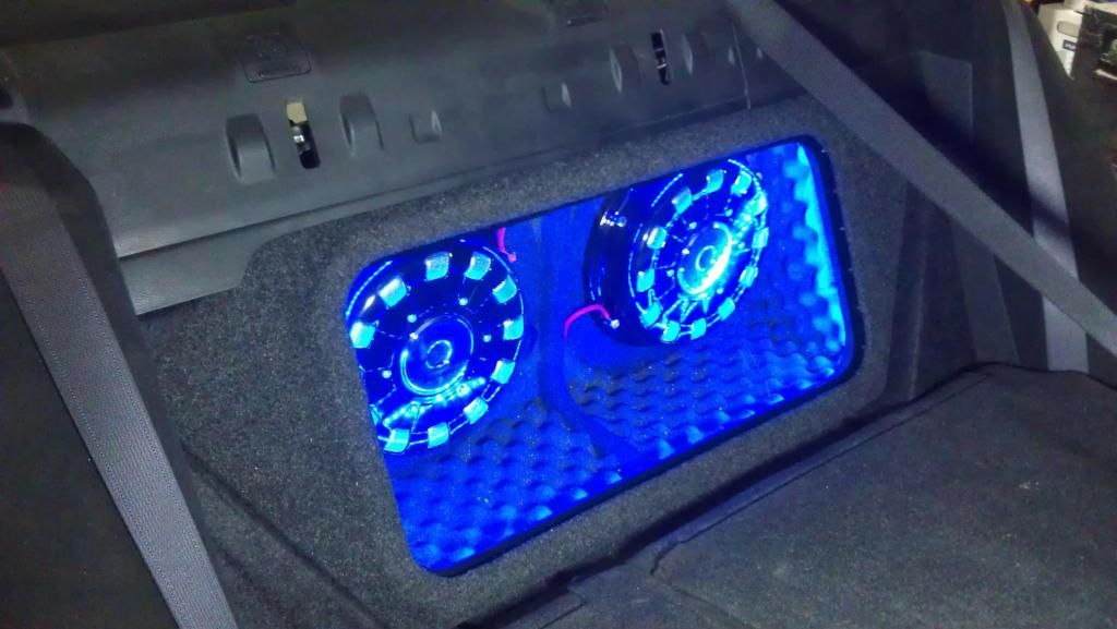

some refinements were done to my doors. the throats from the speaker to the opening were redone and carpeted, the grilles were hand made
the trunk is pretty much wrapped up.
stainless mesh sub cover
fitted
carpeted
3/4" plexi for the sub enclosure window. drilled and countersunk, masked and painted, 36 screws
and illuminated

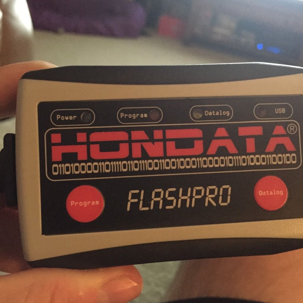

Lastly, I saw a Flashpro come up for sale locally. I was originally just planning to get a reflash at a local Hondata retailer but this ended up being about $100 more. Ive got a stock tune from flashprotuning.com on it right now. It lowers VTEC and should get a little better mpg(to be determined). It definitely smooths out the power band and midrange is improved
