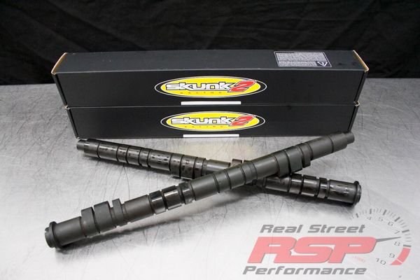

OK i was advised by a skunk2 tech to upgrade my valve train since im boosting this motor with these cams, if the motor was n.a i could still use my stock ITR valve springs and retainers. So I'm ordering a set of skunk2 tuner valve springs and retainers, since i wont be removing the head i will use a special tool to replace the valve train with the head on.
Also the Bisi moto cam gears i ordered gave me trouble upon instal and recently i had a small leak in my cam seals and i couldn't get the cam gears off so i removed the cams since im replacing the valve train anyways so it will have to sit for a few days. I had to press out the cams!, Bisi moto asked i send the gears back so they can inspect them and maybe send me a new set.
So she sits with half the head apart at home while i wait for my new tool and new skunk v.t. heres a vid of the tool i ordered.

so a lil update still haven't got my new springs in, and it seems the tuner series valve springs are discontinued and a new version is out called the alpha valve springs and titanium retainers. Also they have there brand of valve seals that exceed oem specs so ill be replacing the valve seals as well since there gonna be exposed.

Finished up the motor today, its been sitting for 3 weaks with the cams out waiting for the new springs cause they were on back order. man i missed this car! My new sk2 valve seals diddnt come in so i had to skip the new seals because i need to get the car running asap because im moving next weak. heres what i did so far,
Installed Sk2 alpha valve springs and ret.
reset the valve lash now the motor sounds real good.
installed new belt and B20 crank pulley. The sc mounting plate is in the way so i had to grind some area to make it clear the huge B20 crank pulley. If i diddnt mention i installed the new 2.95'' boost pulley. I flushed my trans fluid and toped it offf with fresh honda MTF and flushed my clutch fluid, my clutch fluid was real dirty and so was the res. so i cleaned it up w brake cleaaner and bled my clutch line. I ran the motor but it seemed the first time i over tightened the tentioner for the blower belt.Then i loosened it a bit and now its sounding like crickets so tomarrow when i do my oil change ill tighten the tention a little. Now I should be ready by next weak to go tune the motor. wish me luck.
On a side note the car is a blast to drive. It just feels very strong and has lots of torque in the low end surprisingly, by 3-4k im at 7+psi boost at wot and its taking off! I cant wait to get it tuned, Driving it around like a old man for now even though i can open it up a little i just dont want to hit close to red line and hit full boost because i have no clue how much more boost its pushing now and it sure aint tuned for it. Im guessing im at 14 psi at redline but we will see how close i am.
