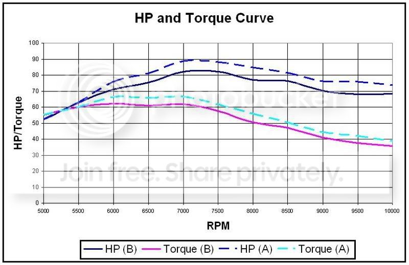

<TABLE WIDTH="90%" CELLSPACING=0 CELLPADDING=0 ALIGN=CENTER><TR><TD>Quote, originally posted by JDMisGOOD &raquo;</TD></TR><TR><TD CLASS="quote">
Pat(lohatch) has some recent 110octane vs e85 dyno comparisons he may want to share.</TD></TR></TABLE>
E-85 is the dashed line
110 VP is the solid line
both run on the same day with the same combo and both corrected. both tuned for the individual fuel. the only thing that may skew the comparison is that i did not try adding in additional ign timing with the 110 because i felt i was already pushing it with the timing. so that may have picked up the 110 some. so take it for what it's worth. i have no biased towards either fuel.
this was on a turbocharged 600cc honda engine through a 19mm restrictor.
i ran it and went 12.009@113 at 13.7:1 static compression this past season and i am going to run ethonal again this season

How could you not be biased after netting a 8-10% gain in both power & torque?
Old 04-19-2007, 10:21 AM
lohatch's Avatar
Join Date: Jan 2003
Location: the backwoods, usa
Posts: 2,841
Default Re: (94eg!)
i'm just saying i had no bias when doing the testing. if the 110 would have won out i would have shared that information as well. i didnt want people to think because i personally run it that i tried to make it look better. somebody else might encounter different results. i just thought it was interesting.

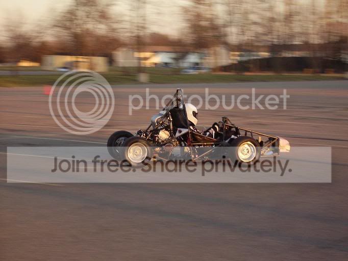

so what is this 600 motor in??????
Old 04-20-2007, 07:15 AM
lohatch's Avatar
Join Date: Jan 2003
Posts: 2,841
Default Re: (nateg)
Old 04-20-2007, 07:52 AM
nateg's Avatar
Join Date: Jul 2005
Location: madison, south dakota, u.s.a.
Posts: 288
Default Re: (lohatch)
SWEET

<TABLE WIDTH="90%" CELLSPACING=0 CELLPADDING=0 ALIGN=CENTER><TR><TD>Quote, originally posted by lohatch &raquo;</TD></TR><TR><TD CLASS="quote"> </TD></TR></TABLE>
I've been wanting to do that with the crappy CX motor I have taking up space in my garage. I just can't figure out how to shift it if the motor is behind me.
Old 04-20-2007, 08:24 AM
lohatch's Avatar
Join Date: Jan 2003
Posts: 2,841
Default Re: (94eg!)
if you really wanted to do something like this i would just watch ebay and pick up a bike engine. that way the tranny is integrated right into the engine and it will be light and compact. pick up a 4stroke motocross engine and put it in a go cart
