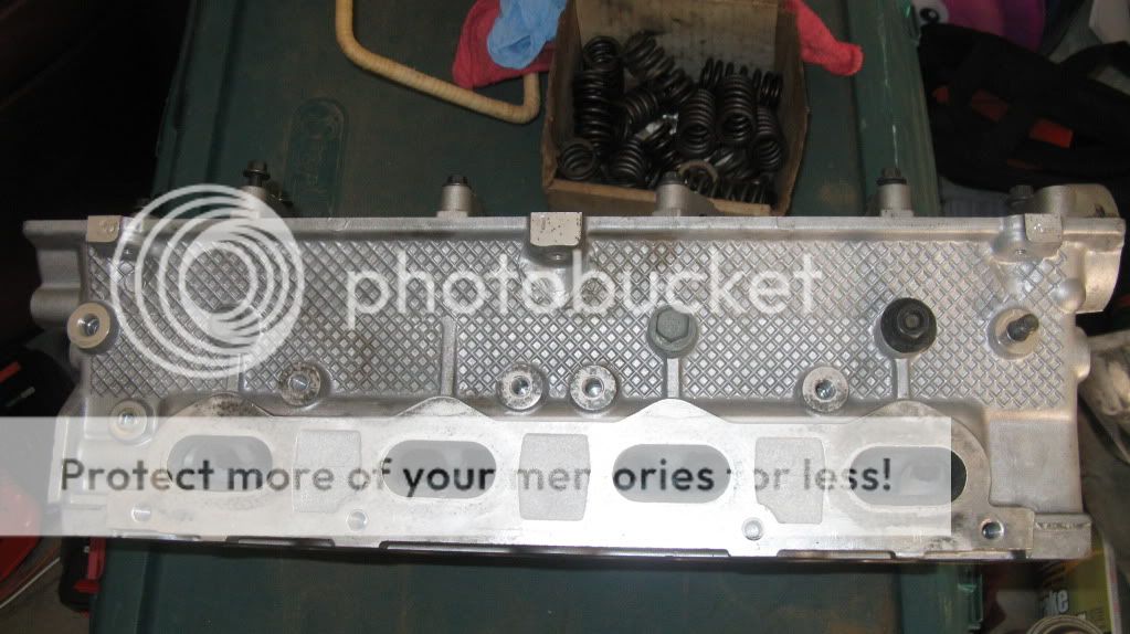

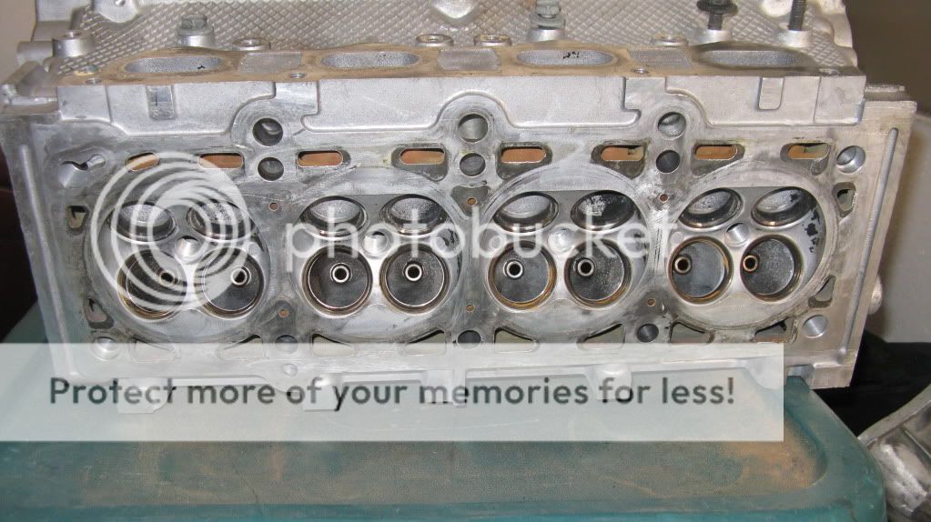

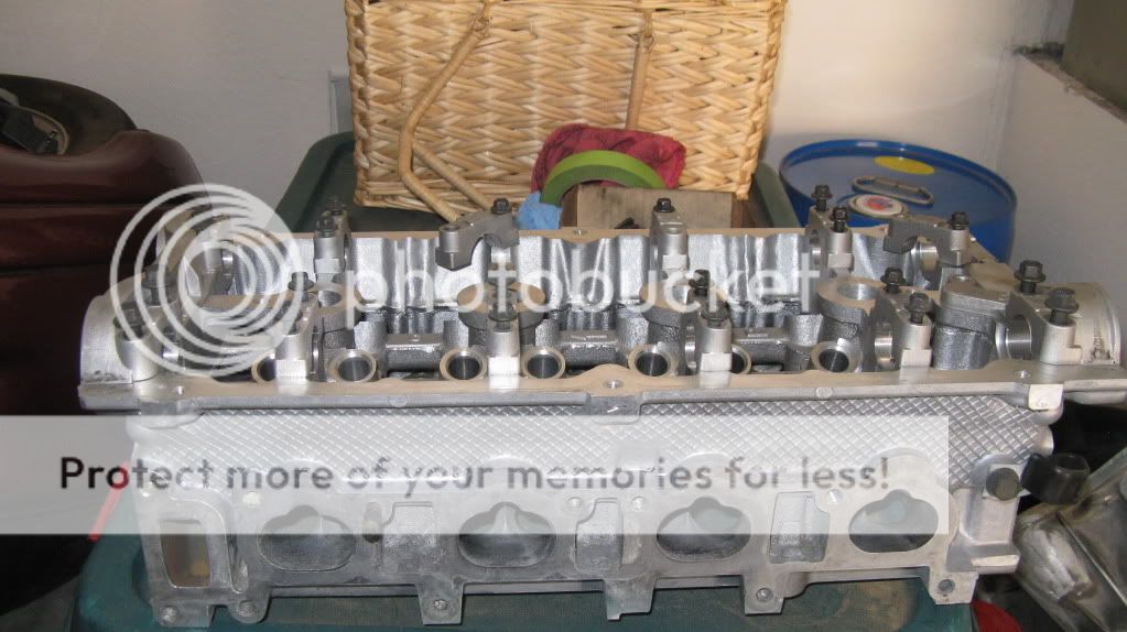

i know u guys just love seeing my other than honda port work so i thought i would throw some more up. this is going on native sons outlaw neon. little story behind this head. so len bought this head used form some guy and contacts me to port it. its already got some port work done to it but he didnt know by who. well i get the head and pull it out of the box and what do u know, its the very first head i ever ported, and had still never been used since i sold it (which was about 5 years ago) and man did it look like **** compared to what my work looks like now. anyways so i went all out on this head. the guides were already cut flush with the port roof cause thats what i did back then and there was so shotty chamber work so i cleaned them up to. well anyways i didnt flow this head but based on what other heads of mine have done i put the numbers on this head at approx 320 cfm on the intake @ .500" and 240 cfm on the exhaust @ .500". hopefully this head will do wonders for him. heres the pics........

heres some stock pics i found........

Did you do a 3-angle valve job? Sorry for noob question I dunno what to look for on the valve to tell if its be done or not. It sure looks reeaall shiny sir, good work.

the valves only get one cut which is the sealing cut and in this case it is 44 degrees, but u can put a back cut on them also to help with flow which these do have so they are cut twice but fyi when somebody says 3 or 5 angle valve job they are referring to the number of cuts on the seat. in this case the seats are 3 angles on both sides.
