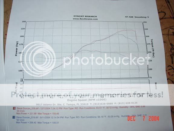

my old setup -
ported B16 head
ported skunk manifold w/70mm t/b
Buddy Club spec 4 cams
headertech header
weisco pistons84.5mm (12.5 to 1)
eagle rods
stock block and crank
12.90's on street tires
The two runs on this DYNO SHEET are the SAME SETUP EXCEPT THE LOW GRAPH IS BC SPEC 3+ AND THE HIGHER IS BC SPEC 4'S
